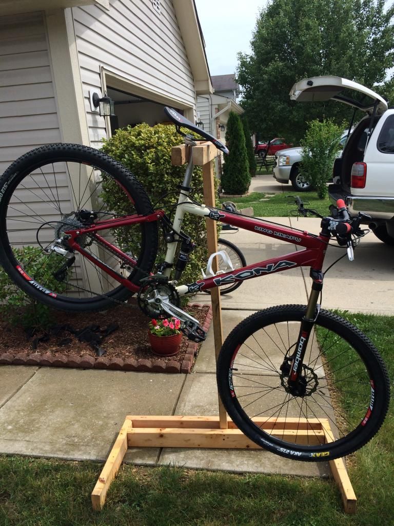

    I made a stand this weekend out of some scrap wood I had around the garage. Hang it by the seatpost, makes it easy to get to everything.

    260
    Quote Originally Posted by Millerad1651 View Post
    Thanks! I'll build a replica tonight. I'll post pics.
