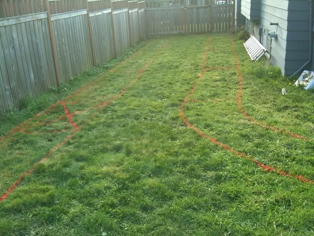

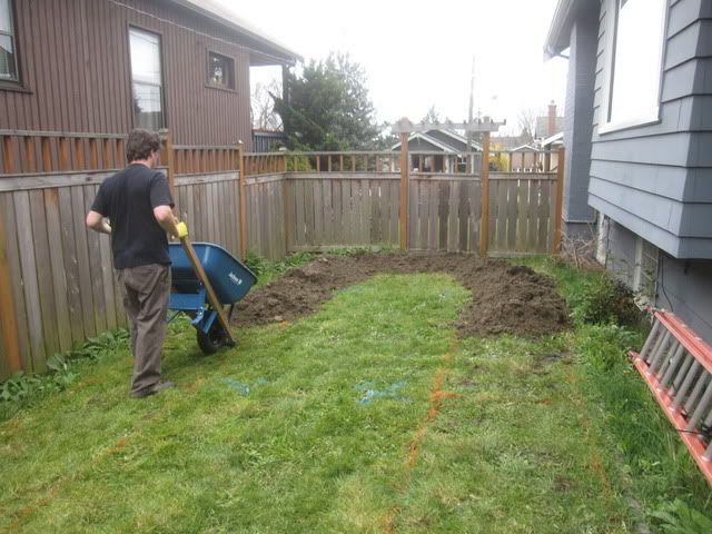

    The first step was to mark up the yard. The shape of our yard naturally suggested the layout, which goes along the perimeter of the available space. The yard is 65' long, 25' wide at the widest point, and 15' wide at the narrowest point. I knew I wanted medium-sized rollers at 10' intervals, so the only big remaining questions were whether to incorporate a table top or step-up, and how much to vary the roller height. I decided a step-up would be fun, and the Shovel Crew convinced me that rollers of varying heights would be best, and they also suggested a crossover from one side of the track to the other that will allow more line options. Here's the marked up yard:

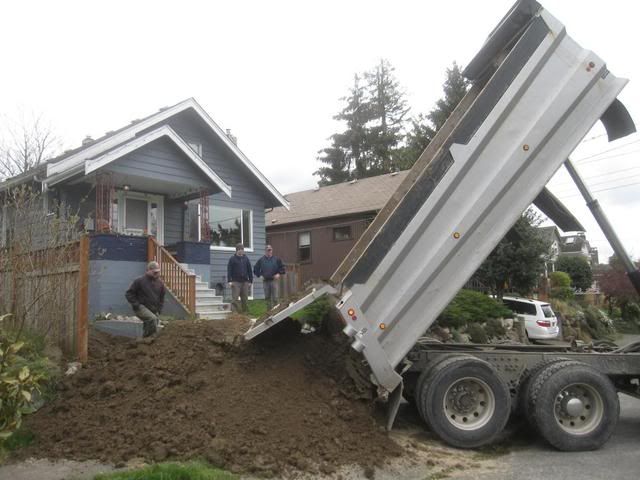

    The next step was to bring in dirt. We wanted the whole track to be above the surface level of our yard for better drainage, since we live in Seattle. My guys were able to find a 50/50 clay/sand dirt mix and we brought in about 28 cubic yards in 2 dump truck loads:

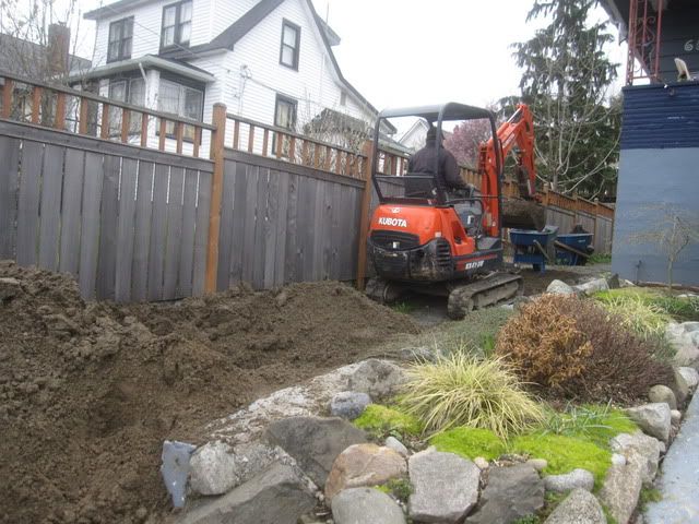

    We're committed now! The next step was to move the dirt from the driveway to the back yard. The mini-excavator had a perfectly sized bucket to fill a wheelbarrow. With 3 guys rolling wheelbarrows back and forth, the dirt started to move pretty quickly. They started by just filling in the outlines with a base of dirt.

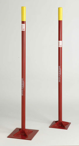

    Cool project, I too started a backyard pump track this year The compactor looks like a good idea, i have been using the stomp method with limited success
    8,156
    Quote Originally Posted by dl1030
    http://www.yardproduct.com/product_i...roducts_id=540
    or
    one of those water-filled rollers helps wonders.

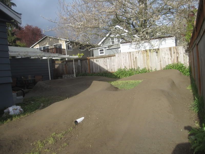

    My guys made some more progress today! Here are a few pics.
    They seem happy as long as they have shovels in their hands:
    Adding more dirt and starting to shape these berms:
    Big progress, very exciting!
    Not sure how a pitchfork got involved.
    Now it's all covered by tarps and we must wait a few days for it to settle and not be rainy. The weather looks good for Friday and Saturday, so it could be rideable this weekend!

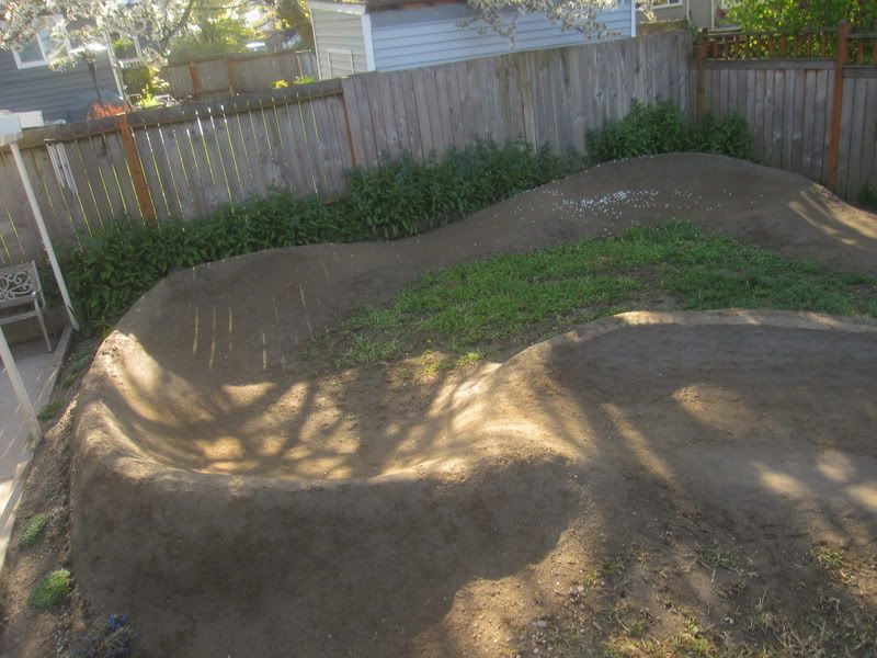

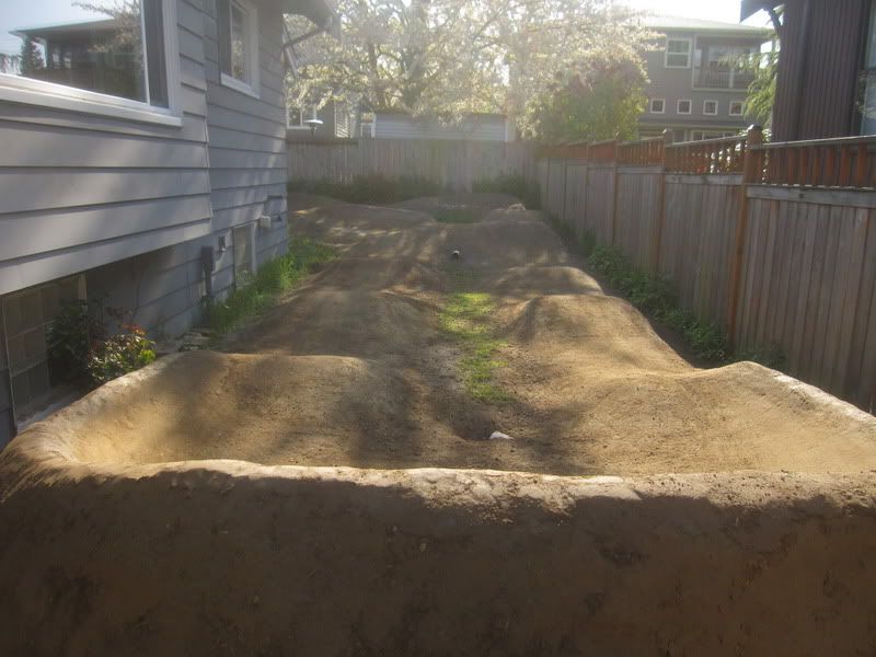

    It's rideable!!! The guys made big progress today and it's practically done! Here are some pics from test riding. Now it just needs to dry out and firm up over the next 5-7 days, then a final day of pimping and it's finished. It's looking awesome, I really like how it turned out!! I find it hard to get around it right now, but it's still pretty soft and should get easier as it firms up. I can't believe I have this in my back yard now when 2 weeks ago it was all grass!

    Thanks for the comments. I've been riding the new pump track a little bit each day for the past few days, although I can't ride it much because it's still soft in a few places, especially the 180 degree berm at the skinny end. The soft spots rob your energy, making it hard to keep up momentum, plus riding on them creates grooves in the track that I then have to stomp down. However, I'm happy to see that it is slowly but surely drying, even though it has been rainy. I keep the whole thing tarped except when the sun comes out. I think it's going to be at least another week until the berm sets up firm.
    The good news is I can now consistently do several laps in either direction without getting hung up. It's really fun and I can tell I'm going to love this thing! And as hard as it may be to believe, I already felt a difference in my trail riding when I did an XC ride over the weekend! I was looser and better able to use my body to put the bike where I wanted and conserve momentum. I was psyched to feel a difference already!
    Drainage: still needs help. There is a drainage pipe running through the 180 berm and next to the step-down thing that turned into a table/double thing. Those aren't really doing anything. My biggest concern is how the track will hold up to rain. I could see the clay dirt soaking up a lot of water and being soft all winter... but I'm hoping that with time and lots of riding and some sun this summer, it will set up hard and concrete-like. We'll see.
    Maintenance: Again, only time will tell how much attention will be needed here. I added some dirt to a couple of places yesterday and it seemed to bond well with the existing dirt, so I think ongoing dirt additions will be possible without too much effort. One of the builders told me I'll probably need to develop a little routine of sweeping it off and watering it before riding it each day. Hopefully the berms will hold up over time.
    Poison ivy at the edges: LOL. There's already a fence, a house, concrete stairs, and numerous rakes and shovels littering the edges, so a certain level of skill is already called for! Of the 5 people who have ridden it, 4 of them have crashed so far.
    Plate compactor: Interesting concept about how it is supposed to just travel along by itself. It seemed more like it wanted to travel DOWNWARD if it wasn't pulled along! Like it would dig itself a hole to China if left unattended! Regardless, it saved a ton of work.
    Launch ramp: I wish we had room! But we really don't. It's OK though, once you get going you're good. I'll just think of the lack of a lanch ramp as a skill builder.
    Still to come: a little bit more shaping work -- the berms could be taller, or at least extended along the edges so you can maintain a high line all the way through. And some of the rollers would be better if they were more like a sine wave. The guys are back for a few hours today, then maybe another half day next week. Then eventually we have to figure out what to do about landscaping, which will be a whole other project of sorts. I'll post more pics as it gets finished.

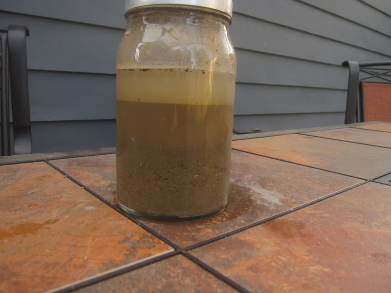

    For trails you will use road mix as it bonds together via clays and such better and will of course stay compact for far longer than regular dirt. For water grade your slope (left to right or what have you) at least 1 percent to allow water to run off.
    Reputation: Blurr's Avatar
    Dec 2009
    2,335
    doublt post
    Reputation: A girl from Seattle's Avatar
    371
    What does this road mix consist of? I'm guessing my mix is 50/50 clay/sand or 60/40 clay/sand, screened to 1/4" minus. How does this compare to road mix?

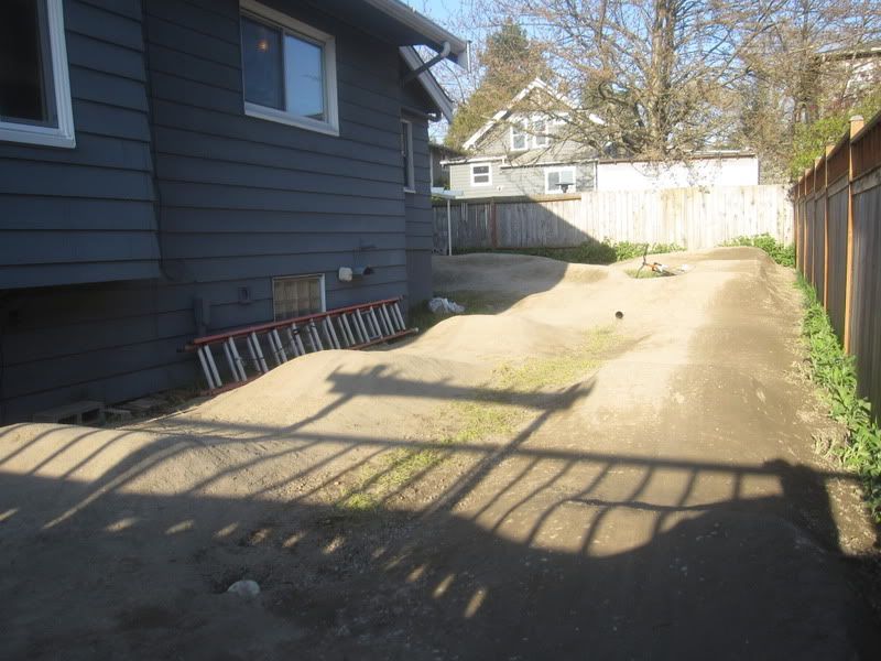

    The track is pimpy now! The guys made rollers bigger and more sine wavy, the berms taller, and it's just killer now. Here are some pics from last night, and a video. The one 180 berm still needs to firm up a bit, but other than that it's running just about perfect.

    Thanks everyone! There is a video at the end of post #55 and I will try to get another one soon! The problem we've been having here in Seattle is that it's been raining almost nonstop for a couple of weeks now. We did get a couple of good dry days and the track dried out like concrete as we'd hoped, if you can tell in this pic:
    After that I felt I could get away with taking the tarps off, so I did. But I was awfully nervous when it rained hard today, wondering what I would come home to! Here is what I found:
    It's perfect! The rain actually helped its condition, erasing some of the cracks and beat-down appearance. Most importantly, it didn't get soft or slippery, which is what I was worried about. So I'm pretty happy about the whole thing. The guys are going to come back one more time to put a layer of dirt over everything, and then maintenance should be pretty straightforward from there on out.
    I learned you can do a test to find your soil composition. Soil is composed of sand, silt, and clay (with possible organic material as well). To find out how much of each you have, you put soil and water in a jar, shake it, and let it sit for a day or two. When it settles, the bigger/heavier sand particles are on the bottom, the silt is in the middle, and the clay is on top. Here is what mine looks like:
    In this pic, the top layer is water, then clay, then sand at the bottom. So our soil appears to be about 65-70% sand and only 30-35% clay. I would have guessed the opposite since it seems like there is a ton of clay in it! No silt or organic material that I can see. Very interesting (to me at least, but I'm nerdy). I guess a little clay goes a long way! I think our dirt is pretty perfect for our application.

    OK, here's a better video now that it's running faster:
    http://s204.photobucket.com/albums/b...t=MVI_1751.mp4
    And some photos of the new and improved track. Berms have been getting bigger!

    The main thing I would change is to make the berms bigger right from the start. Getting them to the height I want is going to take some work at this point. Drainage is a concern too, but not as much as I thought it would be. It seems like if you get the right dirt and pack it hard, the track can take a lot of rain, as last weekend proved. We got almost 2" of rain in 2 days, and I only waited an hour or two after it finally stopped raining and was able to ride the track no problem! Puddles do form in the low spots, but somehow they get absorbed pretty quickly and the track has stayed hard. It would be a good idea to make sure every surface on your track is sloped very slightly inward or outward though. It hardly takes any slope to keep puddles from forming. I'll probably be adding some slope in a couple of places.
    Other than that, I can't think of anything I would change, except maybe to buy a house with a bigger yard! Good luck and let us know how it goes!

    Thanks for the recent comments everyone! A couple of people have asked for an update, but there isn't too much new to report at the moment. Maintenance has continued to be very easy, I get the occasional weeds and grass trying to grow up through the track but I either pick them or spray them every 2-3 weeks (takes like 10 minutes for the whole track) and that keeps them under control. The track remains hard and concrete-like with no obvious signs of deterioration, though it does get dusty and slippery in the summer if I don't water it from time to time.
    Next step: make the berms bigger and maybe introduce a slight slant to the inside all the way around the track to facilitate drainage and help reduce "flinging off into the fence" incidents. I hope to get to that sometime this winter.
