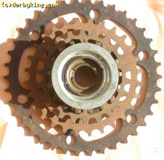

    Actually they were... in the 80s Suntour had 6 speed freewheels with 36 and 38T granny cogs. Shimano's 7 speed HG cassette offerings in the early 90s included a 13-34 even up to the Deore XT HG90 level. The first 8speed XTR came two ways... 12-28 and 12-32... really... the 34T largest cog we've had the past few years on 9 speed cassettes is just a return to what we had on seven speeds... and the new 36s are just what we used to use withsix speeds.

    Compact Drive cranksets. The old 6-speed cassettes were NEVER matched to a 20T chainring. I forget what the smallest chainring was (24 maybe?), but the final gearing of a 6-speed was still higher than a "modern" drivetrain.
    6-speeds are making a comeback, though. Like the modified one from Jeff Jones at the bottom of the page...
