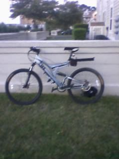

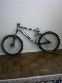

    it came
    im so excited it cametoday. i only have a cell phone pic right now but im loving the new look.
    ok i went from this:
    to this:
    i am very pleased with the new look and cant wait to ride it but ive got to pay my dad back a little more and need to buy some parts.
    also my seat post fits from my db on the fuji frame so somewhere the info in incorect
