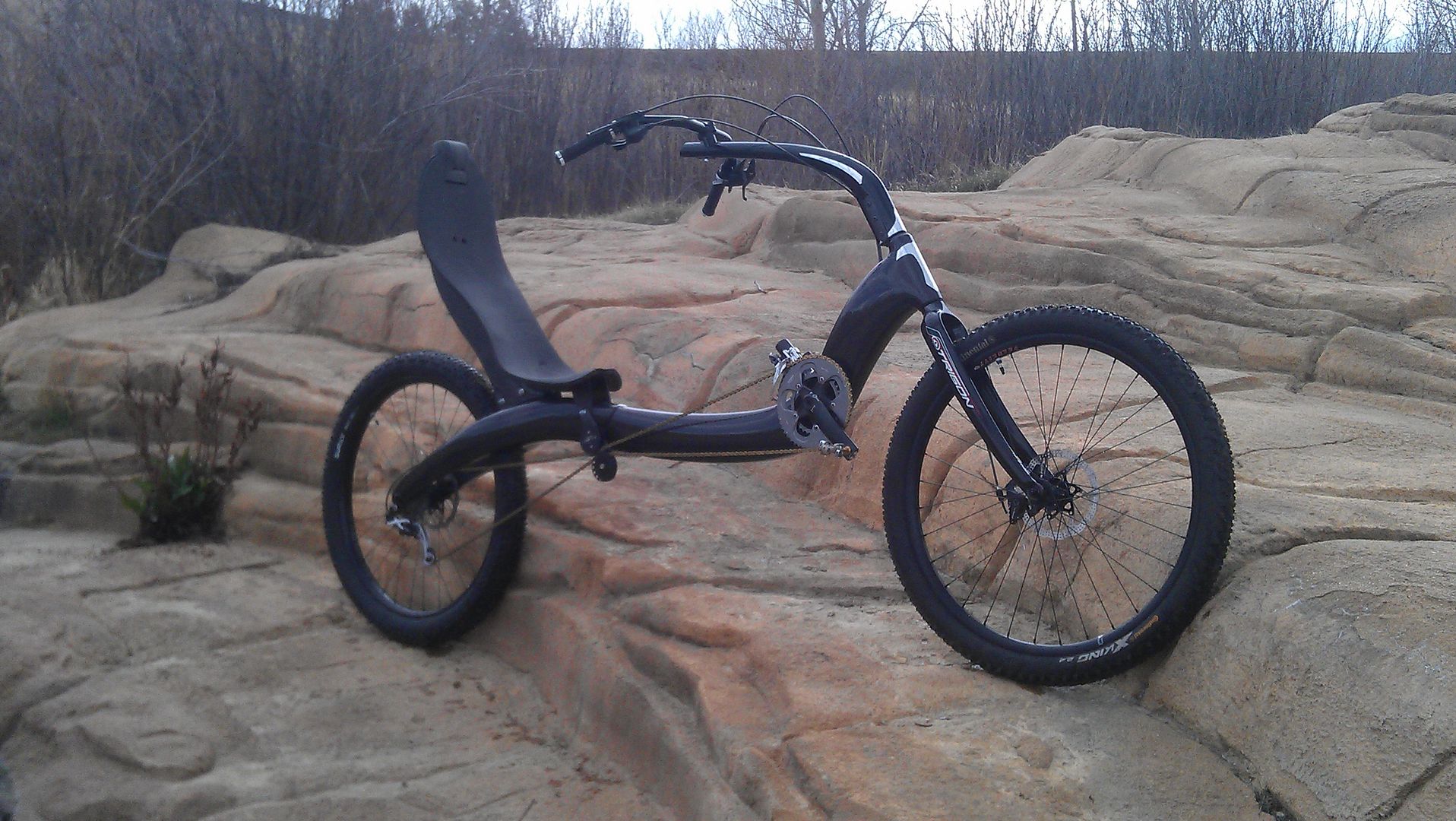

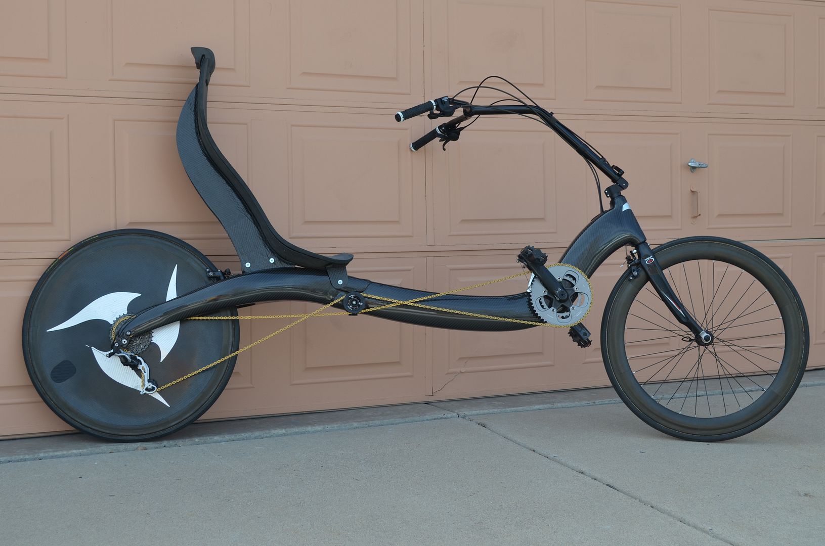

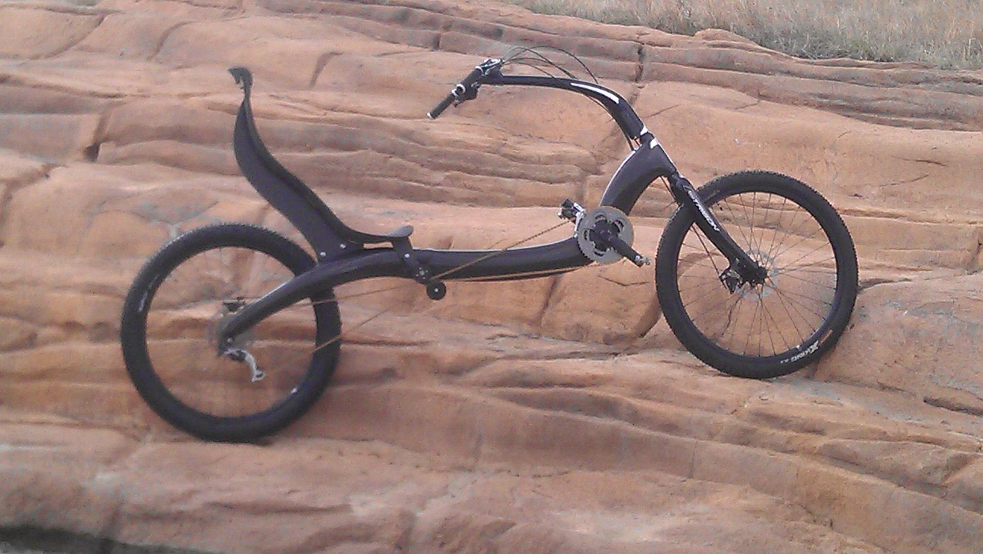

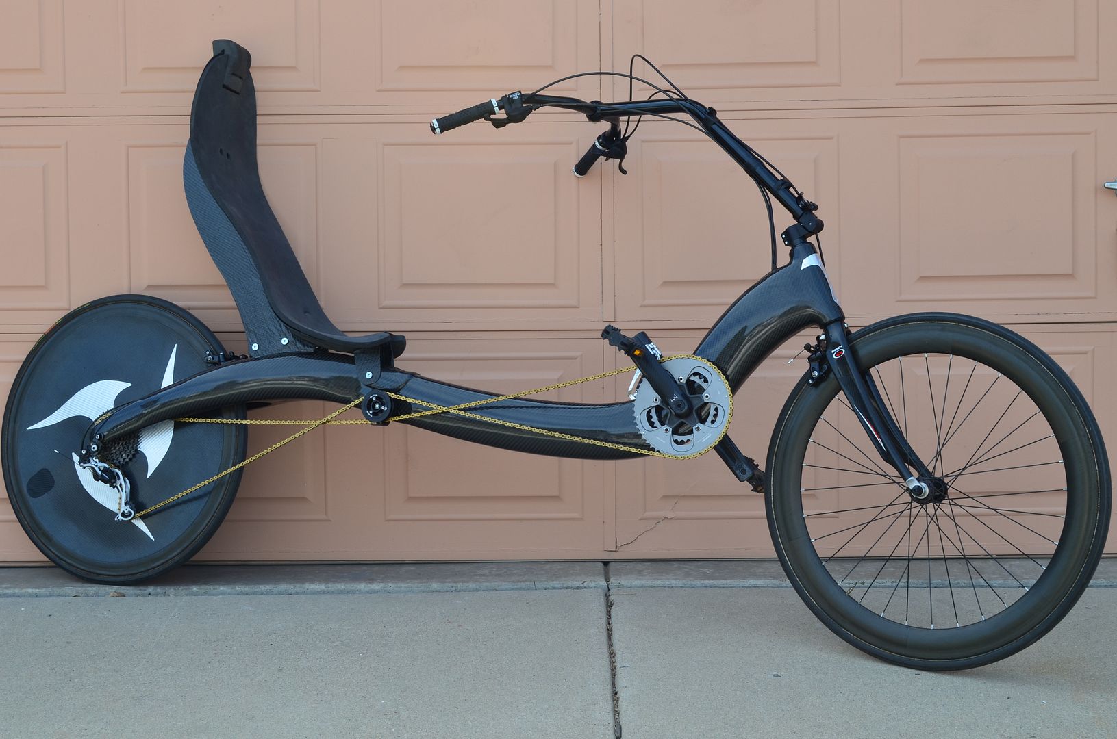

    This is mine handmade frame. Enjoy...
    P.S.: Sorry for damaged CarbonMike stickers on frame. Photo taken after several years of use and crashes.

    That is impressive. Home made autoclave for curing?

    No, just wet layup. Each layer compacted with rubber electrical tape (sticky side up). Tape was perforated with needle so excessive resin can flow out. Tons of flat sanding, clear epoxy coats, sanding, sanding sanding.

    JohnnyMagic
    KODIAK LWB;
    26lbs. with the road wheels 650g. platforms and a 530g Terra-cycle/Rans stem and riser
    off-road version (original intent, commission)
    Velocity Dually rear wheel, W/Knard 29+, Blunt 35 front W/2.4 Conti X-trail
    200g pedals and the new stem weights 275g's (but forgot to add the 3 fixing bolts)
    JM
