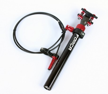

    MiWi, off topic: what remote telescoping seatpost is that?

    That is a Forca SPS400 (4.1/2" drop in 2 steps, cheap and mechanic).
    I have a 30.0mm seattube and Iīm planning to use a 30.0mm Gravity Dropper Turbo LP (as far as I know the only 30.0mm dropperpost). But as this is my first MTB and Iīve never ridden a dropperpost, I decided to try the cheap Forca 27.2mm (with shim) first. By now the Forca does what itīs supposed to and I really have no claims. Quite a bargain for 90 Euro (120$) imho.
    I think it is sold under a different brandname, too. But I canīt remember.
