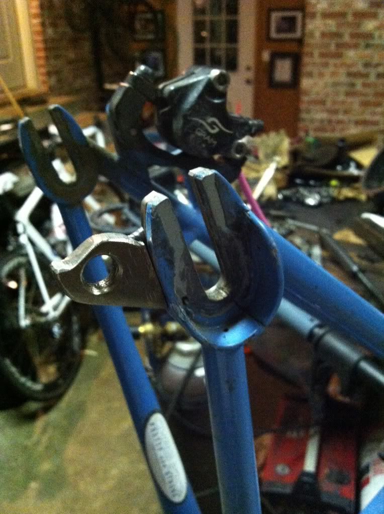

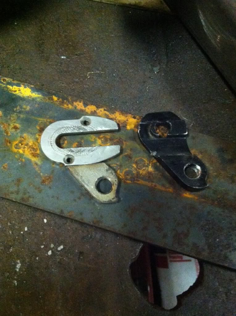

    So I went ahead and gave the backing plate hanger a try myself... Had some 1/4" stainless flat bar so I used the problem solver hanger as a template:
    Beveled the edges a little and got a decent partial penetration weld to join the two. Here it is mounted up:
    Got the bike put back together and I'll give it a try tomorrow.

    Cool, let us know how it works. I'm not sure if it will be rigid enough but it may be.

    I went by the LBS and used the hanger alignment tool to get it straightened out. I have to admit that I was a little worried when I started bending the hanger haha. Rode about 14 miles at the local trails and the 1x10 setup performed wonderfully. The only trouble I had was the quick release axle sliding forward on the drive side when I stand up and really wrench the pedals. I'm going to try some chain tensioners, but may end up just tacking a small washer on both sides... or even a half washer to act as a front stop so I can still pull the wheel out without removing the skewer.
