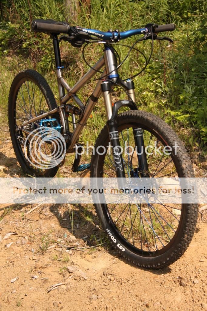

    Basically my gf had just gotten into mountain biking, she loves it and I personally just dropped off DH for more of an All-Mountain type of riding. So we talked and came to the conclusion that what we needed was a double suspension enduro/all mountain frame that tends to be more on the cross country side. So a 4ish" x 4ish" upgradeable to 5" in the front if needed.
    So here's what they'll look like :
    Building 2 enduro/cc steel frames-fyah6_zpsef25a488.jpeg

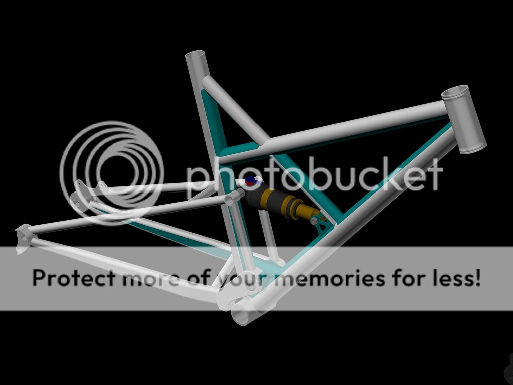

    Here's a 2d of the design followed by the goemetry.

    That toptube can no way, no how handle what you want to do with it - you'll be welding your crossbrace through the thin section of the tube. Go for supertherm or straightgauge.
    IMO for aggro riding the .035 downtube won't be able to handle mounting a pivot like that, I would go with something beefier (Supertherm!) or find a way to completely capture the pivot with the tube.
    I would bump up the chainstays in size as well - 5/8" square is not going to be very stiff and will be super heavy. Round tube is your best bet for strength/weight.

    Good effort, but it's just a single pivot. Why make the rear end so flimsy, comples, and expensive when you could just weld it together properly?
    WIGGLER
    Reputation: todwil's Avatar
    Feb 2007
    937
    Looks good the only thing I would add is gusseting from the pivot to the ST to take advantage of that triangle intersection spreading the load out!!!

    Hey;
    It seems to me that if you did a little rejiggering of things, you could nest that pivot housing in BOTH the DT and ST and alleviate any possible overloading from only using the DT. I also sort of agree with PVD that the rear triangle is potentially needlessly complex with the alloy rocker plates instead of a welded connecting member and longer stays-to-pivot, but with perhaps a different or additional reason. I wondered if 3/8 thickness would give you sufficient lateral stiffness within just the rocker itself?

    I'll add my agreement with TM on the shifting the pivot if possible to nestle between the ST and DT. I admit that I am more a structure person than a Suspension type, but I see the better design path you've used to the rear axle path being true vertical and in the more complex way of acheiving that goal. The Mono Shock style brings the rear wheel into conflict with the seat tube at full compression, so I see your thinking here.
    This needs a more expert over-view by a more experienced person to comment and I hope someone will on the merits of the lateral stiffness.

    I gotta agree with you guys. I'll go back to the drawing board and work on the rear triangle for a bit. I'll see if I could also relocate the pivot backwards a few thousands but doing so means I also have to relocate the shock mount, this may interfere with the downtube or seattube...

    Why have the extra tube bisecting the toptube?
    The Santa Cruz Heckler has always been a great riding bike. I'd look at modelling things off the Heckler with your updates to geometry and custom sizing.
    Moderator Moderator
    Reputation: Walt's Avatar
    6,850
    I'll second that. If you want to build a high single pivot just copy what Santa Cruz has done with whatever geometry tweaks you want.
    -Walt
    1,787
    Moving the pivot forward would solve a couple issues. The Santa Cruz pivot is fully in the downtube.

    -If you do stick with this general design, I don't see why you wouldn't just use off the shelf seatstays and chainstays rather than 4130.
    -If you want to capture more of the pivot between the ST and DT but not move the pivot, you could offset either or both. And/or use a 1.75" Supertherm DT.
    -I don't see this design as needlessly complex for a home builder. Those Al plates would be much heavier made out of steel and if you were to use tubular steel it would be much more complicated. Also, the pivot location seems to be pretty far back compared to a Heckler, so that might be what he's going for.

    Best to desgn around a mid-stroke shock so the damping is in the ballpark. It should give you tuning range as well.
    Reputation: Eric Malcolm's Avatar
    Dec 2011
    1,070
    Hey, thanks for the drawing and preserving the rear wheel movement.
    You may have to design the chainstays to be the same both sides, rather than having a direct to pivot route on the NDS.
    Seat stays in the single taper 17-19mm range will be fine.
    One bearing each side is fine, my bearing supplier suggests tapered bearings, but they are so big and heavy. In a pure load sense, he is probably right, but we don't have a motor to help us get down or up the road...
    Have fun
    Eric

    Thats pretty high leverage by todays standards, might have some trouble with shock tuning? Less leverage would reduce some stresses in the frame too.
    Leverage ratio is 3.41 to 1 on my frame (17.25" chainstays) and 3.37 to 1 on the gf's frame (16.75" chainstays). Using a 1.5" stroke shock instead of a 1.25" to get the same rear wheel travel would get the ratio down to 2.86/2.78 to 1.
    Personally I don't think it's completely out of the ballpark... but I'll think about it over the week-end...
    Shock mount tab on top tube, could only be possible if I was to relocate the pivot forward and up (like most Xprezos, SC Heckler, etc...) With the pivot location I've got now, I can't. Everything else results from this particular location.

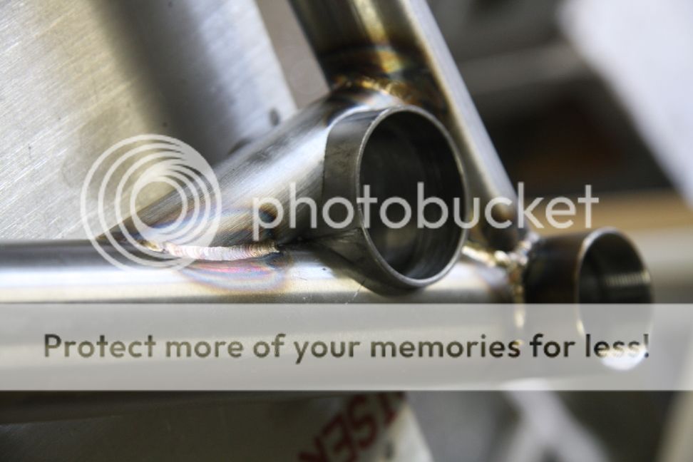

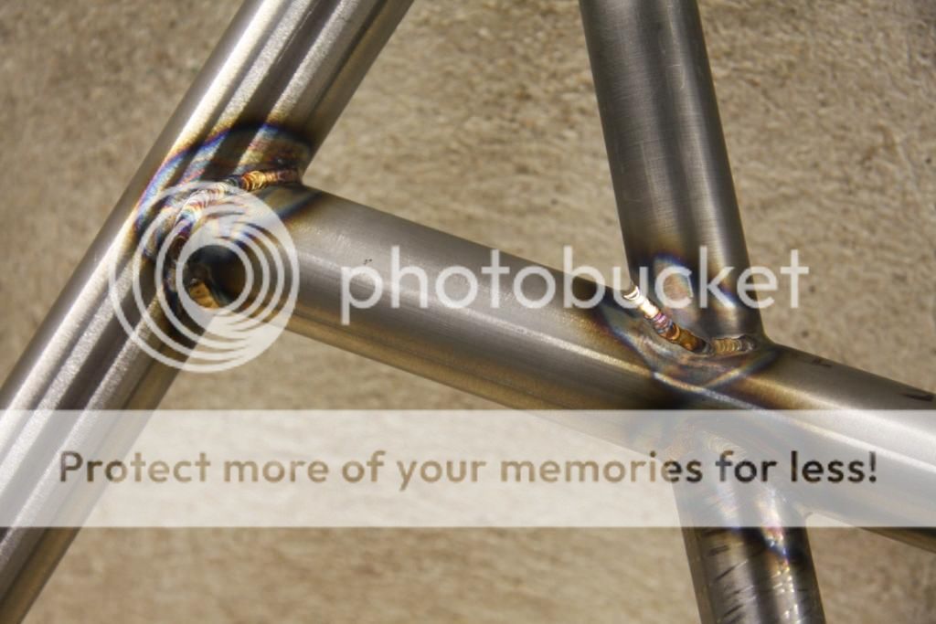

    The 1-3/8" True temper seat tubes showed up and man are they ever HEAVY... duty. So, wanting to keep the weight down a bit I decided to use the reynolds 853 seat tube that's 1-1/4" x 1.2 x .06 x .09
    Since this seat tube won't be used I decided to salvage it into something useful and give it a try. First time with welding bike specific steel tubing and first time with weldmold 880 rod (buddy of mine was welding the bikes I was designing before). Did lots of .035" 4130 last winter with acceptable results.

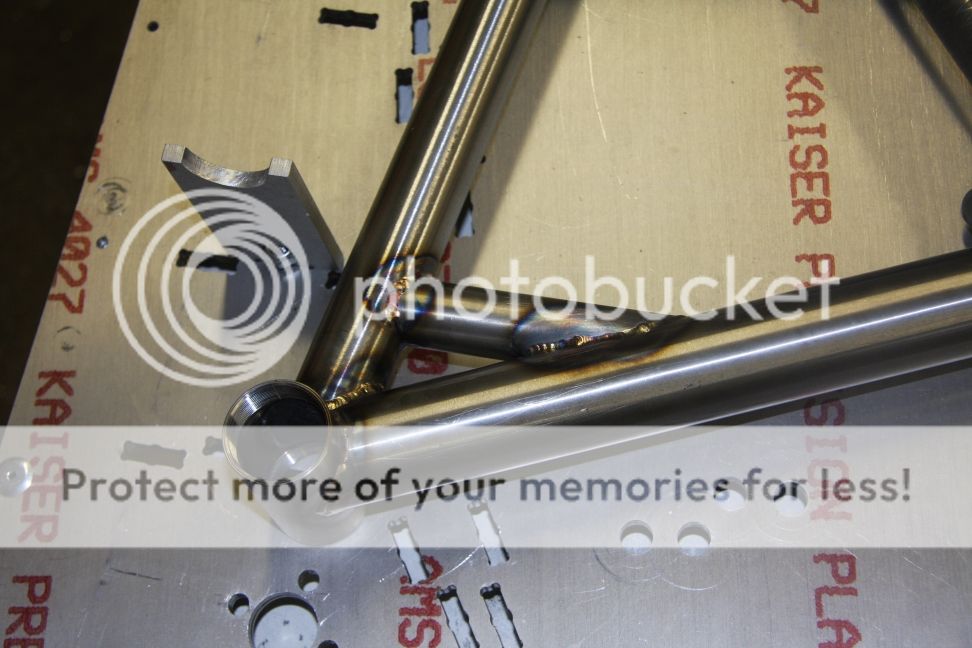

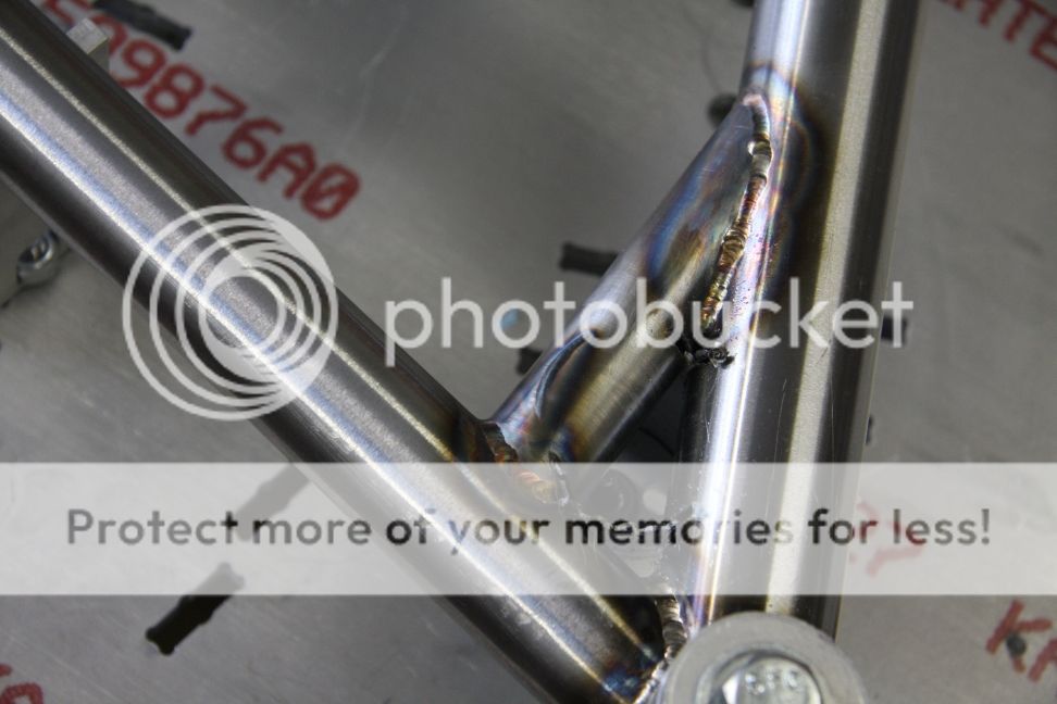

    Today I had a "rage" to weld, I'm sure some of you guys understand what that is, eh. You go from being perfectly fine besides maybe having to take a piss, and then all of a sudden, you'd just want to be behind your helmet and lay beads... Anyhows, I decided to wack off a little test frame real quick off of that seat tube to try to reproduce some of the joints I'll have to weld on the bikes. Here's the "finished" product.
    Building 2 enduro/cc steel frames-img_5785r_zpse2ec771a.jpg
    All 1-3/8" tubing except the little cross tube which is 1"x .035" 4130
    BB is 1.6mm thick (thick sectin of the butted seat tube)
    HT, ST and "DT" (or is it a TT???) are 0.8mm thick
    The trained eye will see a huge pin hole on the DT/ST juntion. That's what happens when you forget to drill a vent hole...
    Building 2 enduro/cc steel frames-img_5774r_zps69bcd8e0.jpg

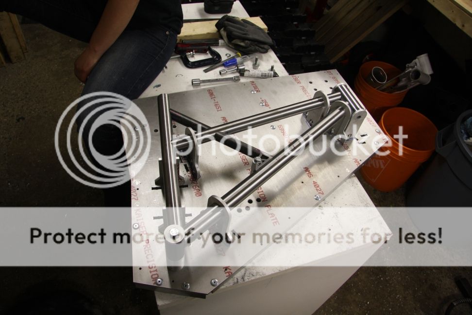

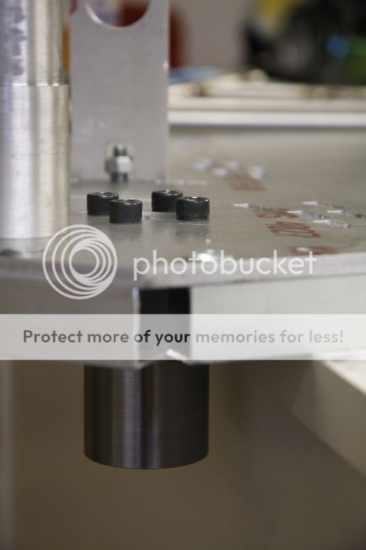

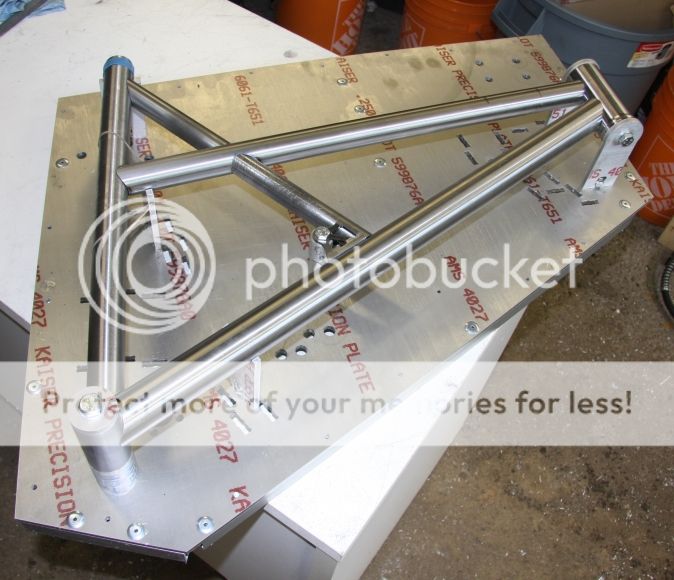

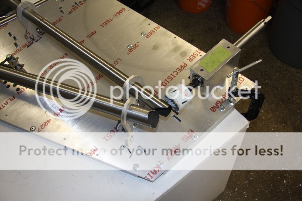

    Here are the custom jigs I made for the frames. In the back there's the rear end's jig and that big plate is the front triangle's jig. I'm trying something new here which is using the jig as a notching jig as well. It will be very useful for the other stuff I manufacture (not bike related).
    Rear end jig allows me to precisely locate all the key points. I also had holes cut out to fit a BB shell in there to screw in my crank to validate clearance.
    Fast forward to the head tube notch in the DT and TT. Don't ask me why the rough cut on the DT is that off OK !!!!!!! Lucky on this one I had enough meat !!!
    Worked great, tube clamping system is stiff enough, no aligning, no measuring no f'ing around whatsoever besides aligning the butts where you want which can be eyeballed if marked.

    Managed to finish 96% my front triangle...

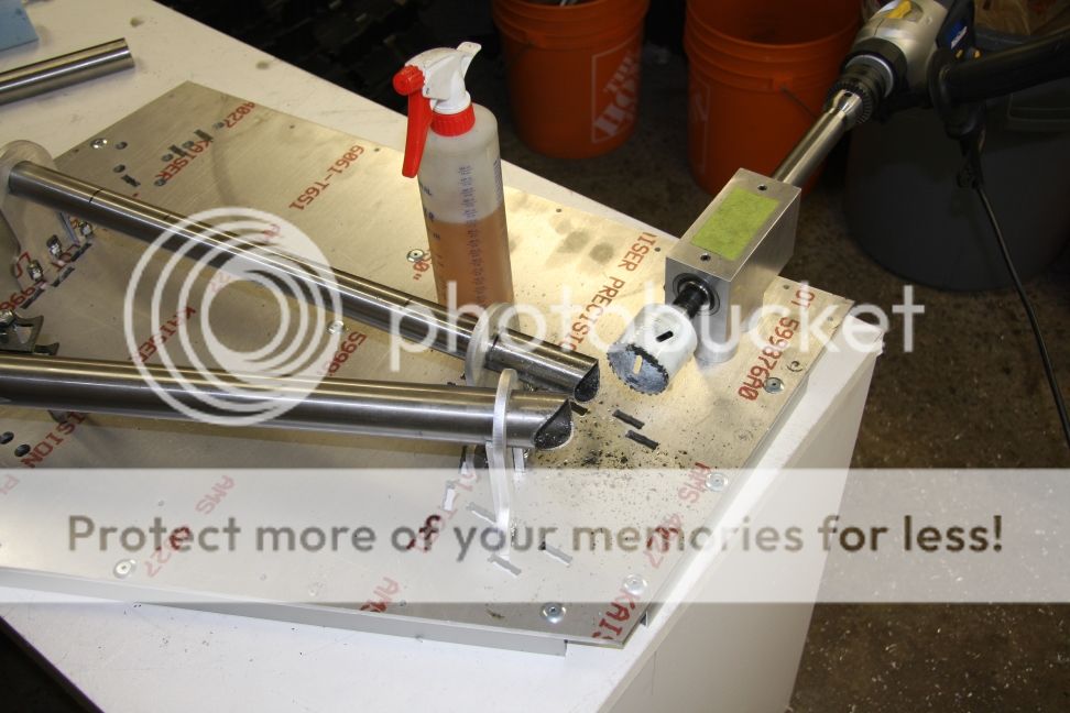

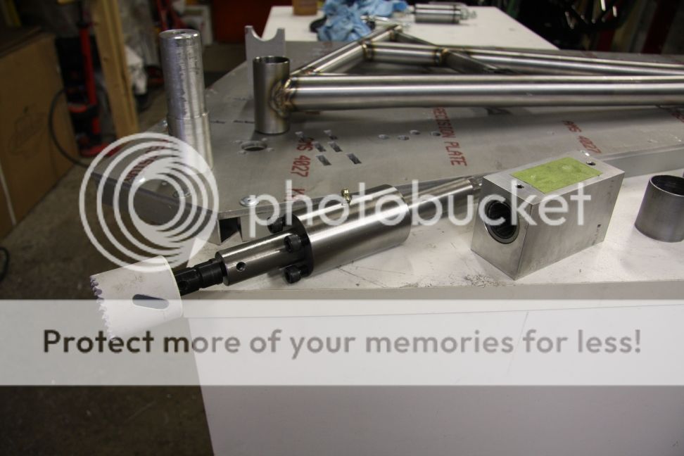

    welded the 1" x .028" reinforcing tube on the DT / ST junction for the main pivot tube.

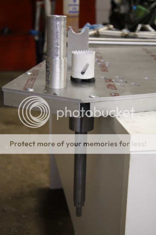

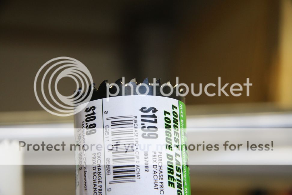

    Then got the big arsenal out. My new, fresh out of the oven, perpendicular-to-a-plate notching device which consist of a steel sleeve at 0.001" overbore to allow my swag off road super shaft to slide thru and notch some tubes !
    Milwaukee holesaw dead in its hole. Was brand new, I burnt it ! Never had good luck with Milwaukee holesaws in cromoly steel... or TT Supertherm !!! Pretty sure they'd work very well in wood... or even butter... soft butter...
    Had to wait 'til the next morning to go thru 3 hardware stores to finally end up on these. Exchange-a-blade M42 Cobalt hole saws, the black ones (not the white or yellow) Guy said the rep said they can't be beat. (Products | Exchange A-Blade) Plus when you buy one you can bring your old one and pay for that lower price ! Tree hugger in me says "awesome". Tooth design seem pretty intricate compared to the others I have (Sandvik, Bahco, Lennox, Megacut, Metabo, Starett dual pitch (dual pitch don't work worth a s..t). Got a good feeling, we'll see how this one holds up.
    Plus they seem to cut pretty smooth.
    Pivot tube in.

    Allowed me to finish what I had started on the rear end :
    Checked the crank clearance, plenty.
    View from the back of the rear end's jig.

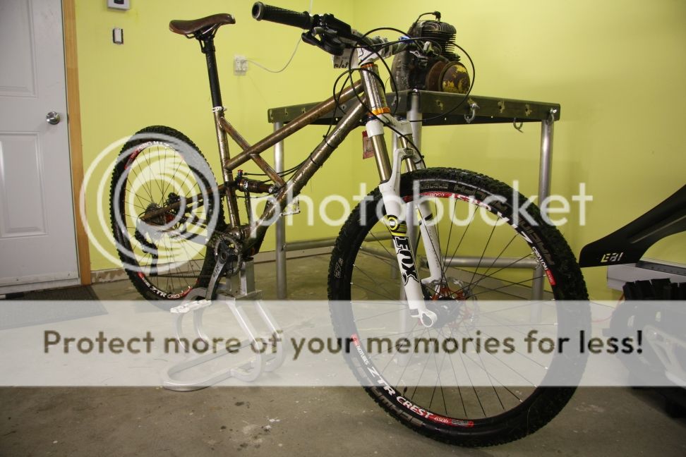

    First assembly
    Big thanks to Guillaume @ Golem Cycles for the reaming, facing and chasing the threads on both frames. Beer and a half and they were done.
    Every builder's nightmare : finding out that the BB is welded on the wrong side... which is exactly what I have done on the GF's frame !!! Ah well, I guess there are worst things in life than that ! At this point, I don't even care, I'm just leaving it that way.
    Eric, the chainstays are true temper HOX5CS 12 degree single bend 455mm long. Pretty much the only ones long enough for the application.
    Once "rolled", they worked out good.

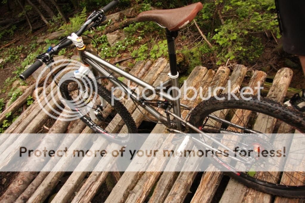

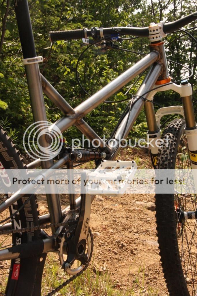

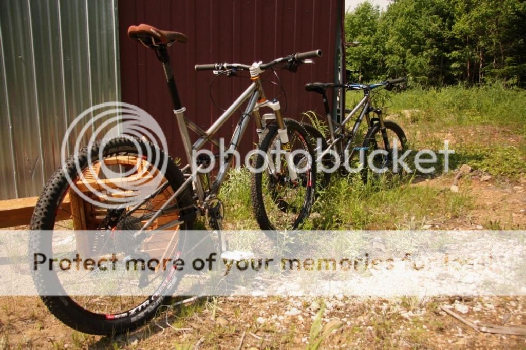

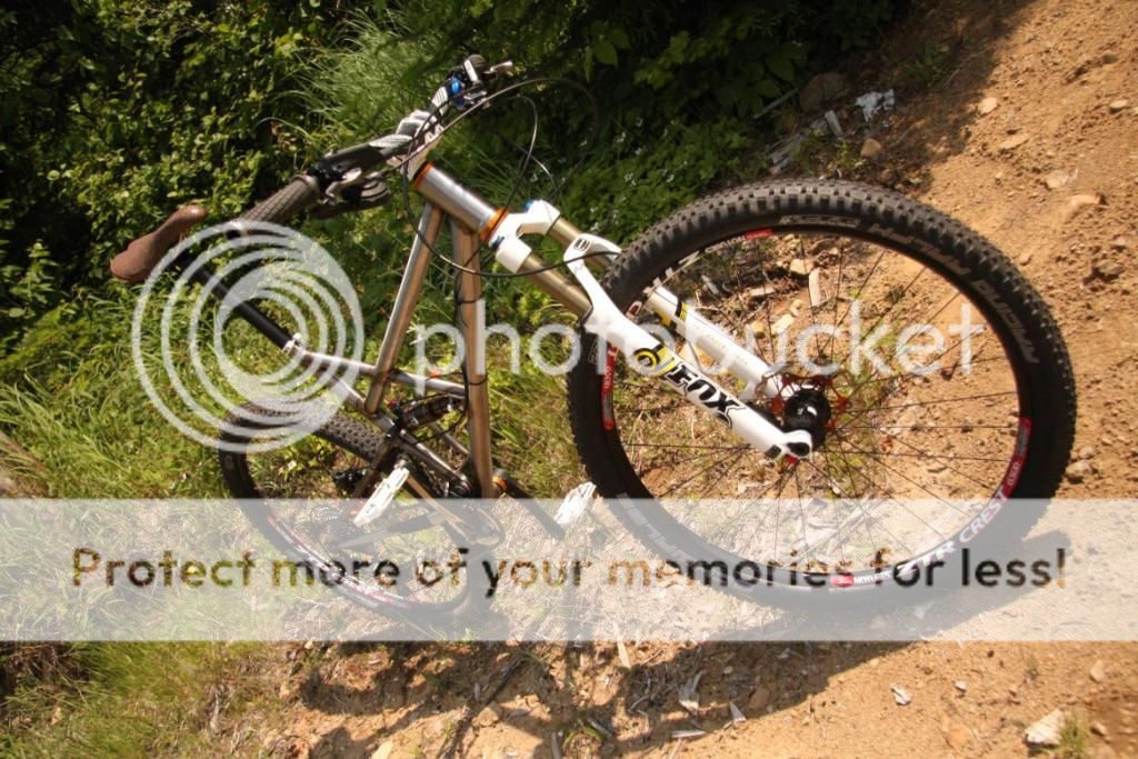

    Tonight I had to do a first assembly to figure out where I'll have to locate all the cable guides. The shocks I got are the remote ones so I had to get the dual levers too. Fork is also remotely actuated. We'll see how she handles...
    Here are a few pics.
    Above the down tube they all are.
    GF says the yellow fox stickers have to go !!! LMAO !!!
    As it sits on those pics it's not functional, waiting on some cups for the main pivot bearings, proper valves for both rims, rear brake caliper adapter. Gotta have the shock spacer turned down to fit... and still gotta ream the seat tube to fit the seat post. Gotta order another seat post clamp too... Little details that take lots of time... !!!! Hoping to hit the dirt with it within a week and a half.

    Reputation: TrailMaker's Avatar
    1,873
    No;
    I have not done the backwards BB housing thing yet, in my two frames worth. I managed to make very sure I marked them in quite obvious fashion, and further managed to take note of my own planning well enough to get them in correctly. I'm probably due on my third one now that I've mentioned it... whenever that happens.
    I would suggest an incremental approach, and blue (medium) Loctite. Just enough to do the job is the incremental way, and blue might do it. It will obviously be far easier to deal with if you have to take it out in the future. If it does not hold, you can always step up to the next rung at that time.
    Consider the BB housing as the "signature" on your artwork. Character point. Very fine work, that once hiccup notwithstanding.
    Most people ply the Well Trodden Path. A few seek a different way, and leave a Trail behind.
    - John Hajny, a.k.a. TrailMaker

    Loctiting BBs in place is a mistake, IMHO. Fix it now while it's still easy.
    For the record, machined BB shells, at least Paragons and others I've run across, are marked to note the left hand thread by the placement of a face groove on that side.

    DWF, I'm curious to know what makes you beleive that it would be a mistake to loctite it ? I use blue and red loctite accordingly almost everywhere on my bikes, sleds and motorcycles and it has worked great so far.
    You also mentioned Devcon on your other post, those guys got a range of products, which one exactly were you referring to ?
    Thanks !

    DWF can certainly answer for himself, but I'm guessing he means once you loctite the BB in place it will be far more difficult to clean it well enough for the Devcon to bond properly. If the loctite doesn't end up working it will be more difficult to repair once contaminated.
    What type of cranks/BB are you using that can be mounted backwards? I know SRAM GXP cannot be as the cranks locate off the non-driveside bearing. I don't know about Shimano/Raceface/FSA BBs. I suppose you could always run ISIS or square taper.
    Thanks !
    Because the earlier you fix it, the less you have to risk. You've invested a lot to get where you are, so fix it correctly now before you risk more is my way of thinking.
    A man must have enemies and places he is not welcome. In the end we are not only defined by our friends but those against us.

    Listen to DWF. Its very wise advice. I suggest the same thing. Not opposing your view, but see the big picture. We all at some point have a frustration moment, and we have to work through it. Mention silver brazing, I 've recently been there...
    Eric
    If I don't make an attempt, how will I know if it will work?

    BB issue; still don't know what I'll do but think I'll just be the stubborn f'ing guy and go the loctite way ! Then I can at least prove if this works or not. We "know" the option of rethreading "works". I'll test this one, then that becomes useful knowledge for the whole community afterwards. Either it works or not, I can always just take the cups off and rethread the proper way, unless the cups chewed up the thread so bad I can't do it anymore but I guess the cups are gonna be the ones getting chewed up.

    Good to see you have strong convictions. If there is a future problem, the alloy cups will go, not the BB steel shell.
    My last experience with a BB was over 2 yrs ago where I towed a young lady home (10 miles) holding on to my hydration pack strap on the road. Her bike was a Carbon every thing road bike and the right cup unscrewed. Off road, that would be a long walk out.

    FWIW, I put an EBB insert into my Carve the wrong way, unknowingly, then installed the square taper BB and rode a race. It lasted approximately 15km before it undid itself.

    Just thinking out loud here: How do old frames with Italian Bottom Brackets hold together (with the "wrong" right hand thread on the driveside)? If old Italians are able to keep pedalling, surely Thierry can on his...
    (My opinion is still to fix it now while you can, but I was just ordering some new BB shells and saw Italian threads were still an option and a dim light went ping somewhere)

    Toby, you are indeed correct, Italian thread is to be avoided like the plague. They do not always give trouble, but when they do..... The young ladies bike that I encountered was Italian. Alloy BB shell in a carbon frame, did not come out well and wrote the frame off. 'Daddy' had plenty of money. It's an easy fix now, potential problem in the future.

    1st time out
    got out for the first time tonight for a quick 10 min spin around the block.
    First thing I gotta say about the bike : It's light and fun to ride ! Can't notice the difference between 26 and 27.5 yet. It pedals very nice too.

    1st ride report
    All right, been wanting to post this for a few days here but couldn't have decent internet access... !!!
    Here it goes :
    Gf’s frame is all set and done, first test out on the street to validate proper function of everything. Pictured here with the missing seatpost. That’s last Thursday (July 4th) evening.
    This build underlines the end of the “first life” of my beloved “short stays” full rigid 26er 1x10, frame built in ‘05 using .035” cromoly for main beam (2”), down tube (1.5”) and seat tube (1.5”), Columbus Max MTB chainstays and seat stays (the old stuff from the early 2000s) as I stole a lot of parts off of it to build both bikes. I’ll clean the frame/fork/headset/seatpost combo and hang it up there ‘til a second life opportunity shows up ! This was such a great frame.
    Finally came the night (Friday 9:30PM) where I got those frames all completed and done (except cable guides) so last saturday morning we loaded our good’ol trusty Datsun Truck… I mean Nissan truck to head east to spend a weekend in the “wild”.
    Our campground for the night of Saturday to Sunday, random p-lot near a beach on St-Lawrence river. Saturday was such a good satisfying day of hiking / ‘’via ferrata’’ for those of you who knows wtf this is. Boys and gals who’re afraid of heights, just don’t go there. We finished out the day with a nice supper in a microbrewery to underline gf’s birthday.
    Since we’re not big fans of overpopulated trails or areas in general, we decided to go to a ski resort that’s closed for the summer and see what we could find there, not really knowing what to expect at all !!! Anyhows, Sunday PM, time to unload and snap a few pics before we put those raw steel newborns to dirty work !
    Gotta thank Tyler @ twenty6 for making aaaawesome CNC parts like seatpost clamps, stems and of course pedals. Those predator pedals up there are, without a doubt, the best damn things I’ve ever put my feet on.
    Bike, myself and dog.
    What we thought was the most interesting thing to do was to hit some of the cross-country ski trails and try to get to a cabin that overlooks the St-Lawrence river. Here’s a view of some of the terrain we went thru.
    Still didn’t know about that brown seat until I looked at this pic, then it seemed like the right color to pick.
    Tree hugger.
    The trail turned out to be a pick-up trail at first, then became a quad trail, then just a single track, then basically almost lost the single trail to the point where we had to hike. I figured we hiked about half a mile in total cauz some sections were just too rough to pedal thru.
    We got our fair share of techy descends and climbs during the trip. Unfortunately didn’t snap any good pics of those. The bikes handled them very nicely. GF did awesome on the techy descends for a second time on such trails. I almost went over the bars at least twice but manage to stay on the bike, thanks to the 68 degree HTA and short stem. Techy climbs were fun too, the bigger wheel on my bike seem to offer awesome traction as I got myself trying a couple of “impossible climbs” and ended up bailing a lot further than I thought I would. All of that to say that overall the bikes are pedaling nice, climbing nice and downhilling nice. Also, I had left the 3 chainrings on the gf’s bike since I ran out of time to take 2 off. It turned out that she used the granny ring a little bit for the longer climbs. Shifting it “manually” ! Thought that was a cool “option” to gear down that doesn’t add lots of weight.
    After about 2 hours of “b’hiking” we finally got to that cabin the map said we wound get to with the paycheck we were expecting: an awesome view of the St-Lawrence river and nobody else but us and the bikes on the mountain to enjoy it. Those pics ain't doint it justice !
    The last section of the loop back to the truck went so much quicker as this seems to be the access road to the cabin for quads. That last mile and a half before the cabin was obviously the roughest we had gone thru all day. We completed the 13.5km/8.4miles (ish) loop with a long downhill run down the main gravel road back to the truck.
    Once back to the truck, dog needed to burn some steam so him and I headed back up the logging road for a quick run. This little guy just loves to pull !
    We’ve been doing this every day for about 4 years now !
    Loving life.
    Fully loaded.
    Wrong side BB update : The cups are holding there nicely, still. I ended up using blue Loctite… a lot of blue Loctite since I ran out of red… ! Time will tell if this holds up but as far as I’m concerned, it seems to be “glued” in there pretty good.
    I’m taking an extra minute to thank all you guys for following my build. That was an extra dose of motivation for me to share this experience with people who are interested in frame building. By looking at the amount of views on the thread, you are more than just a few. Cheers to ya’all.
    I’ll make sure I get a few pics of the bikes once they’re powder coated.
    Thanks. Thierry

    I had the chance of riding in a variety of terrain during the last 2 months and the thing rides awesome in 97% of them. Went over the bars twice in the steep technical stuff so I wouldn't change a thing except for a slacker headtube (I'd go 66.5 or 67 instead of 68) Love the ride feeling of steel. I use it almost every day.
    The gf's bottom bracket that I welded on the wrong side is still holding up great. I'm calling all good on this fix. So, for anyone who may do this mistake you know it can be fixed easily.

    All right, finally got some "appliance white" pow on that bad boy. Ain't the exaaaaact white as the fork but, eh, pretty happy with it.
    Seat post clamp missing cauz it doesn't fit anymore...
    Cheers.
