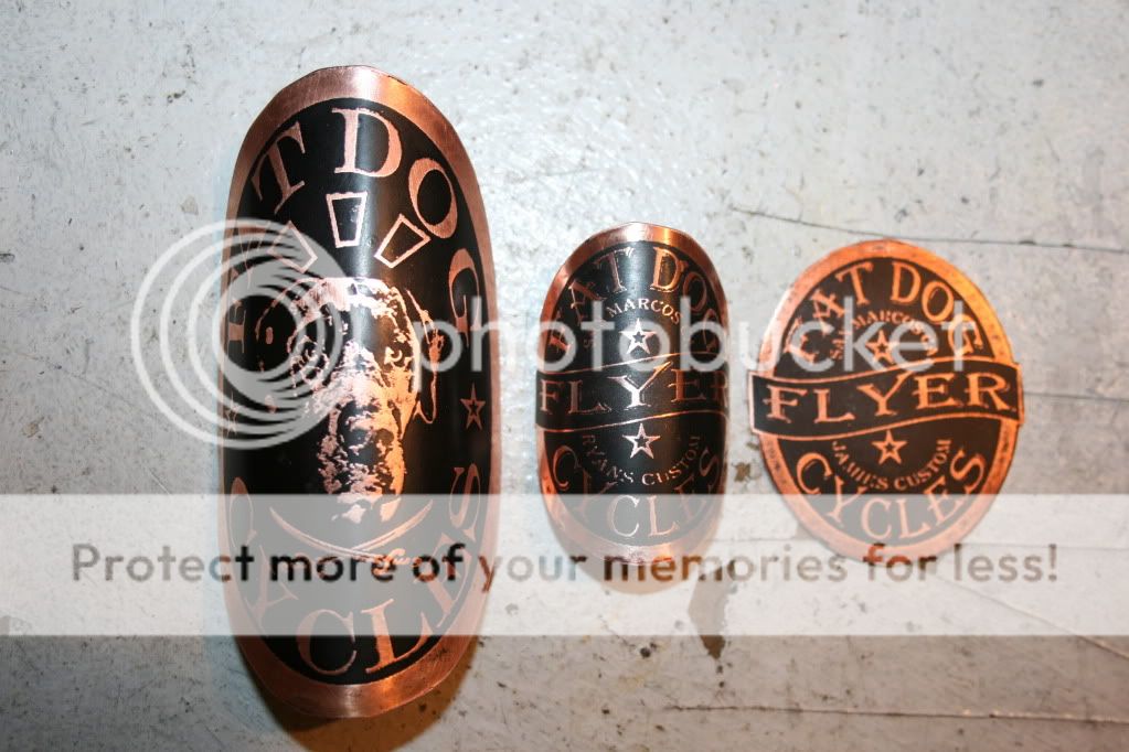

    Reputation: dr.welby's Avatar
    1,134
    <img src="http://farm3.staticflickr.com/2010/2333669688_d05f214fdc_m.jpg">
    I etch copper and brass, using the toner transfer trick, but I just print it on to glossy magazine paper and then soak it off once it cools.
    To etch the metal, I use PCB etchant with a little citric acid which gives a deeper etch.
    1,134
    Quote Originally Posted by marpilli View Post
    That looks fantastic and I'm very interested in what you used to etch it. The last PCB etchant I used (a long time ago) was from Radio Shack. Are you using something different?
    Searching for PCB etchant and citric acid turns up the phrase "Edinburg Etch". Am I headed down the correct path?
    That's the stuff. It's just RatShack PCB solution (ferric chloride?) and some citric acid powder from the homebrew store.

    I tried one on copper. It came out pretty good. I specifically wanted it to look old because it is going on a 1936 Elgin. I etched it and then used krylon semi-gloss black. I then wet sanded the paint off the raised areas for contrast. Then I sprayed on an enamel tarnish shield which gave it the cracked paint look and patina to the copper. I will keep experimenting but this one looks ok.

    I can tell you the transfer process is much more difficult onto copper. The paper I use transfers to aluminum like a dream and when you soak it it just comes right off leaving a nice transfer. On copper however it does not stick as well. The paper to use is staples color laser paper gloss finish heavyweight item # 633215. $13 dollars for 300 sheets.
    This one is a little better.

    Got them cut and shaped today. I found the best method for shaping was to use a pipe that is just under the desired diameter, wrap the badge in paper and masking tape. tape it to the pipe or tube and just gently tap it with a rubber mallet. Then when you pull it off it will spread a little and fit just right onto the larger diameter head tube.

    Here are a couple that I made. It turns out you can just draw stuff on the copper with sharpie paint pens, and that seems to work out alright.
    and filled in
    Thanks for the great how-to!

    DIY all the way
    Reputation: Mr.Magura's Avatar
    Aug 2010
    2,111
    Nice badge there.
    Just a heads up.
    It only works with permanent non-water based markers, and only the black ones, as they have solids in the ink.
    Paint markers are to prefer, gives much nicer results.
