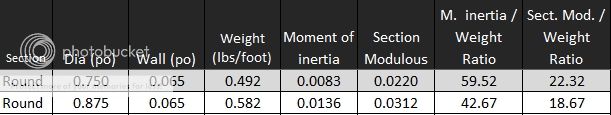

    Todd,
    Theoretically, assuming your walls are about 1/16'' (1.6mm), the 7/8'' tube has 141.8% more Section modulous (strength) compared to the 3/4" tube !
    What was the size of the chainstays you were using on your other steel 36ers ?
    Keep up the good work !

    Question on the Chainstay cut-out and capping - tire clearance.
    Now that you have a full bike now rideable, is there much lateral flex? I know that when a wheel is fitted, this stiffens the whole structure, what I am interested in is how bendy is the whole fitted up structure as built up and completed as a bike. Your 36" wheel will expose design flaws more readily than a short chainstay BMX bike. Just wondering how yours has come out.
    Eric
    If I don't make an attempt, how will I know if it will work?
    WIGGLER
    Reputation: todwil's Avatar
    Feb 2007
    939
    Yea for tire clearance adding an 1/8" doesn't seem like a lot but it is when trying to get tire, cranks and chainring to fit. The lateral flex is less than the steel frames and the last aluminum one That I built in Oct.
    PAYASO 36er.....Live the Circus
    MR. 36er TROLL
    I'm sorry what part of "BIGLY" didn't you understand?
    Reputation: Eric Malcolm's Avatar
    Dec 2011
    1,079
    Hey thanks.
    I have noted in general, how various recent builds are trending in this cramped area and how they are performing. I am not doubting any method, just looking at what works, and you have a few examples to compare which is why I asked.
    Enjoy your ride, that's why we do this hobby.
    Thanks again,
    Eric

    Reputation: Meriwether's Avatar
    442
    Nicely done! I dig those chainstays! Has me wondering about doing that with steel for fat tires. Seems easier than a yoke and cheaper.

    1,873
    Hey;
    Of course, these clown stays are quite nice. Regarding this in general. I've had no problem getting clearance on my Fatties without any games at all. No dimples, no squashing, nothin. I suppose if you are trying for short stays, you might need to play these games. I have not built a short stay bike as of yet, so I can't say from ride experience, but my gut says it is all a bunch of hype & hooey. I've laid out short stay fatbikes bikes, and still did not have to do any of this squashing junk to get room. i'd like to build a short stay fattie, just to see if it makes any difference.
    I'm betting not that much.
    Most people ply the Well Trodden Path. A few seek a different way, and leave a Trail behind.
    - John Hajny, a.k.a. TrailMaker
    Reputation: Testmule's Avatar

    WIGGLER
    Feb 2007
    939
    Quote Originally Posted by Meriwether View Post
    Thanx I would like to take credit for the idea but I saw it done on a fat frame and it looked clean so when I couldn't get all to fit I did a little R&D (review and duplicate) from Kavik facebook pics! He has some fat frames he was making that he shows a real clear pic of. It is definitely easier than smashing and flattening.
    Dec 2011
    1,079
    I observed in my early years in the Bike trade, that when presented with frames requiring rear end repairs that round stays were the strongest (required the most effort to bring into alignment). Mostly on track bikes, these were stiff as a bike. Road bikes were either round-oval-round or dimpled. ROR was without doubt better than dimpled especially on the drive side for the same give wall thickness. The variations that we see now are quite numerous and it is hard to clarify which ones really work well as comparisons are hard to come by. I like the conclusion of this variation.
    Eric

    Nemophilist
    Reputation: TrailMaker's Avatar
    1,873
    Let me clarify;
    Saying that I didn't think it would make much difference was not clearly illustrative of my point. I don't think it would have a lot of positive effect on a fatbike's handling. Like Testmule says, I was betting it would be negative; reducing the characteristic of Fatness that is one of its hallmarks - tractability.
    I would surmise that this cutting and capping routine was stronger than squashing of any sort, which is probably done because it is a QUICK & EASY way to buy clearance in a production setting, not because it helps frame stiffness.

    is buachail foighneach me
    Reputation: sean salach's Avatar
    6,589
    Quote Originally Posted by TrailMaker View Post
    Hey;
    If anyone has told you that short chainstays are for everyone, they were definitely feeding you a bunch of hype and hooey. Short chainstays are great for certain riding styles, horrible for others, when used in combination with appropriate geometry elsewhere on the bike. All other things being equal, short stays, high bb, 70-72 hta, will generally equal a fat bike with more trials friendly geometry, great for rock crawling and slow speed maneuvers in chunky terrain. It will also work pretty well for floatation, but wont be as stable and 'sit-in' as bikes with more 'normal' fat bike geometry. Short stays, low bb, slack hta will generally equal a bike that's very fun at speed, stable, but favors the downhills more than the uphills and is a little bit better at bunnyhopping than most normal fatbikes.
    In other words, if you like the fact that fat bikes are very stable, float well over soft surfaces, and generally handle like a normal bike, then you probably don't need to try a short stayed bike. It probably wont be of much benefit for you. If you have a trials or street/bmx background, and want some of that playability in your fatbike, a short stayed bike will probably suit your riding style very well.
