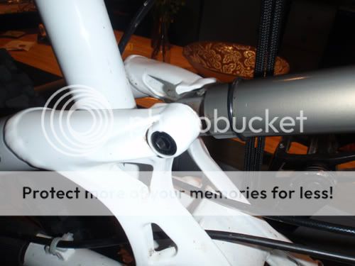

    On such a pretty bike the bolt heads and nuts used on the scissor link and shock really stand out. Santacruz finally started specing nice hardware and Foes should do the same.

    100% agreed. I have a very cool fastener shop not too far from the house. Some trick buttonheads would be nice, or something along those lines.

    My old Bullit had standard hardware just like the Foes. Here's the new Bullit. It seems most bikes now are using fancier looking hardware.
