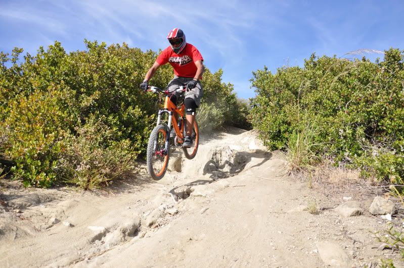

    Hey, here is an update:
    So I finally got the Totem on (Took a little while). Oh man is it a big fork. Iím 6í5Ē and ride a 21.5Ē frame, and the thing still manages to look massive. If you have a small bike its gonna be pretty silly.
    Anyway you probably want to know how it rides. Iíve had about 10 rides on it, and its PHENOMENAL! The extra 20mm travel isn't a big deal, but the 40mm stanchions and overall feel of the fork are. The improvement from Lyrik to the Totem is HUGE, the ride characteristics are completely different. I feel like I got a whole new bike! I'm hitting lines that I never hit before and coming down all my favorite trails significantly faster, the confidence you get from a massive fork is ridiculous.
    The biggest improvement Iíve felt is the way the the fork absorbs landings. I suck at anything airborne, when it comes to ramps, drops, jumps, etc I am pretty amateur and tend to nose dive often. Before I got the Totem I was also afraid to get any real air. Thatís not the Lyrikís fault, itís a fine fork, jumping just isnít my thing. But the Totem is so plush and so solid that Iím coming off of stuff I was rolling before! It really feels like cheating!
    The downside is that its noticibly heavier and the lack of travel adjust makes steep climbs a pain. I still climb all the same stuff, but it takes alot more effort. Definately lost some versatility here, but not as much as I thought I would. It's so worth it on the downhill though. I feel that this is the best upgrade I have ever made and its really increased how much fun I have on my bike!
    So Iím happy as can be with the switch. But its not for everyone. As youíd expect, the totem does limit the bikeís climbability and add more than a pound. I personally donít mind because I love to ride downhill. Thatís why I bike. But if you need to keep up with a group of riders going uphill, you may want to really think about it.
    Here are some photos of me on the Totem, taken on my most recent ride:

    Great Info and pics, thanks again for the update... I will have to look into the Totem or the knew line-up from Fox...180 TALAS looks bad ass.
