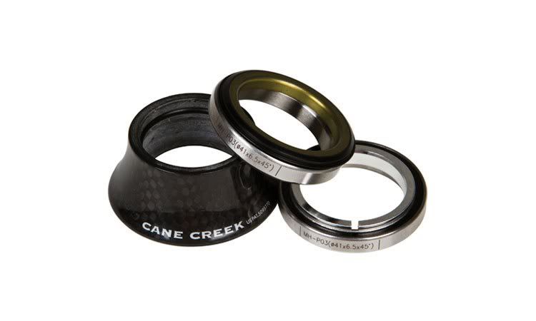

    hello from France
    I hava a question concerning a FELT NINE SOLO 2008 with integrated headset.
    I got the frame without the headset
    What kind of Integrated headset i need ? 36/45 ° or 45°/45° ??
    regards
    French fever

    Quote Originally Posted by french fever View Post
    hello from France
    regards
    French fever
    You need an IS-Style headset, measuring 41.6mm x 6.5mm at 45/45
    www.feltbicycles.com - wilcouchatfeltbicyclesdotcom - facebook
    I don't see a lot of (any) campy-style headsets listed as 41.6mm. Is 42mm considered the same? For reference, I'm looking for a headset for an '09 Nine Solo.
    Reputation: french fever's Avatar
    17
    yes it is any 41.6 mm x 6.5 x 45/45°
    Reputation: trout_smith's Avatar
    54
    My question is: does it exist? I have seen 41.0, 41.2, 41.8 and 42.0. Does anyone have an example, like the one pictured, of the exact correct spec?
    The other thing that's confusing is that Felt's own spec for the 2009 Nine Solo lists the headset as the "Cane Creek" style. But isn't a 45/45 considered a "Campy" style?
    Thanks in advance,
    Eric
    54
    OK, after searching and searching, I have discovered two things:
    1. It's not 41.6mm O.D. that I'm looking for; it's 41mm. Right? That's what the bearings are clearly inscribed with in the linked pic.
    2. The picture posted (with no links or description) is from Felt's own website and is for a (proprietary for Felt?) $59.99 headset.
    What I'm not clear on, though, is:
    3. How important is the stack height? I see many headsets out there that are 41mm O.D. and use 45/45 angular bearings, but none that have a 6.5mm stack height. All are anywhere from 8mm on up. Can I use any of these, as long as I'm OK with the headset being partially exposed?
    Reputation: elopez's Avatar

    Quote Originally Posted by trout_smith View Post
    the problem is not solved yet, THIS IS NOT the correct headset finally !
    Maybe they really have a problem of communication with the customers,they don't even know what it needed.
    i got a headset like this 41.7 x 6.5 mm x 45/45
    it won't fit ! the tube inside is really low height.
    i check it and it's a 36°45° for the solo
    54
    Hoping the felt rep can go to the source and get the true spec. This is going to be the only thing I'm waiting for to complete build.
    I suspect it may be 30/45 also.
    Mar 2012
    Thanks all - I got the following reply by e-mailing Felt:
    "Here is a link to the 2009 Felt Solo from our 2009 website: Felt Bicycles USA - NINE Solo (9550)
    Any 45 degree, 1-1/8" integrated, IS-Type headset will work with your 2009 Solo. We offer a Cane Creek headset on our website that will fit on your bike (Cane Creek 1 1/8" Carbon Headset - Felt Bicycles, though it does not come with top cap, pre-load devise, or spacers), or any local Felt Dealer can help you pick out a headset. There are a variety of options out there, from companies such as Cane Creek, Aheadset, and FSA.
    Thanks again, and please let me know if you have any other questions!
    Justin Plinz
    Felt Bicycles"
    Based on that, I ordered a cheap Aheadset branded headset:
    Aheadset Integrated Threadless Headset IS 1 - 1/8" Black (840226090047) | eBay
    Installed just fine and good to go. What confused me was that it sounded like I "needed" a 6.5mm stack height, which wasn't the case.
    All's well that ends well
    17
    Quote Originally Posted by wpcouch View Post
    what's wrong here ?
    simply be careful with SOLO models ! it's the normal integrated cane creek style,simply.
    it's not the campy style 45/45° ! the bearings are too big to fit the integrated headset.
    i have mine installed, and yes it's any IS 36°/45° not matter it's 41.6mm or 41.8 mm
    Integrated headset sucks !
    17
    for the SOLO the lower bearing is 36°
    on the picture the big fat bearing is a campy style, won't fit the SOLO
    17
    when i received my frame i got these.....??
    and on Mtbr forum i found that pic
