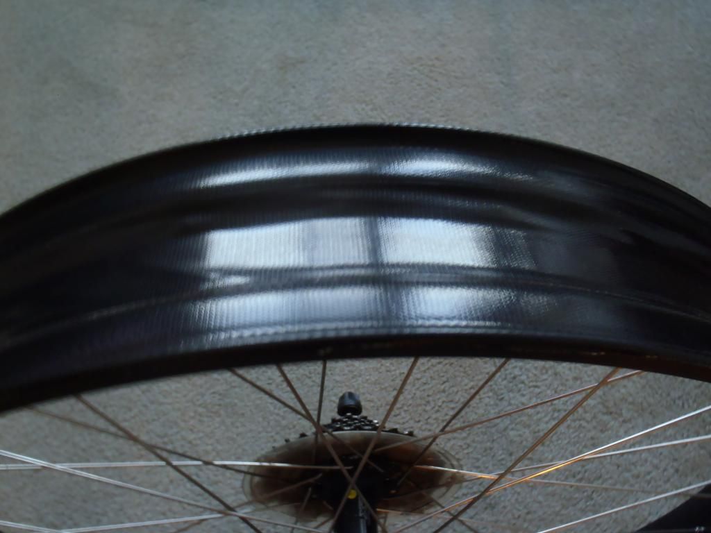

    This is a hybrid of other methods covered on this forum with a couple of twists. I will focus on mostly what is different about this method. This is shown on Rolling Daryl rim, drilled version and a BFL tire. First, clean and dry everything.
    Seal the rim with duct tape as discussed in other threads. The pics here show a minimal taping method which has pros and cons, but I am back to using full width duct tape now.
    Install a tire and tube and inflate to high pressure and let set, overnight if you are patient enough. This sets the beads and presses the tape down firm. Let the air out, break one bead and remove the tube. Install a strip of weather stripping on the side where you broke the bead.
    The idea is to use the weatherstrip to hold the bead out on the side of the rim, close to the sidewall. Note the trough created between the rim and the strip. I have gotten this method to seal up just as you see it with a floor pump. But the problem is the weatherstrip soaks up a lot of fluid, gets heavy, loses its adhesive, comes loose, and flops around inside the tire as you ride even though the tire is still sealed. Very frustrating. I tried to convince myself it was OK to ride like that, but I decided no way. So I modified the method to cover the strip with more duct tape.
    This layer of tape is not sealing the rim, just holding the weatherstrip in place. I do not think it is possible to get this layer of tape to do both, it always wrinkles too much.
    After that install the valve. In this case a Stan's or similar valve is an option since the valve is only going through the rim and the rimstrip.
    Pull the entire loose bead outside of the rim and push it into the trough from the outside. The weatherstrip/duct tape combo should let the bead fall into place and hold it very close the the rim sidewall.
    From there it is easy to seal with soapy water and a floor pump. Once I am sure the tire is holding air and the other bead has seated, I let the air out and add Stan's fluid or similar through the valve. By adding fluid later the adhesive stays drier longer in the process. With a Stan's shake and a short 15 minute bumpy ride everything seals up tight.
    Update: I rode this for about a month and it lost its seal. I use full width duct tape now, as stated above. The ridge inside was holding but was working its way loose. I am thinking about using caulk to create the ridge now rather than tape and foam. Standby for more updates and experimentation.
    Final note: It would be possible to shape the inside wall of a rim like this, no? If so, I think someone should do it. I wonder if this design is patentable?

    I have been riding the rear like this for a few weeks. Noticeable improvement in traction, esp a low pressures. I ride beach sand. With tubeless I can climb the steep loose sand and travel across loose, coarse sand much better.

    I have updated the initial post and I will continue to do it as I update this method so people new to the thread will be up to date.
    1) I use full width tape now. I had a narrow strip lose its grip where the tape overlaps at the end of the strip. The narrow strip can work. It has worked in my other tire for a couple months now, you just have to be super careful with it.
    2) When that happened I got a chance to see how well the tape covered ridge was holding up. It was half untaped and eventually would have worked its way loose and started rolling around inside the tire just like before. My next iteration will involve making a ridge out of caulk applied to the tape. Not to the tire, just the tape. The idea is not to glue to the tire, just create a ridge to hold the bead out. Caulk will not absorb and waste fluid like the foam if there is a problem, and is naturally water and sealant proof.

    I had one tubeless conversion lose its seal because I did not tape all the way across the rim. Upon inspection, the ridge was working, but was also coming loose. So this time for a ridge I am rolled some Gorilla tape with the adhesive facing outward and applied it to the rim:
    Duct tape is the only thing I can find that sticks to the back of duct tape well. This set up really easily, but I did have to wrestle the bead around the sticky tape. The tape got a little less sticky because I installed it first as you see, then seated one bead and removed the tube. I rolled regular width duct tape to make the ridge. I think making the ridge with a little less duct tape so the ridge was not so high might be a way to fine tune this.
    This may still work its way loose inside the tire. Time will tell. But this is set up way stickier than the other methods I have tried so far.
