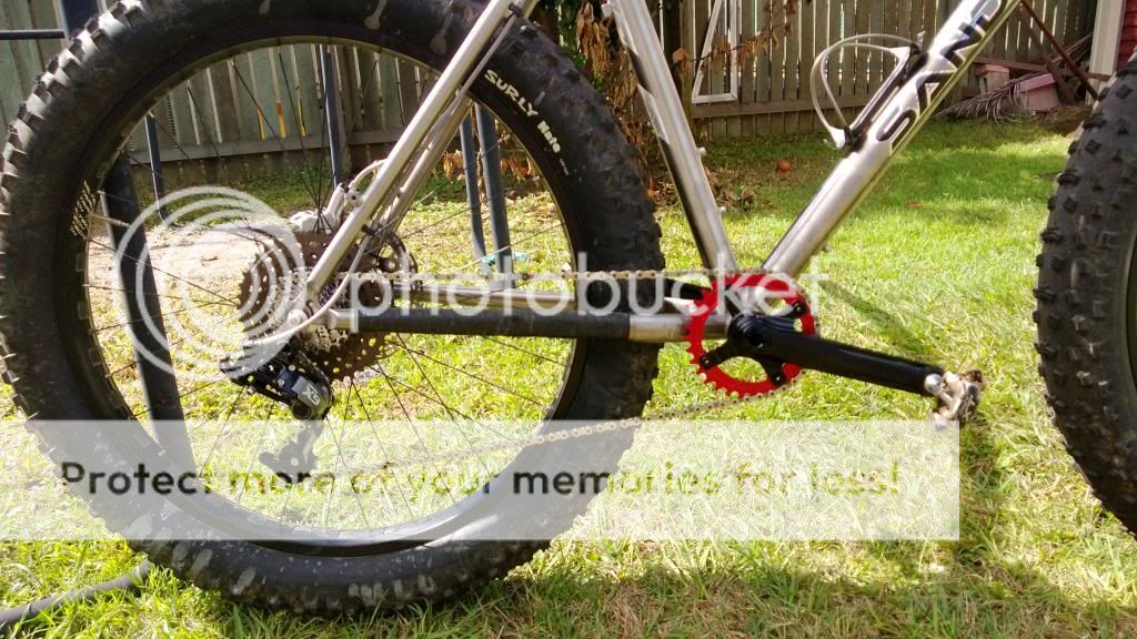

    Kind of like mine below...
    32 tooth front. 11-40 tooth cassette using General Lee and 1/2 a sram cassette.

    Quote Originally Posted by russmu66 View Post
    Its your setup a 9 or 10 speed?
    Nov 2007
    214
    Quote Originally Posted by 98srx6 View Post
    It's a 10 speed setup using an X9 Type 2 rear derailleur.
    I've since changed the front ring to a 30 tooth, using a wolftooth ring... makes climbing a little easier.
    Next stage is to see how well the Hope Fatsno 170mm hub can be 'shoehorned' into the rear dropouts... would like to go full XX1 derailleur and cassette.
    Cheers
    FatMuz
