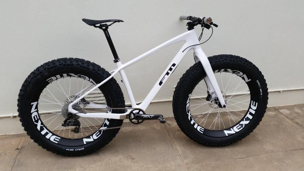

    Yes, Next SL crank with 100mm spindle, flip the spiderless raceface ring and its fits no bother. There is about 3mm spare on each side, fine with a CF frame, might come close on a Ti with flex.
    Frame is a Chi carbon FM190 with 197mm rear bolt thru. This spacing fits a 4.8" tyre on 100mm rims.

    Quote Originally Posted by ozzybmx View Post
    All depends on what cranks you want to run and on what frame.
    Holy cow Bill is that your new steed?
    Edit: Oh and happy birthday a little late

    Reputation: ozzybmx's Avatar
    4,103
    Thanks Bob, 42 and no wiser
    Yes this is the new toy, tried to get a carbon f&f from a couple of big named brands... too hard. Didn't have them, couldn't get them, several month wait, no f&f only and big prices compared to the US retail price. I waited about 3-4 weeks on this and that was because I got it painted plus delivery from China.
    Nice to be back on buds.
