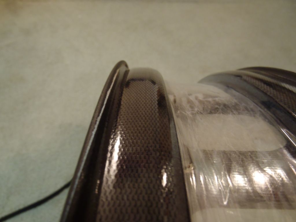

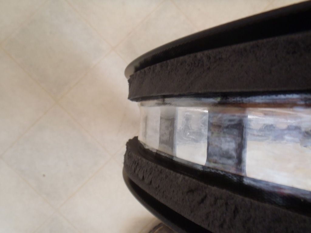

    what method are you useing to get tubeless everytime ,,,any info for the on one fatty wheel thanks
    Laramie, Wyoming
    Reputation: alphazz's Avatar
    Oct 2012
    1,949
    I use gorilla tape. I see a lot of guys stop or trim the tape on the inside of the rim. I think that it works better to let the tape go over the bead to the outside of the rim, trimming the tape against the outside edge of the rim. When the tire seats it will pull the tape back a little and makes it barely visible. I also used some extra firm self-adhering weather striping on both sides of the rim (3/8 x 3/4). Putting foam in the center of the rim makes it easier for airing up the tire but makes changing the tire harder. I tape over the foam, pulling the tape very tight. Put in a mixture of slime and stans in the bottom of the tire and mount it up. I pull one side of the tire onto the foam as much as possible and pull the other side onto the foam a little (most important near the valve stem) and start pumping. I do coat the bead of the tire and rim with sealant. I make sure that if I use different tapes on the inside for affect, that any tape overlaps by 1/2". The easiest way is to use some really wide Gorilla tape, allowing for no seams inside at all.
    I will be setting up another set for another friend soon so maybe I'll document it a little better.
    Mar 2013
    213
    thanks very interested how you do this wouldnt mind few pics on where you put the extra firm self-adhering weather striping on both sides and pulling tape ecte ,,,,well tbh all of it lol ...tried and failed before then gave up
    Laramie, Wyoming
    Oct 2012
    1,949
    Here you go stesteste
    I now trim the tape a little more to the outside of the rim than I did in this photo. Also, if not wanting clear in the middle, I'd use wider gorilla tape and just go all the way across the middle with one piece.
    All fat, all the time.
    Alphazz,
    Thanks for posting that. I tried a similar set up in my marge lite rims and the tire bead could not get up and over the foam. I can't get the bead of the tire on the rim if I don't drop one side into themiddle of the rim. How do you get the bead from the center of the rim to over that foam "hump?" How do you keep the gorilla tape from getting creases when putting it on the rim? Multiple pieces or all one piece?
    I would love to go tubless. It works great on my 29er. The low pressure and flat resistance makes it well worth the effort.
