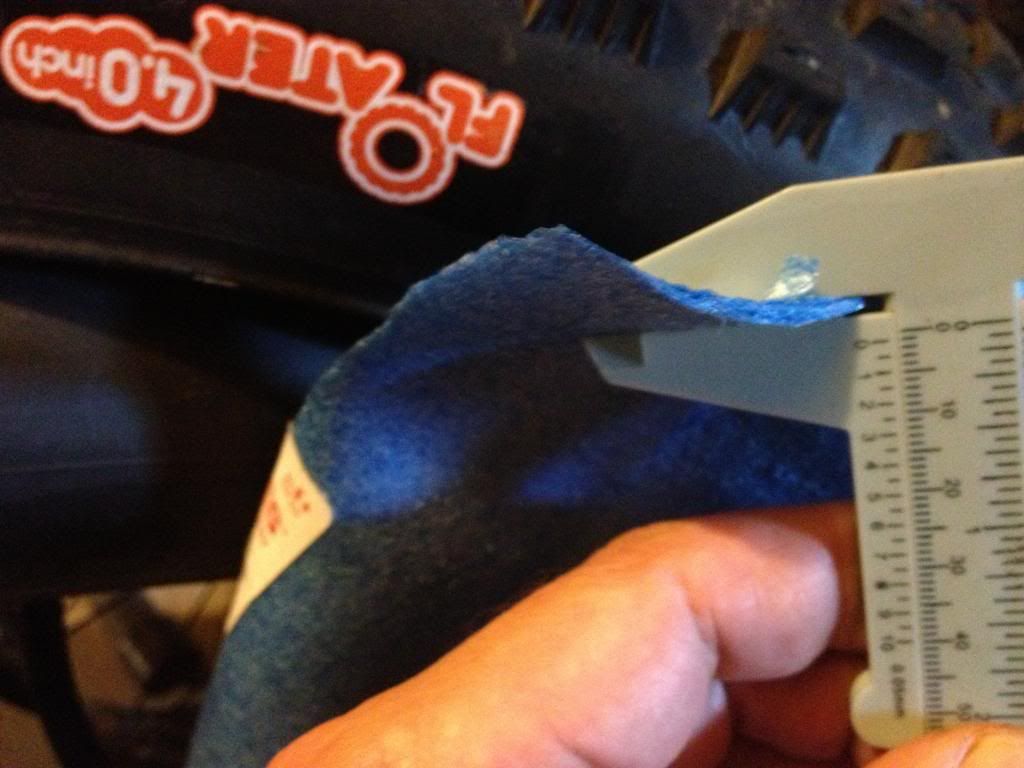

    I cut a 1x1 piece out of a 2 1/4" foam pool tube from Dollar Tree. They're 5/8" thick. An 8 lb. weight makes it 1/2", and 11 lbs. squishes it down to 3/8". Of course it gets firmer as it's compressed, as does the whole tire . I changed from Nate rear tire with Surly tube to On-One Floater with same tube + pool toob, so I can't compare the "feel" yet. It may add damping,and may create drag as the leading edge of the contact patch compresses and flexes it.

    Well, it's been 2 weeks since pool toob insertion, and still no flats, but can't really credit the toobs cuz:
    Oh well, now it's 1mm of protection and probably not much rebound damping.
    I had the On-One Floaters pumped up to like 30# for pavement cruising but lost 1mm off the tread in about 40 miles, so I'll save 'em for winter.
    Maybe just too much air? Maybe the bigger $4 tubes are better? Someone else please check Yours and report. Don't worry, everyone here is just trying to be helpful and I'm sure no one will say "Nyah Nyah" or anything.

    Wow, that's pretty flat. Fat tires wear out fast on pavement. I doubt the pool tube contributed. My Husker dus are hurting already from summer use.
