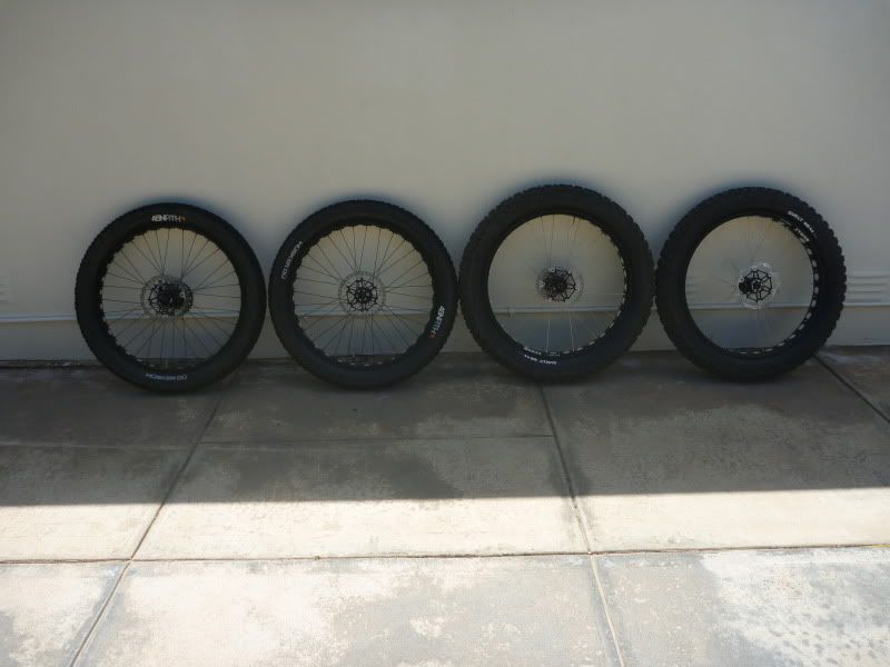

    All this chatter of tubeless and countless threads, i myself have had 3-4 attempts but never using the "build up the valley" method.
    So the missus asked what i was doing today, i said "a bit of stuff outside" she said she would not be home all day and she would pick the kids up from school
    Perfect opportunity for for Toobless Toosday.... though i didnt count on it taking me 5 hours.
    Ok i used Laminate flooring underlay for the foam, its plastic backed and not the lightest but its a medium density foam. I measured the "valley" and cut it into strips progressively getting wider.
    1 wrap around with gorilla tape, stretched and made sure it reached the bead.
    Marge lites.
    Rimstrip = 45g
    Foam = 50g
    Tape = 45g
    So the rim strip stayed there meaning a 90g gain for losing a 220g Q-Tube superlite = -130g
    I have not added sealant to the Marge Lites yet as i will not be riding them until i have got the others sorted.
    This is where i was gobsmacked, i fitted the tyre, gave them a quick once round with some soapy water, gave it 1-2 pumps with the track pump and the tyre move towards the bead and started bubbling
    10-12 pumps later the first bead popped, then the second at about 15psi, i have pumped them to 20psi and they still seem like they are holding air with no sealant.
    Awesome, cant believe how easy that was, most time was taken cutting foam. Thanks to all who have posted their tubeless conversions.... if you see some of you mod here, i probably copied you. Cheers

    Ok set number 2.
    These have been a *****, i have tried these 3-4 times with no luck.Hopefully things have changed.
    These are 47mm Trialtech SL's. They already had a rimstrip weighing 55g as there was a full wrap of gorilla tape on them from the last unsucessful tubeless attempt.
    I removed the old rimstrip and added the foam and new gorilla tape, total gained was 45g more from what they were, the original rimstrip could have been lighter but nevertheless 220g q-tube superlite minus 45g = 175g saved (rimstrip is additional 55g) per wheel. Both wheels have had 70ml of stans added.
    First thing was to block the holes that would let the air escape into the rim and out the butted joint. Filled with epoxy metal putty and a smear of loctite on the joint.
    Same as before, filled the valley with foam. Then taped up.
    These went up with the same 1-2 pumps but did not pop onto the bead, thats why i will try and sort these out first as the other wheels are 100%. I cant burp the bead or let any air out until they are nearly flat but tonights ride will make things clearer. They are currently holding air (after stans blocked about 10 holes from thorns) at 10psi and i will drop that gradually down to about 7psi for testing purposes.
    Hopefully all works well and they stay on the rims, cheers for tips

    Just did a 35km loop, wheels performed beautifully.
    One thing that has surprised me, i usually ran these wheels/tyres at 9psi on dirt
    I started the ride with 10psi in the tyres (digital gauge), i took the gauge with me to drop air out as i went.... wrong. I had to add a little bit making both tyres to 11psi to feel the same as they did previously with tubes fitted.

    I have saved 260g on the Marge/Buds wheelset.
    And 350g on the TrialTech/HuDu's wheelset. (sealant added after weigh in)
    With the new 1080 cassette i weighed my bike in the high 24lbs today, the new "lite" HuDu's i just got are saving me 130g a tyre too, so when its gets the next weigh in i might have a surprise

    Nicely done! Enjoy alot less flats
    Fat & Single
    Reputation: ozzybmx's Avatar
    4,102
    Cheers shark, Ive been tubeless for 5 years on other bikes, if i get anywhere near the result ive had with them i'll be super happy.

    For the two sets of wheels i used 3 proper tubeless valves and 1 made from a tube.
    If you have old tubes with valves that have removable cores just cut round the valve and leave a 10mm circle all around, its just as good bought valves and in a lot of cases cheaper too as the valves are about $10 each .

    Quote Originally Posted by Sand Rat View Post
    the lighting really shows off your handy work; (by design?...or luck?)
    It was stinking hot outside, just lucky lighting as i did all the taping inside in aircon'd comfort.

    Fat & Single
    4,102
    Quote Originally Posted by tjdog800 View Post
    Would that be the "Gorilla Tape" that is doing a great job?
    No, the 8898 Strapping tape (blue). I will never stick Gorilla tape on a set of wheels ever again.
    Ive had about 5-6 rolls in different widths over the past 2 years and used it on every wheel ive had in that time, my enve wheels also came with Gorilla tape from the factory and i dont know why they stick with it, its heavy, it leaves a messy residue, it moves when air pressure pushes against it (more critical on fat wheels), it has or gets over time an uneven glue spread allowing tubeless fluid to go through and under it and the tyre bead sticks to the glue ripping threads off the tape when you remove a tyre.
    You tear the old stuff off to replace it and spend an hour plus getting glue off your rim seat/bead of each wheel.
    All 4 sets of wheels i have now are tubeless with the strapping tape and doing beautifully.
    IMO its terrible stuff but YMMV.

    Fat & Single
    4,102
    Thanks for the clarification! What width do you use and where did you get it?
    If you are in the US you can get it from RS Hughes in any width, i could only get it in 48mm here so that was the width i used.

    Fat & Single
    4,102
    Here you go - **Scotch® Film Strapping Tape 8898 Blue, 48 mm x 55 m, 24 per case Bulk
    The vinyl rims strips are cut from a roll of vinyl cloth at a craft shop, vinyl that is used in dressmaking, basically coloured waterproof cloth.
    The second attempt, and third and fourth i always use 10mm EVA foam. This non memory foam makes it easy to inflate tyres with a floor pump.
    Good luck with your conversion.

    Fat & Single
    4,102
    I have just done a little experiment tonight successfully.
    I have used ripstop nylon as the rim strip, weighs about 1-2g for 2 wraps, feels like feather weight, my scales wont even register.
    Then 2 wraps of 8898 tape @ less than 10g.
    The ultralight HuDu was inflated on the margelite rim for a week at 30psi with a tube, i deflated and took them off, cleaned the old tape off the rim then did the new lightweight taping, put the tyre on with a tube then inflated... popping both beads.
    Carefully removed 1 bead seal and the tube then screwed in a tubeless valve with 1 bead still seated.
    I then put some soapy water on the remaining unseated bead, set the wheel horizontally on a bucket (so the unsealed bead was being forced down with gravity and inflated it with a track pump popping the other bead and sealing the tyre onto the rim successfully.
    So tomorrow when i get time i will inject 60-80ml of stans into the tyre through the valve stem and see if i can seal it.
    So the complete rimstrip with tape is around 10-15g in total.
    Will keep yous updated when i add the stans and try to get the tyre sealed.
    My whole idea with this is as an out and out race wheelset.

    Fat & Single
    4,102
    Has your tape covered the holes on the rim bead ? .... might be escaping from there into the rim join and getting free azza bird.

  93. #93
    Jan 2013
    25
    One place you really want to tape up is the holes on the bead near the weld seam on the Surly rims. Otherwise you will be trying to plug those with sealant and since the rim has hollow sections it might take ages and way too much sealant.
    I've been running Marge Lites with Husker Dus and Escalators for a year now and at the very beginning I tried to seal them with just rubber against the rim bead area. I ended up having lots of slow leaks when the tire was flexing around and concluded that I would have to use a lot of sealant to have them eventually seal so instead I went with a split tube method.
    I did experiment with wide gorilla tape that was placed from rim edge to rim edge where the tire had tape between it and the rim without direct contact for the tire to the rim. I found that the gorilla tape is too sticky and difficult to get into place without crimps around the bead area. Those crimps usually resulted in slow leaks, just like the bare rim.
    Wide tape that is easier to get in place and doesn't leave crimps or other leak prone areas might be more successful.
    I built up a Clownshoe wheelset for the same Husker and Escalator tires and opted for split tube directly without messing around with other methods. I will be running low pressures on the Clownshoe wheelset for the winter so small burps and slow leaks with a ton of sealant was something I wanted to avoid.

  98. #98
    Reputation: Gizzard75's Avatar
    Aug 2013
    93
    Dont think the tyvek tape is the right stuff for the job. Got home wrapped it all around the outside of the rim and aired it up- getting better at the bead snapping- soaped it up and it was leaking in one spot on the bead and in just about every rim hole- too much. I pulled it all off - tyvek tape sucks to remove btw, tears very easily.
    Split tube or Gorilla tape?? Pro's and Con's... I assume that the gorilla tape is lighter and the split tube is easier- which method is more robust?
    I have the tubeless valves so really I am going to go with gorilla tape- although I would prefer schrader valves over prestra... blah going gorilla- thanks again for all your help!
    After reading the thread better I think 8898 tape instead of gorilla- for now though I am going to put the tube back in so I can freakin ride my bike!

    Fat & Single
    4,102
    Ahhh.... another happy fatbiker with a tubeless fail.
    Its a friggin pain-in-the-a$$ going tubeless on fat wheels, worth it once you get it right but hurry up Stans tubeless fat rims I say !!!
