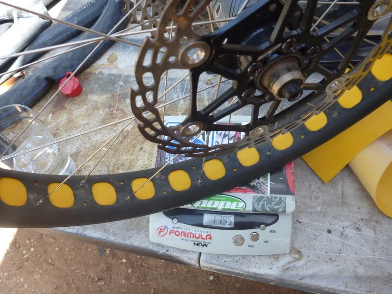

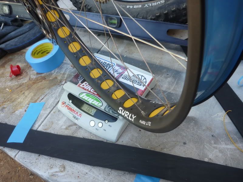

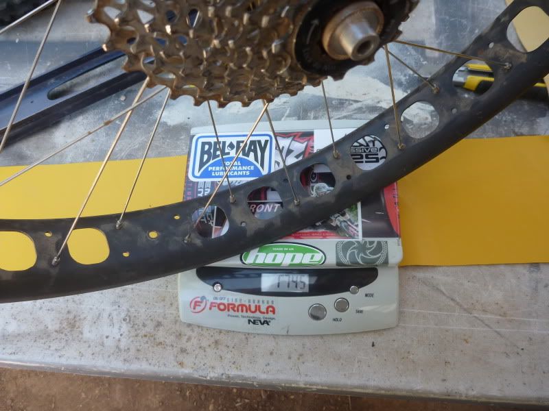

    Gizzard, did you try the Gorilla tape? I have tires with Gorilla tape that have lasted for a long time with no deterioration of the tape. I know it's not the lightest but it works well for me. I run the tape well past the outside of the rim while pulling it VERY tight (step on the bottom of rim as you pull the tape). I push the tape down into the bead area with something smooth and then trim the tape along the outside of the rim.
    I agree with you on the schrader valves instead of presta. They are sturdier and easier to work with. The motorcycle shop in town sells the BikeMaster brand of chrome tubeless stems and they have worked well.
    I do use foam as well which I think helps with tire staying seated and airing up.
    My Clownshoes look like this before tape.
    My choice of tape to be seen from the outside. Also, I drilled a lot of extra holes.
    Extra Firm self-sticking foam. I trim it a little after applying it.

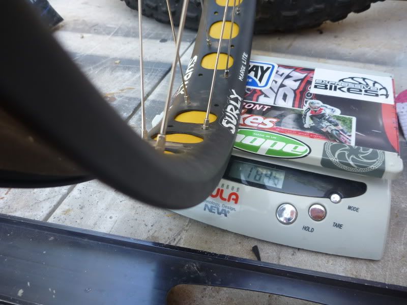

    Gizzard, you couldn't drag me back to using tubes. The foam works although it can be tough getting the tire up on it for the first time. I use the Ace brand Super Firm Sponge Tape, 3/8" (T) x 3/4" (W). My setup isn't the lightest but I do put a lot of miles on my bike without issues.

    Thanks ozzy. Yeah, my son was giving me a hard time about spending too much time drilling, cutting, and grinding on that rim. I think it looks good from the outside.

    ozzy, I wish I could say I cut a pound out of rim, but I can't. Close to 6 oz. though.

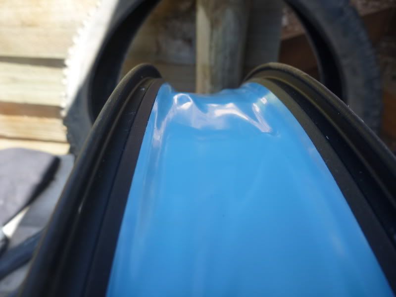

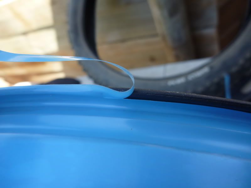

    Fail
    When I got home from work last night this is what I found:
    By the time I got home from my road ride this afternoon the front had gone flat too. The tire bead is still tight on the rim's bead hook, so that's good news, but air and sealant had gotten under my rim tape and and leaked out through the rim holes (and I have plenty of those to leak out of). They held air for a while like this with the Stan's sealing up all those leaks, but I know from working with standard width rims that your sealant set-up has failed if you have any sealant coming out through the spoke holes, which is pretty much the same issue.
    I really thought I was on to something, looks like I'm going to have to reevaluate. I tried to basically follow Ozzy's method, but I'm running the Holy Rolling Darryl rather than the Large Marge.
    Here's what I did:
    I went with pipe insulating foam for 1 3/4" pipe. Its closed-cell foam.
    I cut it in half. Less than $3 worth covered both wheels almost perfectly with just a few inches left over from my 6' strip.
    And spread it out flat over the bottom of the rim it ends up being just about perfect at 55mm wide. Fit pretty nice and took up a lot of volume, for only 18 grams per wheel!
    I got the right tape, 49mm wide, so I figured I could use just 2 strips, one on the left, on on the right with about 15mm of overlap in the middle.
    But I had a hard time getting a smooth finish on the rims, you can see a major fail in the lower right. I eventually tore all this tape off and started over. I got a smother finish the second time around, but not without a few minor wrinkles at the rim/tire bead interface.
    So OzzyBMX, how did you get such a smooth finish with your tape?!?
    I'm thinking of trying again with 3 strips of tape. The middle one would just run down the middle of the foam strip, since the foam is about 55mm wide. But maybe it would be a better surface for the two edge tape strips to adhere to, and perhaps also give the middle foam more of a firm surface. That's probably worth 10 grams. But without a really smooth tape job on the sides like Ozzy has, I don't see how it could work.
    The other spot I could see air and sealant getting out is around the valve core. On the front wheel I tried using one from an old tube with a nice wide circle of rubber around it to spread out the compressive force. On the rear I used a American Classic valve core, and coupled it with a small sheet (1.5"x2.5") of hard, clear plastic I cut out of some packaging to help spread out the force of the valve stem over more of the surface of the foam. But perhaps this is the wrong approach... perhaps I should try more of a plug style valve stem, like the new WTB valves?
