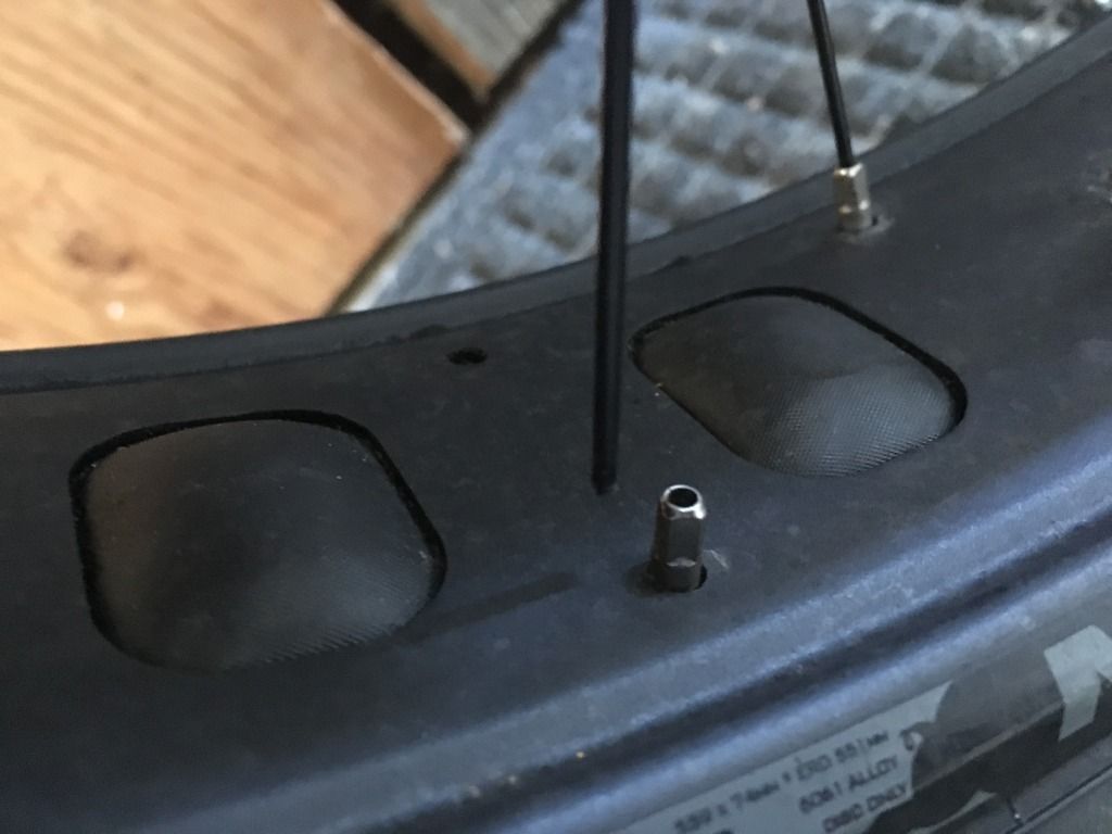

    Hey guys. So I bought a Trek Farley 7 last fall and have been riding it all winter so far. It's great, love it. Except for I've broken 3 spokes now in the drive side of the rear wheel. My LBS that I purchased the bike from has been fantastic in replacing them so far, but its a major annoyance. We are going to start a warranty claim this time around with Trek and see what happens I guess, maybe try a new wheel.
    Has anyone else had or heard of issues with the Mulefut rims? The are without a doubt the most popular wheel out there so hopefully hear from some of you guys on it.
    Little more info, just for reference. I'm 6'1" 245lbs riding a Large frame Farley 7. 2 spokes have snapped in colder weather (-20C or lower), and this one around the -10C mark. The wheel was trued and tension set after each spoke replacement, even dropped the tension after the 2nd break to see if that made a difference. There hasn't been anything on the trails that has gotten into the wheels to break the spokes, and they are all snapping off at the nipple.
    Any help would be appreciated guys. Thanks in advance.

    This is important since you seem to be unfamiliar with the terms and parts: Is the spoke actually breaking, or the nipple? The nipple is the thing you are referring to as "the tensioner". This is usually the weak link. And, are these alloy or brass nipples? You are a heavy guy, so you'll put more stress on wheels, but I doubt it has anything to do with temperature, they use metal in airplanes that see far colder (-40 on my last flight) temps and we were riding bikes yesterday at -24° for 8hrs.
    4,422
    "The tensioner that sits in the wheel". Do you mean the nipple?
    FYI, you're not that heavy.
    These are factory wheels.
    I'd request a replacement wheel or have the shop rebuild the wheel with new spokes, otherwise you may end up replacing all the spokes.
    It's not the rim and it's not the hub, definitey the spokes and or the build.

    Thanks for the replies guys. Editing my original post with the correct terminology so we're all on the same page. Thought I'd throw a picture up while I'm at it.
    There's plenty of guys running similar setups around here, but I seem to be the only one having issues with spokes. I am the heaviest one of the group by about 30lbs. We ride in all sorts of temperatures (down to -30C at times) for hours as well. So, I thought maybe the steel became more susceptible to shock in colder temps and thats why they were breaking, which was when this had happened previously. This time being fairly mild out is a little it different.

    The breakage has nothing to do with temps.
    Most likely the tension wasn't balanced out properly to begin with, and maybe not since.
    Also very possible that the spokes are too short, thus the threaded portion is failing because it doesn't have complete insertion into the nip.
    Your weight is a factor, but it's not the main thing -- many heavy (and heavier) guys out there riding these rims with no issues.
    I don't think a new (replacement) wheel from Trek will necessarily solve this. Ensuring that the spokes are the right length and then balancing out the tension is the most likely fix.
    And I'm not pointing fingers at your LBS, but it's a rare shop these days (still, and surprisingly) that actually knows how to balance spoke tension. Rarer still that they take the time to do it.

    Perhaps I got rims with a bad set of spokes, who knows. I'll see what my LBS says when they contact Trek tomorrow.

    Well, if the spoke tension is out of wack, but the wheel is true, that means a bent rim and the spokes and nipples have been tensioned to bring it back to true or as close as possible. This can result in some spokes being way above the max tension, and some below the required tension, which is a recipe for breaking spokes. Even after a mild truing or minor issue of wheel truing your spoke tension may not be equal anymore to maintain a true rim, usually it's within the "range" of what will work without breaking spokes, unless the damage was fairly significant. I find this is less common with carbon rims, because they simply can't flex or bend in this direction (NOT suggesting carbon rims), but aluminum rims are traditionally more susceptible to this, having had, bent, and trued many of them over the years. You might just have to "start out fresh", new rim, new spokes, new nipples. If this is an OEM setup, it'd be rare for it to be speced incorrectly to start with, so all I can think of is damage or loose spokes or a combination thereof. If it was speced incorrectly, you need to get it warrantied. Again, it's not about your weight or the temps. If the rim was damaged and "made true", then your weight might be enough to push it over the edge and cause more breakages than if you were lighter, but that'd be because something was already screwed up.

    Just to echo what others have said, the tension is likely imbalanced. I'd also bet as Mike mentioned, that were you to look into the nipples from the tire side, the spokes would be too short.

    Agreed. I've found in 25 years of riding that once you break more than two spokes, it indicates that the wheel wasn't properly built to begin with. The best bet is often to respoke the wheel, which isn't that expensive. the OP's weight and riding temperatures shouldn't be an issue here.

    I am not certain, but I think Trek is using streight gauge 1.8 mm spokes on those. Replacing with 2.0 spokes would be the answer. I have run into a couple wheels Trek has built this way.

    Like everyone else said new spokes properly tensioned and you're set. Good luck with the warranty

    At 245 geared up, I've had several of broken spokes on road bikes but never on the same rim you're riding with MN temps. The spokes I've lost have all been low quality ones from cheap wheelsets and they broke up by the hub. I've never broken one at the nipple. In some cases replacing one might fix the problem but generally rebuilding the wheel with high quality spokes is the answer. I've done that 3 times and none of the rebuilt wheels have ever had a problem.

    I'd think a bad batch of spokes. Not like these wheelsets haven't been used by bigger. New spokes and nipples. Make Trek pay for them.
    Out of the box, my fat bike had surprisingly whacked spoke tensions with true rims.
    I have worked on a couple of 32H 29 Treks that continued breaking spokes,
    mostly at outer cross, even after equalizing tensions.
    No problems with replacement spokes; Trek presumably got a bad batch.

    Food for thought.. If said bike shop adjusted the spokes as part of new bike assembly, possible the over tightened them?

    This is exactly what I was thinking as well. The new guy at the shop messed with the wheel!

    Looking at that picture, it looks like the entire threaded part of the spoke broke off. Correct?
    Get out your magnifying glass...
    Look at the broken part to see if it wasn't twisted off. That might suggest the spokes are actually too long (this would still be unusual) and the nips are bottoming out at the base of the thread - but the wheel tech is still cranking on it.
    I doubt an alloy nip could score/scratch a steel spoke, but stranger things have happened. In that case, the break would be clean through, without an appearance of twisting.
    For that stuff to get brittle at low temperatures, you'd need some cryogenic type cooling.

    If the threads on the spokes were cut vs rolled, that would make them significantly weaker.

    I would have a competent wheel builder check spoke tension on that replacement wheel. All of these failures are certainly to do with bad wheel build. The reason the rims are staying true is because they are giant and most likely not affected by spoke length and tension as a standard width wheel would be.
    If the wheel builder has to make a lot of adjustment to spokes on your new wheel, have it checked again after a few rides.

    Ummm, the fact that a wheel is built with Mulefut rims has nothing to do with spokes breaking. I agree with many here that identify the likely culprit as uneven spoke tension (poor build). Some, including the title of the thread, mention that the wheel has Mulefut rims as if that rim could have something to do with it. Hog wash. I noticed the OP and another have had this problem on wheels made with Mulefuts by Trek (or their supplier). Quality control on the assembly of the wheel by Trek needs to be improved.
    I am not a wheel builder, but I did build up my wheelset with Mulefuts, Hadley hubs, Sapim Race spokes and brass nipples. (Thanks LarsD for the video). Checking the tension with a Park TM-1 tension meter showed tension to be even (if not necessarily precise). The wheels have been rock solid. (I go about 225# in gear)
    If you like to wrench on your bike, a tension meter is not a bad thing to have in your tool box. The TM-1 is a bit crude, but I have found readings to be repeatable. I think it's fine for the home wrench. I did see this one that looks interesting, especially given the price:
