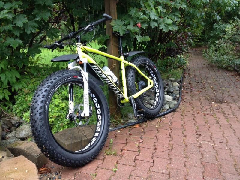

    Quote Originally Posted by Kay9Cop View Post
    Picked up this bad boy yesterday. First one sold in Anchorage. It's been raining for two days, but I couldn't wait so we went for a little spin today on some single track horse trails.
    Love them pro's... did you by chance weigh it. Thinking its around 30 lbs?
