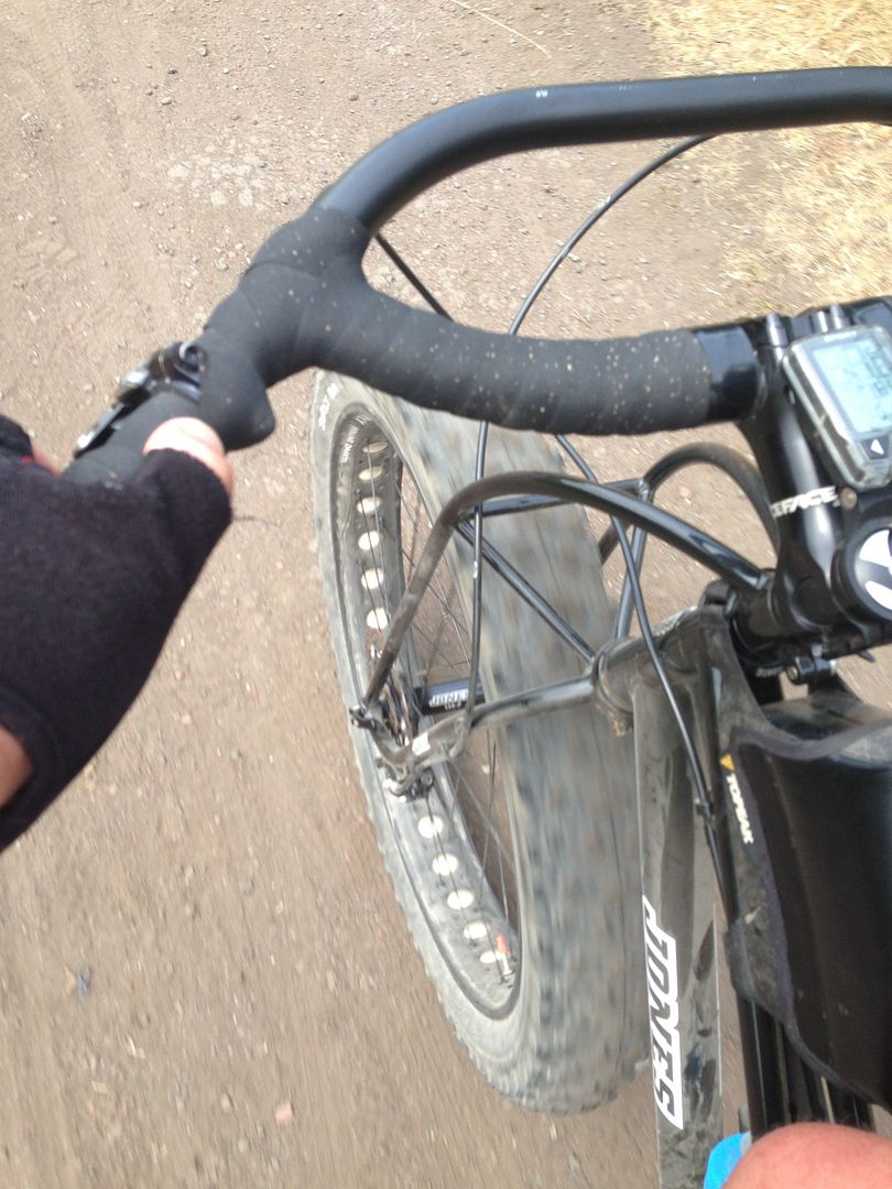

    Holy darryl copes with my 100kg weight and in 1,000 miles its still true and never faulted.....I leave Nate on full time too.
    Good mixture of weight, strength, looks and float.....doesn't sap my energy either, I just ride it everywhere.
