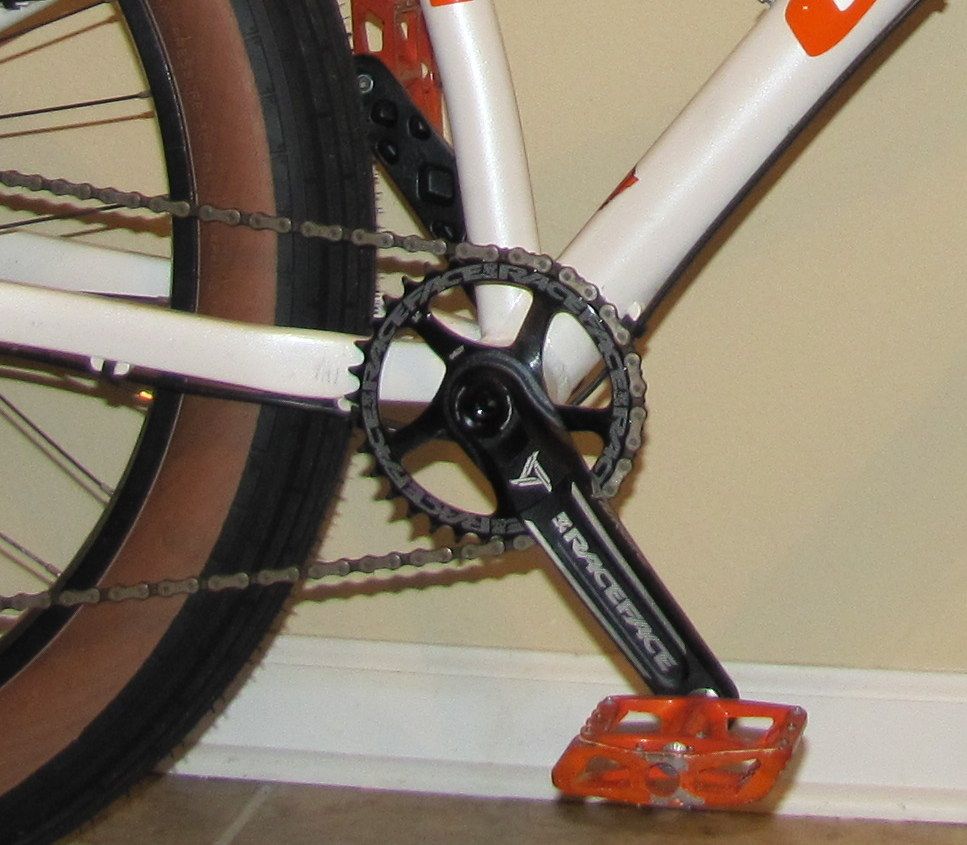

    Quote Originally Posted by VeloRyan View Post
    Nice build...what's the weight?
    Not quite sure. Every thing is fairly weight conscious except the Zee brakes and Race Face Atlas bars. I'm certain that I'm less than 30lbs as pictured. Maybe around 26?

    OK. Here's the update after a few break-in rides.
    The build was fairly strait forward. On-One Fatty Frame with their house Smoothie Mixer headset. I opted for the carbon fork because I ride carbon forks on almost every other bike I own with no issue. Plus I liked what others said about it on here. I used their house bung as recommended for the installation. No issues there.
    Race Face Turbine Stem, crankset, and seat post. All very nice quality and decently priced when comparing to other options. I also watched fleaBay like a hawk for to try to get the lowest price for each item. All mounted with no issue. I also used the Race Face narrow-wide 30T chainring in the front for my 1x10 setup. The Wolf Tooth chainring I have on my other MTB is nicer, but the Race Face product seems nice for the money.
    White Industries SnoWhite hubs laced to SunRingle MuleFut rims. Built by Dustin at southernwheelworks.com. Mounted tubeless. I used a narrowed Surly rimstrip (64mm) that I taped in place using Stans Tape starting at the bead. I then lined the wide portion of the rim with the super-wide 3M 8898 tape. I mounted the tires with tubes initially to make sure the tape had all of the bubbles squeezed out. After leaving the tires overnight, I pulled the tubes out - ensuring to leave one of the beads set. I then dumped in some Orange Brand sealant (4oz per tire) and installed my Stans valve stems. I was able to get the beads to catch using only a floor pump VERY EASILY. The tires held air since I mounted them.
    (A quick aside: Dustin at SouthernWheelWorks was GREAT to work with. It's great to email the guy who builds your wheels and to have a conversation with him before committing to purchase. He offered some advice when it came to my initial thoughts on the wheelset and was spot on. I highly recommend his service. Top notch member of the greater cycling community. Dustin: If I'm ever in your neck of the woods, beer is on me.)
    The rest of the build is simple. Shimano Zee drivetrain and brakes. I opted for the simpler RT66 rotors though. 180f and 160r. The braking is amazing. Modulation and power are awesome. Can't say enough about them. The drivetrain setup was strait forward and shifts as well as my much more expensive XO setup on my other MTB.
    The ride is ridiculous, but a good ridiculous. Like a barrel full of chubby monkeys. I've read what others have said about tire pressures, but so far I've either been too high (kinda bouncy) or too low (self steering issues). As soon as I dial it in, I can't see myself riding anything else. I can't wait to ride it some more!

    Got it below 30 lbs. Took about 3lbs off installing Race Face Turbine Cinch Cranks & Black Floyds.
    2016 Trek Farley 9.6
    2015 616 Muenzie
    2013 On One Fatty

    There is a little bit of rubbing on the chainguide, this wouldn't be a problem with narrow-wide+clutch derailleur, as you'd ditch the chainguide, the chain does just barely rub on the tire knobs (the cassette is an ultegra 11-30). Also, with a narrow-wide+clutch you won't have a loose chain bouncing into the tire. I suspect with a race-face turbine setup like I have on my other 170mm-hub fatbike you could arrange the spacers to give a little additional clearance and not have to do anything else most likely. Supposedly on the race-face setup you can "flip" the chainring and run it on the outside of the crankset too, but this hasn't been necessary on my carbon 170mm fatbike. The other way would be to eliminate the top-gear with a spacer and run it as 1x9. If you really want to do it though, it can be done I think. Frame clearance (hard to see in pics) is fine. Tires were at 40psi too.
    On One Fat Bike Frame-img_1223.jpgOn One Fat Bike Frame-img_1225.jpgOn One Fat Bike Frame-img_1226.jpg
