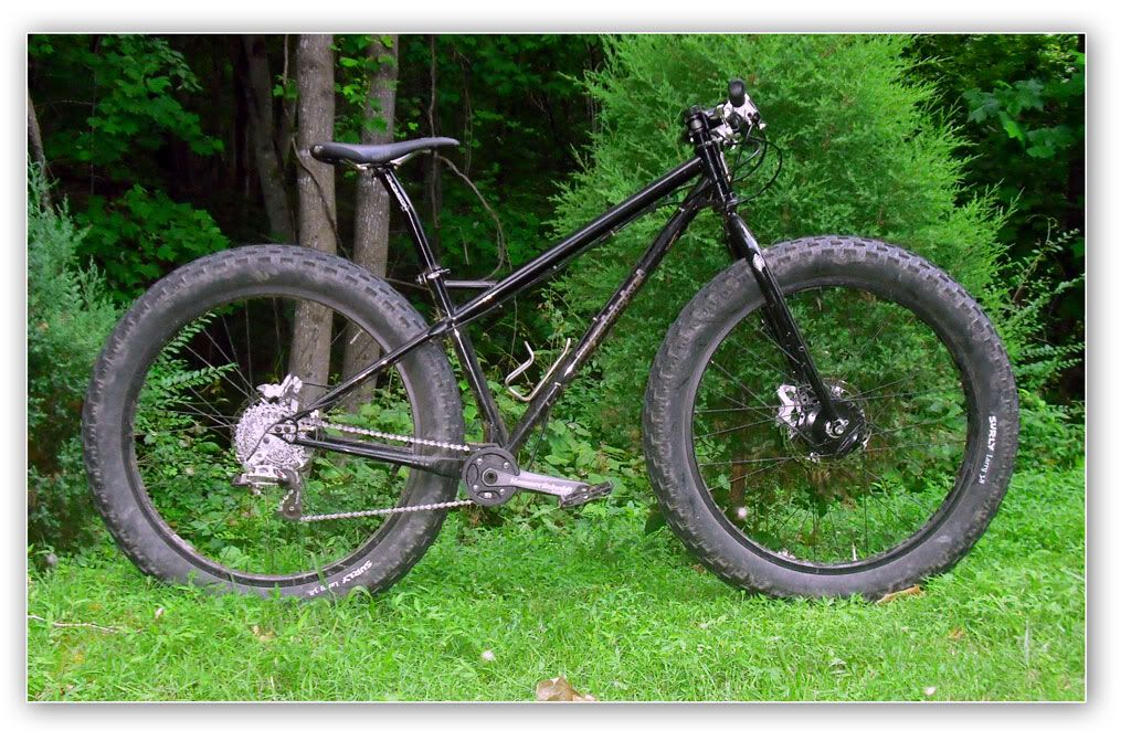

    Symmetrical, 170mm (it says on the drawing), 445mm chainstays.
    But it's just these two first samples. Anything could change. And might/probably will.
    As long as there isn't any huge changes, I just found my next project! This is exactly what I was looking for and has just saved me a lot of time debating some things, thanks guys!!
    I'd be in favor of a slacker HT angle too.

    Just looked closer at the pictures. That is going to be one cool bike!

    3 Q`s......
    1) What is the rear tyre clearance ??
    2) How about calling the UK version the "Dune Surfer" in honor of CK or the "Bog Monster" , in honor of Velobike's exploits in trying to ride through proto Lochs
    3) If you do a `mad` one sided fork , please ensure that it IS really mad with ( dare we say) adjustable clamps to allow better tyre clearance and adjustable A to C

    It's like an Evil Imperial on steroids
  7. #32
    1,292
    WOW! Sure love the look of this one! Kind of has a trials bike look to it aye? Not sure about 71 degrees at the head tube... might be a little steep for snow & sand... nice to be a little slacker on a downhill when the Ft. tire sinks into soft snow or sand... of corse we don't know the effective TT length yet either. LOVE the double TT w/ super low stand over!

    I'm not so sure about a slack head tube angle. I have 69 degrees on my frame and it feels a bit floppy at slow speed.

    Quote Originally Posted by Dr Feelygood ! View Post
    3 Q`s......
    Well, I know Shiggy had me measure my Rolling Darryl/Larry tires and I gave him that measurement to go by several months ago now. Hopefully he "future proofed" it a little bit.

    Very nice, slacker HA please.

    I like the appearance of the toptube....but what I like even more than that is the possibility of greater framebag volume due to the wider "toptube".

    Is it me or is that seat-tube curved or bent, a bit like a Surly Karate Monkey?

    Quote Originally Posted by johnni1968 View Post
    Now where's my cheque book!! :-)
    I see that as well. An attempt at shorter chain stays, I presume.
    EDIT: I see further up now where Brant said the chain stays are 445mm/17.52". Not all that short after all! But then again, for soft stuff, short stays seem to not be wanted.
    I like Shiggy's suggestion that this is a "Rock Crawler", by the way.

    Nice looking frame!!
    I think the oversize headtube will allow a lot of room for people to play with the angleset headset. It is nice to have the option of slackening the HT out or gettting that perfect geometry out of a production bike. It might also be good to change the HT angle for different types of terrain or seasons.

    Very good point, if they went say 70 degree HT angle then we could all tweak it to where we really want it.
    Quote Originally Posted by Guitar Ted View Post
    This is pleasing for those of us that will be using it as a "Rock Crawler" trail machine instead of a sand/snow bike.

    that is one nice frame ...... weight dependant that would be worth changing out the sandman for if its SSable without a tensioner pish ....
