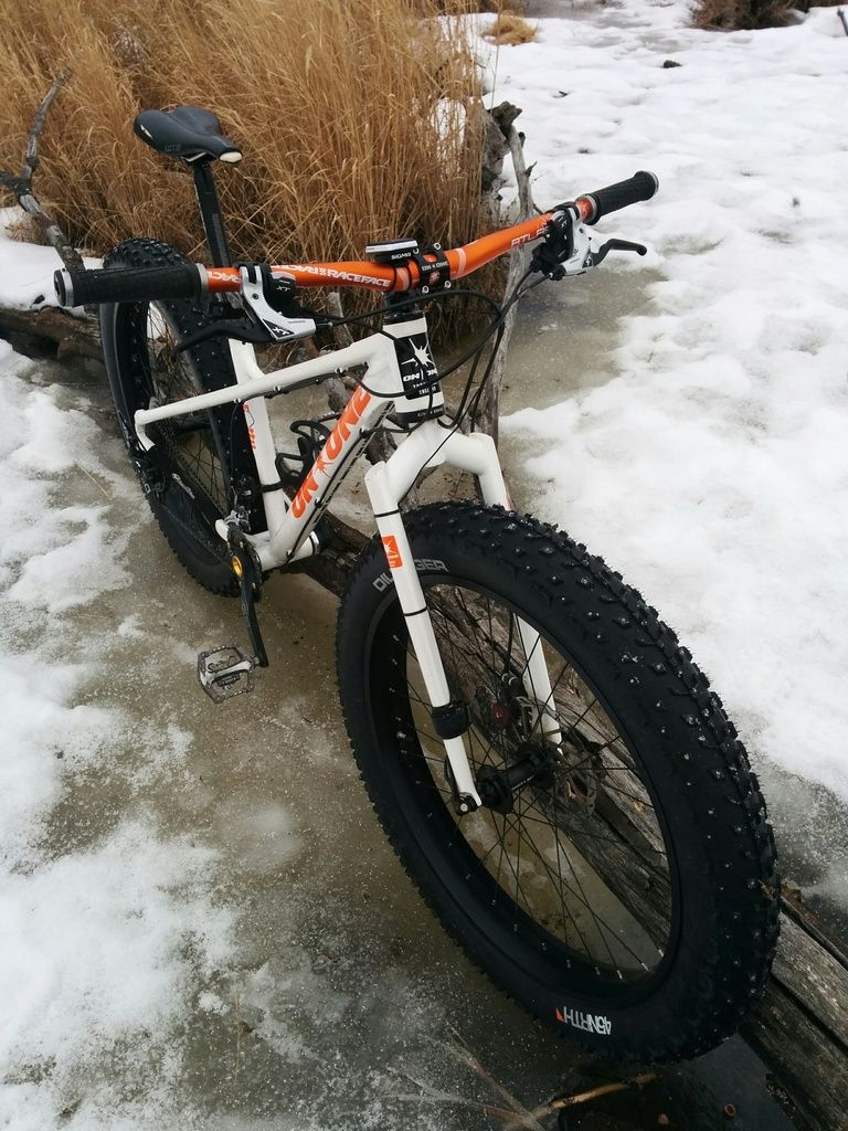

    I finally got some 4.8" Jumbo Jims Lite Skins. Fit fine on the original rims & running 1x10 with tubes for now. At least 1/4" clearance on the chain.

  • 02-01-2016
    blowery
    Awesome, looking at these for my next tires. Glad to see they fit the rear.

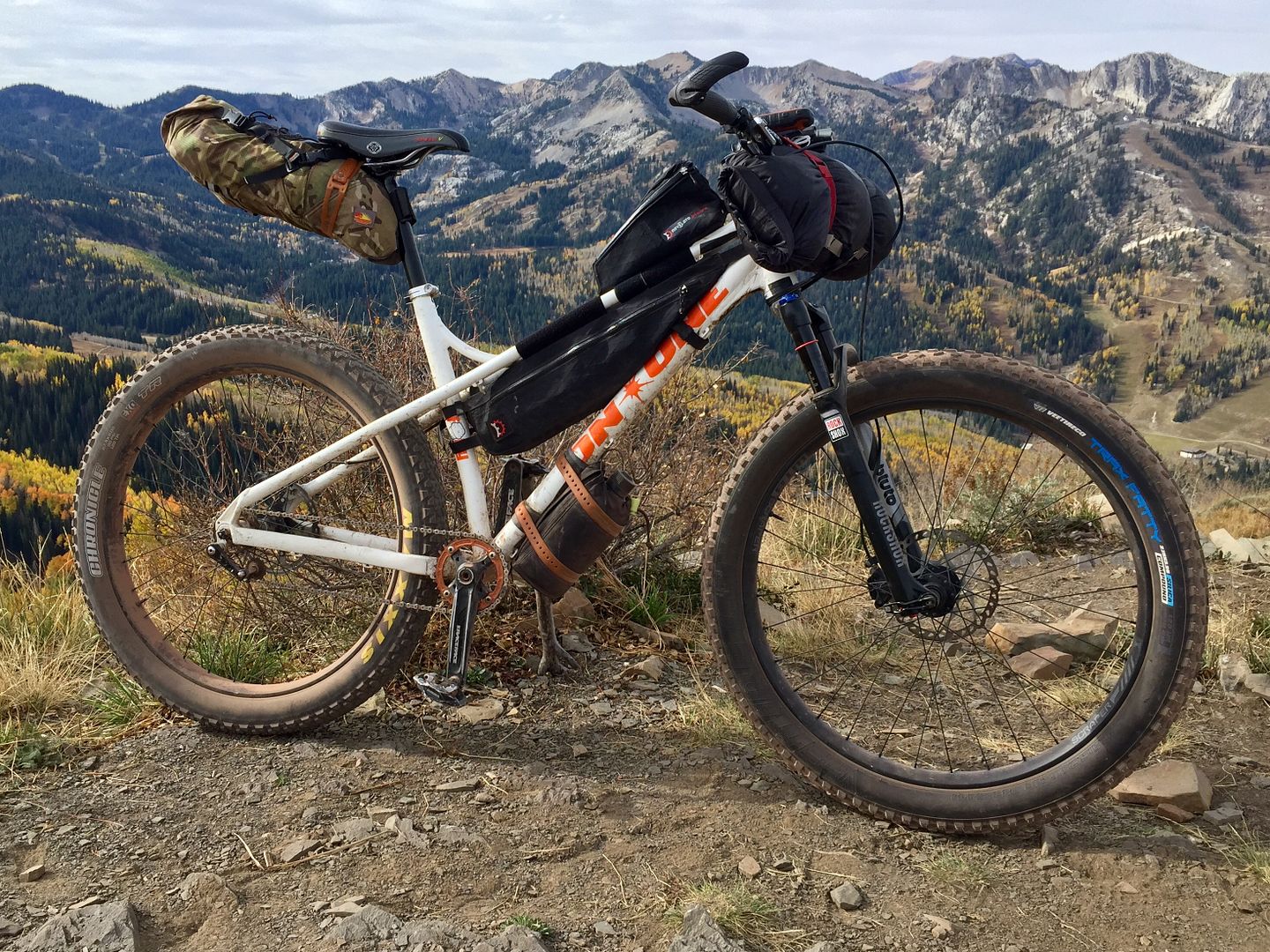

    kryten
    Originally Posted by MTBLoCo29 View Post
    What size frame and what size frame bag is that?
    Iberia medium for me.
    On 18" frame?

  • 02-01-2016
    kryten
    Hmm...I'm thinking I may even be able to fit large Ibera bag on 18" frame? Trying to get this thing ready for bike packing this summer on the cheap.

    MTBLoCo29
    It's a tight fit. The silver piping on the perimeter rubbed down to the metal on the downtube just above the BB. The bag sits right on the downtube, so I would put some protective tape down before installing. Keep soft stuff like spare tubes in the bottom, not hard/heavy stuff like tools or pumps or you can hear them hitting the frame as you bounce down the trail. Attachment 1052364
