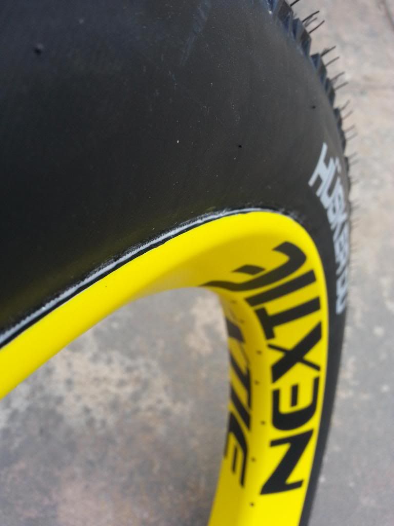

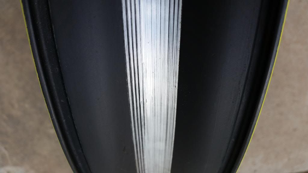

    Nextie-Bike carbon rims-image.jpgStan's valves are what I used and they work great. Also used 25mm Stan's tape to seal the spoke holes.

    On topic - 90s are fat. Very impressed with the quality and light weight of the rim.
    Attached Thumbnails Attached Thumbnails Nextie-Bike carbon rims-borealis-nextie-rear2-medium-.jpg

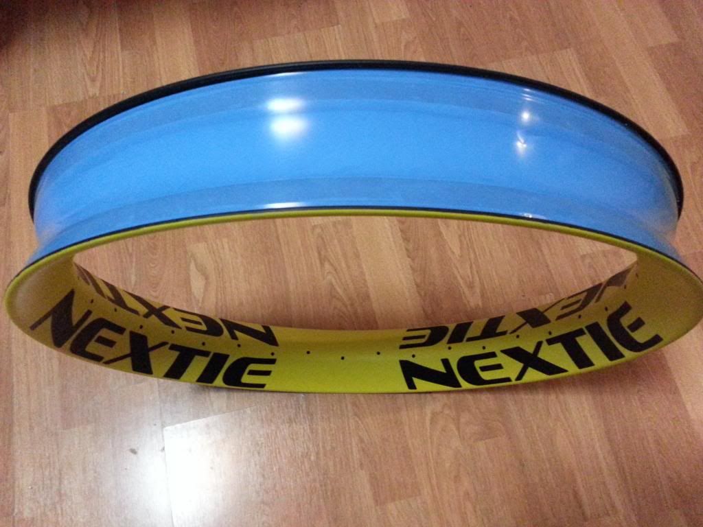

    Nextie-Bike carbon rims-img_2014100710798.jpgNextie-Bike carbon rims-img_201410070921.jpg

    Looks good, are they 65mm inside or outside? Did you weigh them? Looks like 36º is that just an illusion?
    I honestly did not measure or weight them. I believe other guys have put the rim on a scale and most were right around 500 - 520 I think. Paired with a P321 lefty hub & *light* hudu's I'm happy with the weight.
    36º?
    I haven't had my coffee yet....dunno what you are asking here lol.

    Quote Originally Posted by dfiler View Post
    It's been a few weeks since I went tubeless on the 26x90 nexties. So far so good. Stans valves and one layer of 25mm stans yellow tape did the trick. Seriously, nothing else was required!...
    Stoked to read this. How much sealant did you use? I know you wrote nothing else other than tape & valves was required but you must have used some sealant? Type and amount?

    Quote Originally Posted by radair View Post
    Oh yeah, and sealant.
    I think it was around 4oz per wheel, stans. And then I added 2 more oz recently for insurance. Bud and lou fit so tightly onto the 90mm rims that they sealed almost instantly. Burping or accidentally unseating the tire is an impossibility so really the sealant is just for punctures.

    hey all...I ordered some 90mm Nextie rims...is there a consensus on valve stem and rim tape for tubeless set up?
  58. #458
    Fat & Single
    Reputation: ozzybmx's Avatar
    4,103
    Whatever valves fit, I'm running 35mm WTB brass, the void is 20mm so I have a stumpy 15mm poking out... it still works but the 46mm versions would be better.
    YMMV but I would stay clear of alu valve stems, I have personally broken 2 while pumping a tyre up, this results in catastrophic failure of your tubeless setup. Tube in to ride home.
    The bike forums are rife with threads on broken alu tubeless valves, stick to brass for reliability IMO.
    Tape, any tape seems to be the go, from 25mm filament tape that I use to regular stans yellow/blue tape.
    These rims are a no hassle tubeless conversion... just received set #3 for a little project in the works

    Fat & Single
    4,103
    Quote Originally Posted by Shark View Post
    Those gloss rims above look great! I think I made a mistake getting the matte finish....doh!
    I certainly did with the greenies, my matte yellow wheels are 100% still but the green paint was not UV stabilized, seems the strong Aussie sun killed the bling... and were only half way through Spring, they would have been pure white by summer.
    Being looked after by Nextie but I could have done without the hassle as Im a bit time deficient at the moment. Actually liked those green wheels too
    Apparently a gloss coat would have saved the paint... though the speed of the UV damage over 4 months considering we were in winter and the bike is only outside when being used, I reckon it maybe had less than 100hrs in the sun.
    Rims have gone pastel green with patches of white, they could be rubbed down and repainted a different colour, maybe gloss coated over raw carbon.
    Not so good, tired and faded after 4 months.
    Former "in yer face" green...

  67. #467
    115
    That's sad to see. But neon colors usually has a disadvantage. My job sells helmets with neon colors, and they fade in the sun as well. Problem is supposed to be chemicals that are not allowed to use/banned, is what would have kept the color nice.
  68. #468
    Fat & Single
    4,103
    I don't know if they have that legislation in China... If they had any idea this would happen, they wouldn't have painted them matte.
    I see a few others with the same green only it has a clear coat over it, hopefully they do alright in the sun.
    I seen they were fading slightly and didn't mind but 10 days in the Desert and they are now on the brink of turning white.

    My latest build with Nextie 65MM rims with GC 4.6 tires. Custom Quiring frame. Mikesee built the rims for me:

    Looks great Steve! I put in an order yesterday for the 65mm Black Eagle rims with center drilling. Did you guys/gals that got the 65mm rims go with the center or offset? Wondering if I should have done the offset or not.
    Now I need to buy spokes. I've never built up carbon rims before (but I have >50 aluminum rim wheelbuilds under my belt), so I have a few questions:
    1. Do I need nipples longer than the standard 12mm ones?
    2. Do I need some sort of washer to go underneath the nipple?
    3. Are there any other considerations when building up carbon rims compared to aluminum ones?
    I used Freespoke to calculate the following spoke lengths, and wondered if someone can let me know if they are way off or sound right
