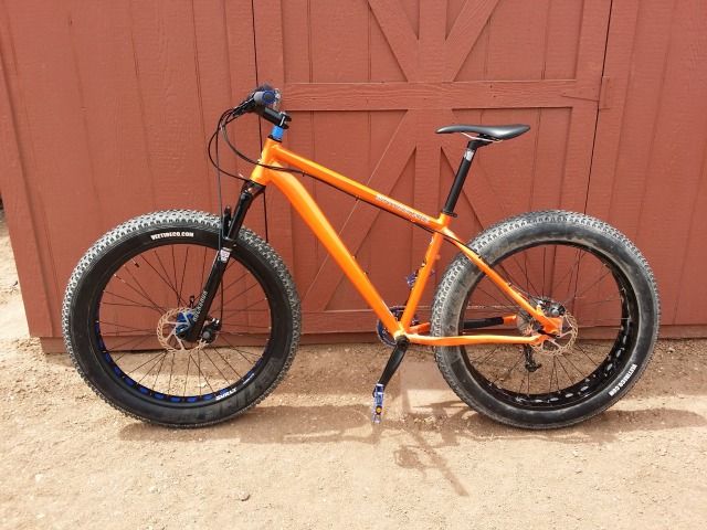

    I decided to give one of these a try.
    So far so good. Went with the 3.0 model, I believe it is a very decent bike for 900$. The frame design is very cool. I don't particularly like the post mounts for the rear brake, but this seems to be the way bike manufactures are heading.
    Size 17 came up with 35.2 lbs on the digital scale with pedals out of the box. As shown, the bike is around ~33 lbs (10 speed, lighter tubes). I live out west and bash around in the rocks. Definitely a work out, but lots of fun and the thing feels indestructible.
    Could easily be a 30 lbs bike if kenda would hurry up and release those Juggernaut pro's already :-)
    update on the FB5.
    I got some upgrades for the bike and some insight for others considering the bike.
    The stock wheels are uhh, crap :-). Double wall rim weight, 1300+ grams , plus they are poorly assembled. I trashed a few spokes riding cross county in the desert so I decided it was time to upgrade the wheels. I have hope fatsno hubs and marge lite rims arriving Monday. I also ordered a bluto fork to try out.
    The crown race was damaged during removal from the stock fork.. so no biggie right? I'll just upgrade the headset right? Wrong. It looks like motobecane used a frame specific headset on this bike. Standard headsets won't fit.
    I've contacted BD on getting a new crown race replacement to go on the bluto.
    Aug 2014
    104
    Have you ridden fat bikes before this? I'm waiting for my first fattie to show up next week. I went with a Framed Minnesota 2.0. How do you like the 1x set up? I run that on my fs bike, it's the only way to ride in my eyes. That looks like a 36t nw. Have you run into any instance where you would prefer the granny gear? I never do on my fs, just wondering if I should go with it for this. Always love input! Good riding!
    Mar 2015
    6
    Yeah not ditch the front derailleur and granny gear for sure. Absolutely not necessary, on any bike, for any kind of riding
    I wanted to further clarify my frame headset problem. I contacted bikes direct and disappointingly they were of zero help, nor do they sell replacement parts for this headset. The actual headset on the FB5 frame uses press in cups with some el' cheapo cage bearings. From my correspondence with FSA, it appears the only name brand part of the headset maybe the FSA top cap.
    The inside (bottom) diameter on the FB5 headset measures 52mm across. Additionally you can only insert about 8mm before the headset tapers inwards. The only headsets I can find in 52mm are integrated style (sealed bearings, angular contact). They may work, so I ordered a cane creek bottom IS52/40. Even stumped the local bike shop as they don't know of any headset that will work on this frame...

    Mar 2015
    6
    Hey guys, an update on the bike for anyone who is still following this.
    Got a bluto on the bike finally. Had some problems, the bluto with remote lock will not clear the frame. Ended up using the 3d printer to make a crown race spacer (2.2mm). Seems to be OK, the headset is still giving me some trouble. Man the bluto is sweet, and lacing up some decent wheels on this bike saves HUGE weight. Bike actually lost weight adding the bluto and redoing the front wheel. Bike is ~33.8 lbs right now. Will be in the 32's when the rear wheel is done.
    Will ride the heck out of this bike until the headtube fails or something brakes then move components to a better frame

    My frame cracked, at the seat stays, just below the welded brace.
    I contacted Bikesdirect and they offered to warranty/replace frame. But after the costs of paying to ship the old frame to them for inspection/paying to ship the new frame to me/costs to have old parts removed at bike shop/cost to have parts installed at bike shop/and costs to replace any non compatible parts between the frame I figured costs around 350-500 bucks. Seemed like a lot to replace a warranty frame.
    I haven't sent the frame in yet. Not sure what I'm gonna do. Might just save up for a new bike.
    Was a good bike before that...except my rear hub was failing (hub body cracked causing one of the pawls to not stay in place), the stock brakes suck (replaced with shimano hydros), the headset sucks (when I took it apart I found the lower bearings in 3 pieces).

    How many miles did you have on your frame and how brutally do you ride? I've ridden mine for 1200 miles of gnarly singletrack so far and it's still good as ever.
    Squ-eti
    Reputation: mccartney7499's Avatar
    264
    I had 1250 miles on the frame when I noticed the crack. I bought it mostly for riding in snow, but ended up using it year round. I didn't ride it anywhere, on anything I didn't think any bicycle I've ever owned could handle. Crap, I've got a Yeti ARC from 1999 that I've ridden a lot harder for a lot longer, and it's still going strong...
    For the record, I loved the frame...if I could pick up another FB5 frame, or Fuji Wendigo frame, or SE F@R frame I would in a heartbeat. Great geometry, fit me like a glove...I am the sadness
