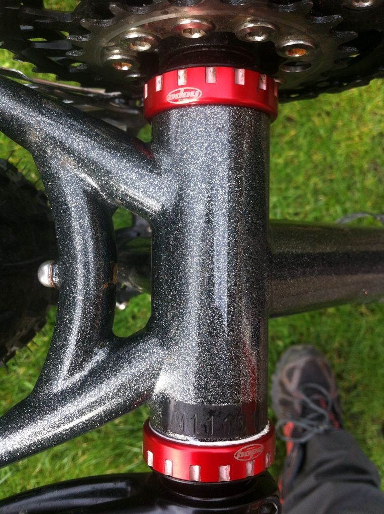

    I used the Hope BB on my Moonlander and modified a CK center tube to fit it, King makes the center tubes to fit their stuff only without tweaking it.

    Jan 2013
    101
    I changed the factory out to a Hope unit and all is much more gooder.....
