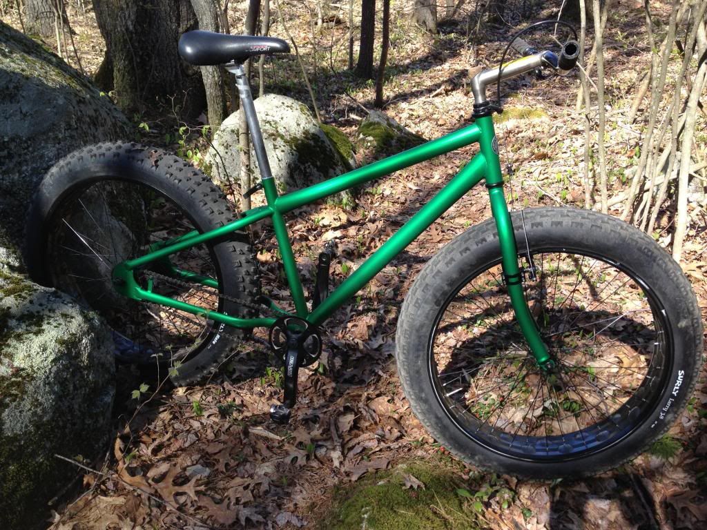

    Yup, right at $400 for my build:
    Vee Rubber 26x4 Mission tires
    Surly fat bike light tube
    Gusset Stash 680 handlebars 31.8
    Shadow Conspiracy Ol' dirty flange grips - clear
    FFS 120mm stem (to compensate for the swept bars)
    Zoom 1 1/8" threaded to 1 1/8" threadless adapter
    Cane Creek 27.2 - 28.6 seatpost shim
    Kalloy SP-342 Uno seatpost 27.2
    WTB Rocket V saddle
    Vuelta cranks 175mm
    Vuelta flat chainring 32t
    20t rear cog
    ACS Crossfire chain 3/32"
    Gusset Slim Jim HL platform pedals - clear/red
    Custom "Fat Goose" decals

    Nothing dramatic, basically a stock ride with new grips, pedals, saddle, an Endomorph on the front end. But closing in on 75 miles of winter trail/street riding and still holding in there! Looking forward to enjoying some snow free trails!

    Okay took the time to try to carve some weight off. Headset converter, alloy bars, crank arms, 32 tooth front, retained stock rear. Surly 120 tpi front tire, stock rear tire. (Origin8 Devist-8er 120tpi on order) Stock tubes. Still at 41lbs, so far all from the parts bin, only cost at this point the Devist-8er and some grips for $70.00...
    Thing is still insanely fun to ride, had gotten so used to the 36 tooth, swapping to the 32 tooth should make it even more fun on the trails!
    Mongoose Beast modifications-walgoose1.jpgMongoose Beast modifications-walgoose2.jpg

    They were a random combination, but ended up being a nice fit. I swapped to a shorter stem but ended up going back to this one.
    So, I removed the cranks and the weight of them almost gave me a hernia. They must be that new lead/steel alloy. I had an old triple lying around so I removed the outer two rings. So now I have a 28 by 19. For riding on the beach I might go lower. Clipless pedals are OK for the beach bike that it is. The 17 Inch rise handlebars are new and add to the ridiculousness of the whole thing and making it look like the goose that it is. A Cane Creek suspension seatpost adds to the WTF factor and coupled with big soft tires gives a soft if somewhat bouncy ride.
    It doesn't like it's picture being taken and so was warping time and space in defense as I snapped the photo. Thus the strange colors. I'm not kidding.
  84. #284
    2,033
    ^^^ Warping time is the replacement for warp speed.
    Nice ... It would actually look good painted that way.
    Yes: Those cranks are ridiculous.... people make fun of the wheels/tires being heavy as boat anchors etc.... I think these cranks really are so heavy they could serve as a small craft canoe/kayak anchor. Tie a rope onto the pedal hole drop anchor and let the chainring ramps grip something. Argh!
