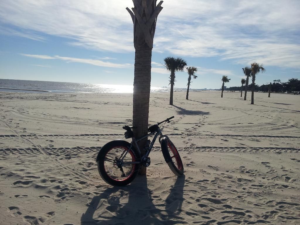

    The Minnesota 2.0 does just fine in sand. I rode a few miles in the sand yesterday. Today will be trails. Tomorrow will probably be mostly road. I love the versatility of this bike! Is it light...not no but hell no! Part of the reason I ride is to get in better shape, and I feel that this bike is a good tool for that goal. When I want to go fast, I have the light road bike for that.
    Here is the gratuitous beach pic. I did OK with the out of balance wheels and even though the wind made the 65 degrees a tad nippy, I had a fleece top I got a Walmart off clearance for $5 that kept me warm enough!
    Gotta go get dirty!
    Galen
    Edit: I hate not knowing the location I am viewing. This is Gulfport, Mississippi.
