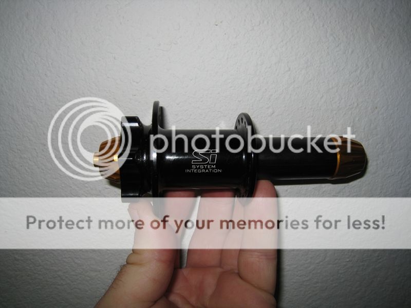

    Cool tool! But: "For thru axle hubs greater than 135 (142, 150, 157, etc) in the TS-2.2, use the TS-2TA Thru Axle Adaptors."
    It looks like you could replace the threaded rod with allthread to go to 170/190, but you would need a (simpler than the one I made) spacer of either 25mm or 56mm to match.
    Has anyone used this with a Lefty hub? Given that the Lefty bearings are different sizes, and this tool used cones to hold the hub - would it hold the hub centered? The instructions show setup for a Lefty - and the "Stop Nut" (big black spacer) is outside the truing stand arms.

    I have used it with a lefty hub. That's why I showed it. It uses tapered cones on each end. It fits the different Lefty bearings perfectly.
    Also, so far, I haven't needed the extenders on my TS2 yet. I regularly build 170mm fat bike wheels.
    We'll see what happens next week when I start on 190mm hubs.
