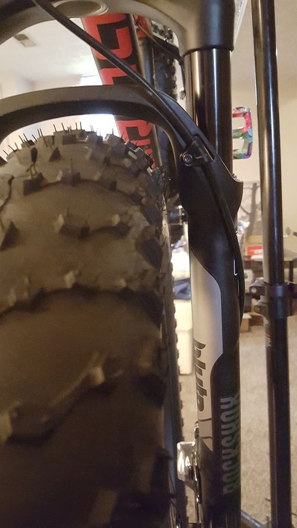

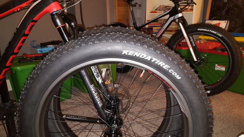

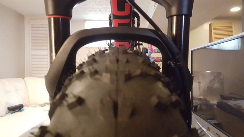

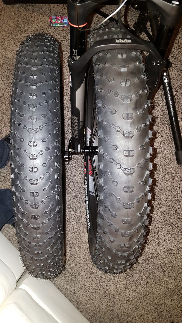

    Haven't actually measured yet, but you can see the size difference in these quick pictures. Everything about the 4.5's are super-sized compared to the 4.0's. Will measure later for exact comparisons. BTW both tires are mounted on the same exact Sarma Naran 80mm rims.

    Quote Originally Posted by RENCRN8 View Post
    Thanks for the pics! Are the 4.5's a thicker casing or rubber. 600gr more seems like a lot for half inch gain, especially when JJ are only 200gr for the bigger tires (quoted weights).

    4.5 Pro's on 80mm rims
    108.5mm casing width
    111.3mm knob width
    Approximately 31" total diameter to edge of lugs
    4.0 Pro's on 80mm rims
    102.5mm casing width
    92.3mm knob width
    Approximately 29" total diameter to edge of lugs
    111.3mm knob width
    92.3mm knob width
    2" bigger diameter wow- that definitely would be noticeable. Do the 4.5's clear the Bluto arch ok or is it a tight fit?

    Quote Originally Posted by Paochow View Post
    Fits fine.
