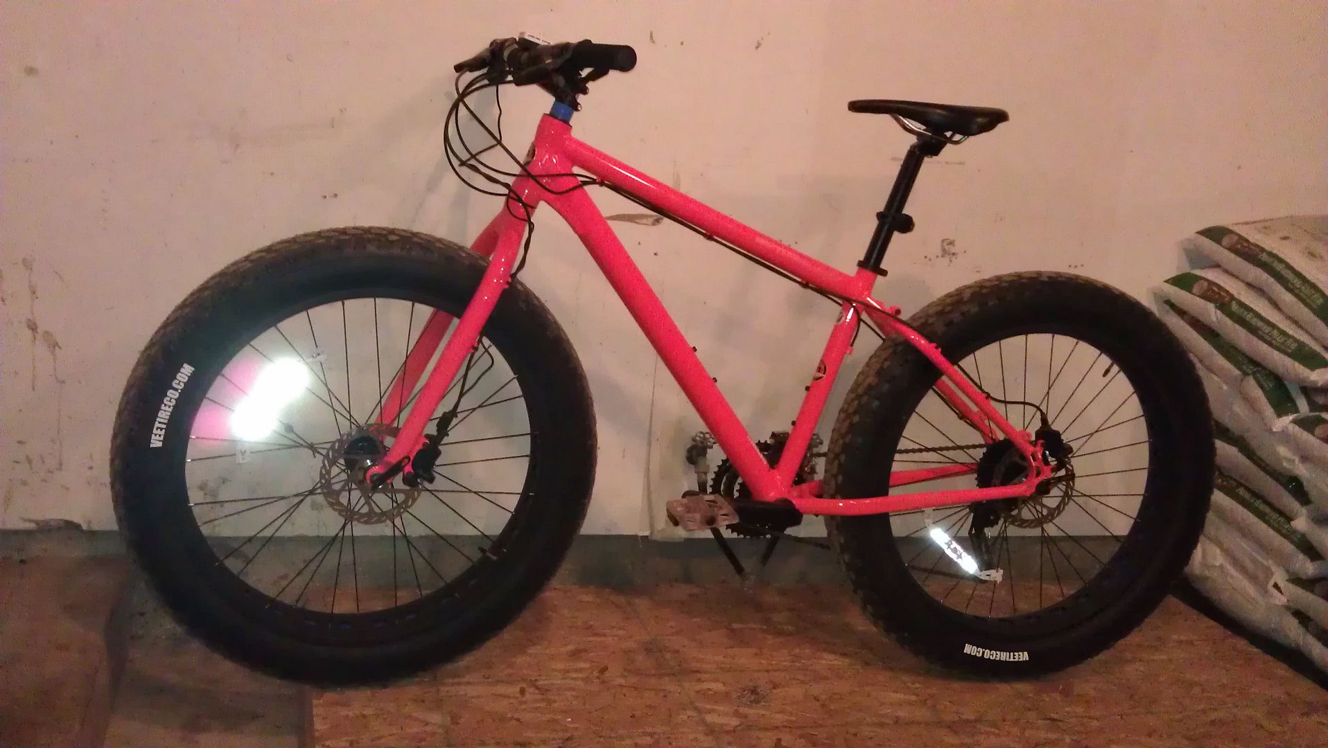

    Here is his Moto;
    After riding this, I was sold on the whole "fat is fun" thing!
    Before that I had talked THREE customers OUT of going full-fat. (sorry guys).
    JM

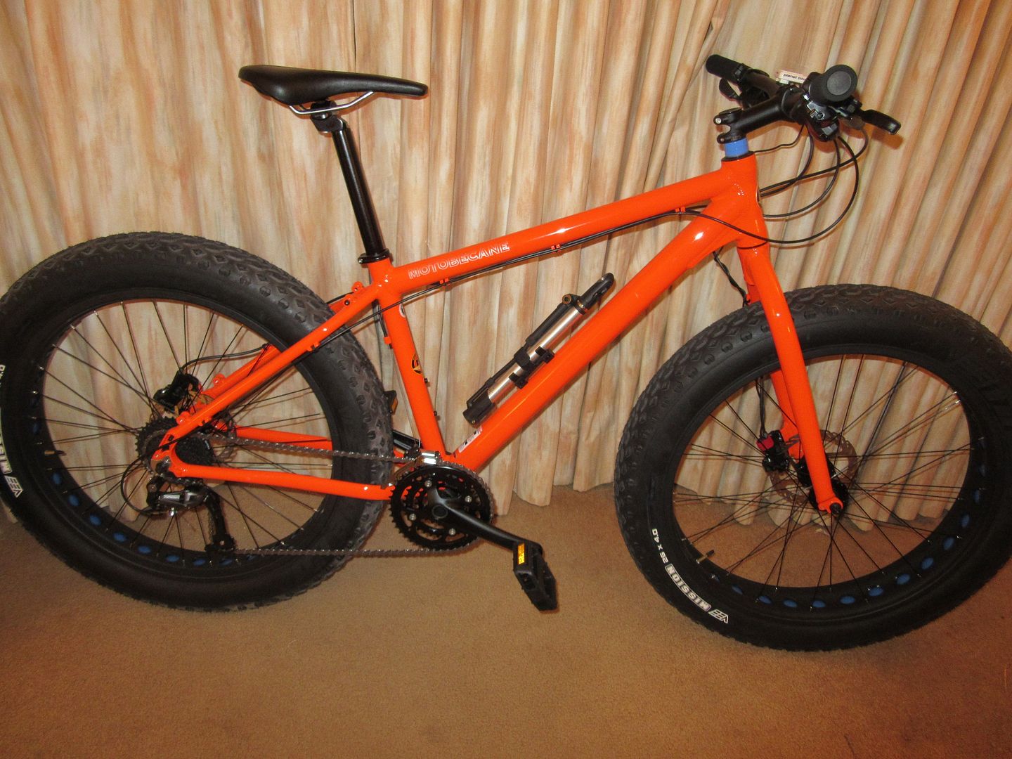

    Second shot looks pink?
    He must have sent me the first one as I do not recognize the background?
    JM
