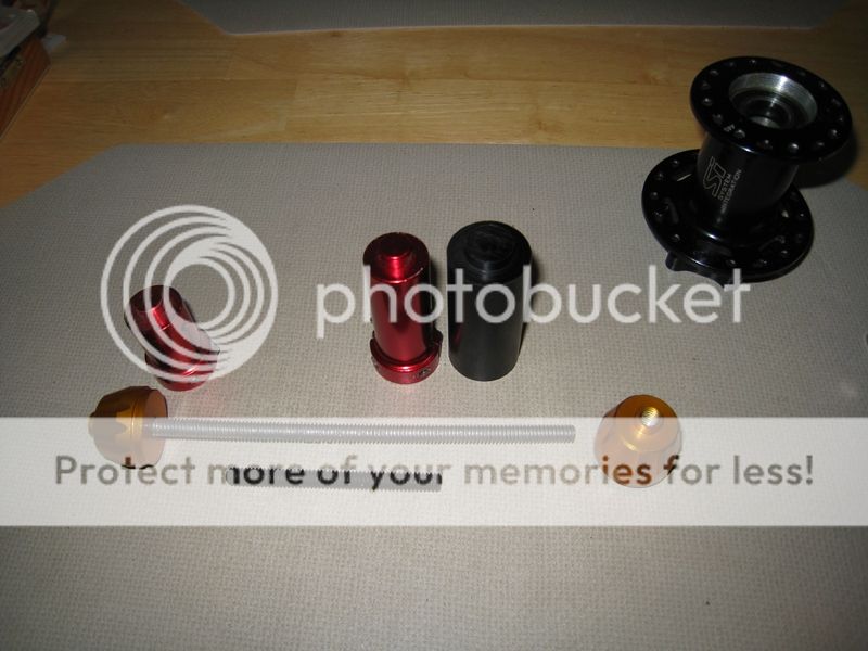

    There is only the Lefty hub (available from several vendors - Cdale, P321, I9....) But you lace it offset. Pugs & Moonie come with red offset build adapters. Lefty hubs have to have an axle-equivalent adapter to be built up. I tried building my Lefty hub with the Cdale adapter+Pugs adapter stacked, and it worked okay but did not have enough offset to clear the Lefty. Trying to stack the Cdale adapter with a Moonie adapter (56mm!) was too much - hard to keep it square, so I just manually offset it in the stand. The tire would still rub on the trail, so I finally put together a proper build adapter:
    A Project 321 Lefty hub adapter, with a longer threaded rod and a 56mm spacer.

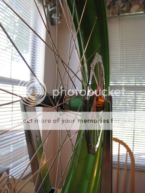

    Here's the wheel in the stand
    It's cross laced, but that's a finicky thing. Lacing offset to the rim using only one row of holes works fine.
