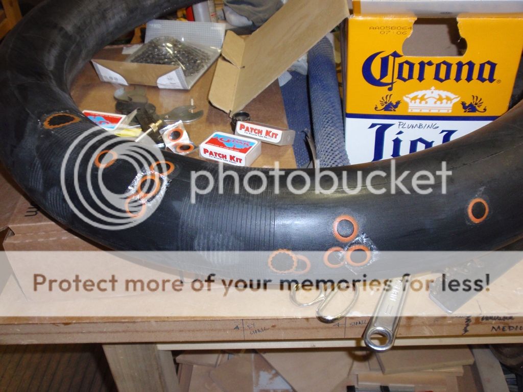

    I've patched lots of fat tubes. I'm pretty sure my GF's Pugs is rolling on tubes with patches that are 2-3yrs old and going strong.
    There's nothing particularly tricky about patching a fat tube as long as the weather isn't too gnarly.

    Quote Originally Posted by crashtestdummy View Post
    And I think that you are totally wrong.
    +1 - LOL - love that photo
    My trail bike is tubeless, but on my MTBs with tubes I have a fascination with how many times you can patch a tube and keep 'er rolling. I don't get a ton of flats so I can't push things too far.

    Quote Originally Posted by RossJamis View Post
    What patches are these? I used the park brand for years with no issues now last year I couldn't get one to hold air for nothing..
    I have found that the best patches are Rema. They are the ones with the saw tooth edge. The others are probably Sunlites. They work, but the Rema's seem to have fewer issues. The main thing to do is to abrade the tube surface well. This cleans it, besides giving the glue something to attach to.
    +1, and on the Rema patches/glue, been around forever 'cuz they "just work". I've always re-talc'd the tube after patching, a little baby powder on top keeps friction from rolling up the patch. Probably much less of an issue with fat tubes. Also, +1 to the notion of swapping tubes on the ride and patching at home.
