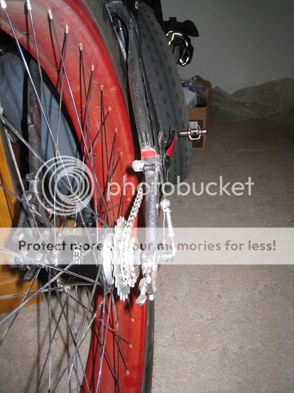

    258
Size:  66.5 KBThat was my FG before the tire. And with the tire,Name:  100_0212.JPG
Size:  112.6 KB Not much room, but it works.

    wadester- I was looking through this thread and saw your photo of your unicycle with fatties. I also read that you are just learning. I have been unicycling for many years and a few years ago I ground out my frame to fit fatty (3.8) on my 44mm rims. The first tire I put on was my endomorph and it really sucked. The 'self steering' is almost overwhelming with those tires on a unicycle. I swapped out for the Larry's and it was way better. I ride trails and beach with mine and it has made an incredible difference since I upped the width from my original 3.0s. Anyway, for what it's worth.
    Mjölnir of Bjørn dot com is my active website.

    Still going with the Moonie frame? Not a lot of options. I know that a MrWhirly on a Pugs width spindle interferes with the chainstay (frame tube from BB to rear axle), and I don't mean rubs or hits - I mean wants to be in the same space. The Surly OD crankset comes in Moonie width, but you get 58mm and 94mm BCD 5 bolt chainring mounting.
    Looking at Surly_Crankset_Dimensions.PDF, I see Q (crankset width across pedal mount surfaces) of 197mm for Pugsley vs 212mm for Moonie on Whirlys, and 200/214 for OD's. 197mm Q and a 13mm thick arm wanted to be where the frame is, but 212 Q (7.5mm further out on each side) clears.
    SRAM X9 fatbike cranks are:
    W4=88mm. Surly Whirly/moonie equivalent would be 212/2-13=93mm Pugs would be 197/2-13= 85.5mm
    EThirteen XCX fatbike cranks are Q=198
    There are some other cartridge BB type fat cranksets, but I recall them at Pugs width as well.

    Hmm.
    So the distance from the centerline to the inner surface of the crank is 93 mm for the Moonlander and 88 mm for SRAM fat cranks.
    I measured 7 mm space between the cranks and chainstays on my Moonlander - both sides.
    So the SRAM fat cranks should leave 2 mm on both sides. It's a bit too little clearance for my taste, but better than Pugs-width Whirlies.
    With a GXP300 I've understood there's no possibility to add any spacers to make things a tiny bit wider. Could someone confirm this?
    The cranks could be filed if they rub the chainstay.
    It's also possible to give the chainstays a few whacks with a hammer to make more space for cranks.
    Easy and advisable? No.
    Possible? Definitely, says Gyro Gearloose.
    Probably the easiest way would be a custom inner chainring: 58 mm BCD, 30-something tooth count and four extra holes to mount the outer chainring. The outer would be a regular MWOD chainring. Basically the same as MWOD chainrings, but a larger inner chainring.
    I'll have to contact a person I know. I have a custom made cog on one of my bikes. Say I have ten of these made, I'm sure I could lose the nine I don't need.
