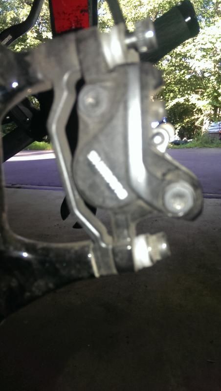

    I just picked up a 100mm Bluto and my 203mm rotor won't clear with the adapter that came with he carbon rigid fork. Do I need to switch rotors or is there a larger adapter I should use?
    2017 Bikey McBikeface Carbon
