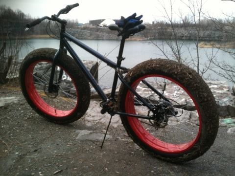

  5. #205
    64
    Wet Ride - 27Mar14 - Bitterroot Valley, Montana
    I tried to go where "the deer (but no antelope) play" - was a "no-go" for the sage-brushy/rocky/steep stuff... I ended up staying on roads & an ATV track for the ride. About 45 degrees F. Rainy & sleety ("graupel" here in Missoula...) Tires were at about 16 PSI. Saw a fox, several mule deer, ospreys & hawks. Some Bob-whites... Sunny when I started but the left side of my head was numb by the time I got home - wind from the SW & rainy...
    The Dolo in the (semi) wild - Mongoose Dolomite-wetride-1of6-27mar14-.jpgI couldn't make any headway as there were too many rocks hidden in the grass. Also it was real steep here. (I needed a lower gear yet than what I had with the Shimano Magarange (13-34) freewheel and the 28-38-48 front chain-rings.) I was trying to follow the mule-deer & elk trails on this hillside near Iron Cap on the east side of the Bitterroot Valley.
    The Dolo in the (semi) wild - Mongoose Dolomite-wetride-2of6-27mar14-.jpgLooking South over Iron Cap. About 45 degrees F, windy with mixed rain and sleet ("graupel" here near Missoula, MT). I'm panning left to right in the following pics...
    The Dolo in the (semi) wild - Mongoose Dolomite-wetride-3of6-27mar14-.jpgNow looking S, SW over Iron Cap.The Dolo in the (semi) wild - Mongoose Dolomite-wetride-4of6-27mar14-.jpgLooking west
    The Dolo in the (semi) wild - Mongoose Dolomite-wetride-5of6-27mar14-.jpg Now oriented North West... that's the "Big Ditch" at the bottom of the pic. Irrigation system on the East side of the valley - dry this time of year.
    The Dolo in the (semi) wild - Mongoose Dolomite-wetride-6of6-27mar14-.jpg Looking East toward the Sapphire Mountains... tires for this ride were at 16 PSI. (contributed to my issues on the rocky terrain - wanted to "bounce" off rather than conform & climb over!)
    The Dolo in the (semi) wild - Mongoose Dolomite-wetride-ditchrd-27mar14-.jpg Looking East down the Maintenance road along the irrigation ditch (gated road, so no vehicular traffic...)
    The Dolo in the (semi) wild - Mongoose Dolomite-wetride-end_of_rd-27mar14-.jpg End of ride. It was too wet to shear any more sheep today - so "played hooky" while the wife was in town w/her mom. Cold, hot & sweaty - all at one time! (My wife asks me "Why is this 'fun?!?'")
    Last edited by rotaidalg; 04-03-2014 at 10:32 AM. Reason: Add text from photos to body of the post

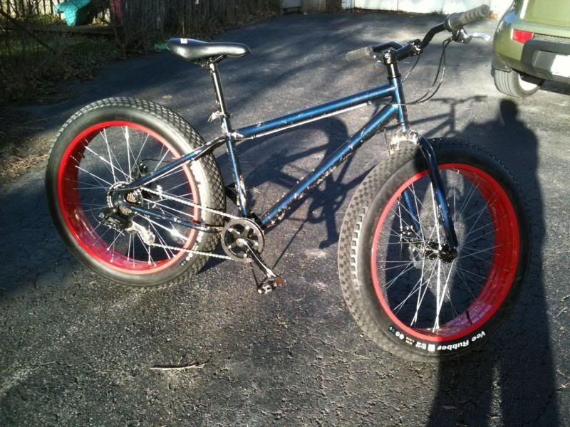

  27. #227
    64
    New Mission Vee-8 Tires mounted on my 21-speed Mongoose Dolomite - 04Apr14
    Well, here is the Mongoose Dolomite in its "sveldt" (or "svelte"...) configuration... (yea, Riiight!)
    I'm running 14 PSI for now - I noticed these are much more flexible, so I may drop to 12 or 10 PSI as I get more time on them... (what is it w/me and my photo captions! Ignore the double ref to the rear rim on the pic!) :\
    The Dolo in the (semi) wild - Mongoose Dolomite-htcomparo-stock-mssnvee8-04apr14-.jpg
    Here is the rear rim with the Mission Vee-8 tire mounted - compared to the front rim with stock tire still on - there's a difference in height!
    The Dolo in the (semi) wild - Mongoose Dolomite-wdthcomparo-mssnvee8-stock-04apr14-.jpg
    Here you can see the difference in the width between the same two...
    The Dolo in the (semi) wild - Mongoose Dolomite-mssnvee8-msrdwdth-04apr14-.jpg

    Here is another dolomite I did for a friend today:
    It's strange how inconsistent these bikes are. I have done a few now and this one felt really really nice, like a much higher end bike. Others felt like a walmart bike.

    Quote Originally Posted by blown240 View Post
    That looks great! What method did you use to paint it? Any upgrades or is it all stock?

    Quote Originally Posted by Bearhunter View Post
    Bone stock except the paint. I just stripped the frame down, steel woolen the clear coat a bit, and spray bombed it. It has about 4 coats. Time till tell if it hold up...

    The DOLOMITE in the Wild
    couple pics of my gateway bike
    swapped tires/tubes , drilled the rims, added a take off crank (22/32), ebayed direct mount derailleur/thumb shifter/PS adapter, and found some red flare.
