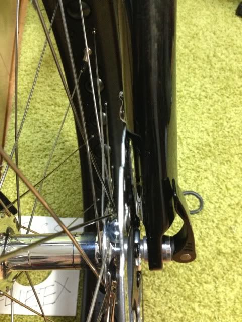

    so I'm having so rotor clearance issues with a 180mm Deore XT ice tech rotor with a Paul Components WHUB
    anybody else had this problem with this fork? I emailed Carver as well as the distributor here in Japan but idk whats going on... maybe I'm just doing it wrong

    well just got word that the fork isn't really set up for a true 135mm front spaced hub so with the WHUB it's going to hit no matter what
    time to demand a refund.
    thanks for the help guys

    I highlighted that info because it's designed to work with a 135mm front hub like the WHUB. The included spacers are to push the rotor out more when used with a rear spaced hub.
    The shape of the fork, however, only gives enough clearance for a 160mm rotor. Is a 160mm rotor not an option?

    I run a 183mm Hope Floating rotor on a Hope Fatsno hub (on both sets of wheels). The combo on its own wasn't over far enough for the caliper so i added the supplied 5mm spacer then it was too far.
    Bought 2 x 2mm disk spacers from hope and added 1 to each front wheel and they fit in there no problems.
    The reason they say 180mm limit, is because the force applied to the fork when braking using a large rotor, nothing to do with the disk not fitting in. I could fit a 203mm very easily.
    Your issue is completely different. Your hub is pushing the rotor too far over (without the spacer) so you need to reduce the rotor mounting surface somehow.

    I really liked the performance of my Carver carbon fork. I used it with a Salsa and a Hope Hub in conjunction with a White Brothers adapter. When I went finally put my Hadley (front disc spacing) hub into service, after removing the adapter, I had an interference issue. The Hope and Salsa were very close with the 5mm Bikeman adapter, one more than the other and I can't recall which one now. The guys at Bikeman were super great to deal with and let me return the fork.

    All you need to do is add a 1mm spacer on the axle

    As tight as that looks with the front spacing hub, it should work with no spacers on a rear spaced hub.
    Maybe you can dish the wheel over and move a spacer from the right side of the hub to the left. I don't know what the axle configuration is though

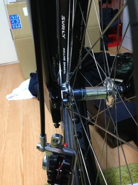

    i don't know I'm just leaning towards returning this an ordering a snowpack
    I changed the rotor for a spare and it now clears the fork but with maybe 1mm of clearance (which I'm not comfortable with)
    also the 160mm rear adapter has the xtr caliper hitting the frame... great.

    A while back it was common practice to get a Hope Floating rotor to fit in a Fox fork, we had to file the thick white paint off the bottom post mount as the alu spider rubbed badly on the post and stripped the paint off marking the floating ano'd spider.
    If you have 1mm clearance and are happy with the rotor it will work no worries.

    My rotor was making contact down by the top barrel nut, same setup as you, .5mm spacer on the end of the hub did the trick. I have two wheel sets, both are WHub, one is fine the other needs the spacer.

    "also the 160mm rear adapter has the xtr caliper hitting the frame... great."
    Don't hate on me for asking, but you are using a post adapter? 180mm?

    this is what Davis Carver told me
    "Thanks. For some reason, we see this occasionally with the Paul Whub.. It is perfectly OK to file the fork a bit for clearance. It won't affect the warranty. Other riders have also inserted a thin axle washer on the disc end of the hub to space it a bit farther from the fork."
