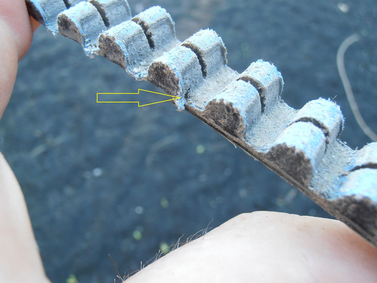

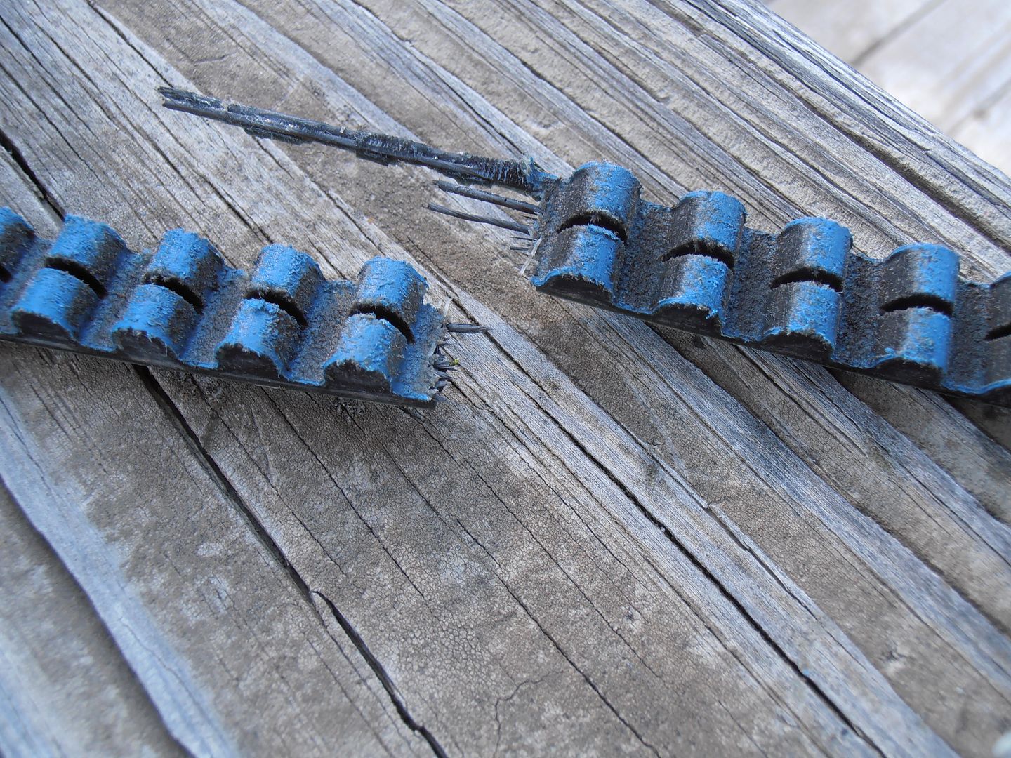

    When I last signed off I promised that I'd report back in year's time but seeing this thread I figured it might be time for an update.
    After almost 2 months of fairly abusive riding the first belt broke while I was hammering up a grade:
    On closer inspection it appears that something may have cut the belt from the inside (sharp rock or a piece of glass?) and damaged a couple of the carbon cords:

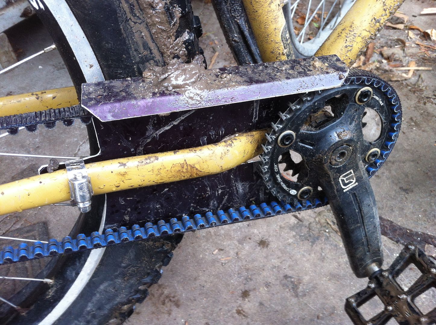

    Since the bugaboo of this belt has been getting crap caught in the cogs I fabricated a "moto-style" belt guard:
    3 months of riding since; no problems.
