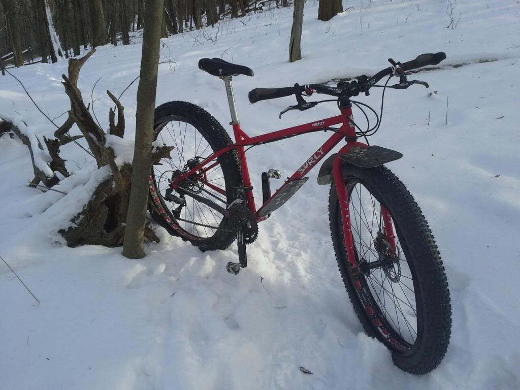

    I gave the krampug on try in the snow.
    Not so good in the snow but it ripped on hard frozen ground. I am looking forward to putting dirt miles on this setup this summer.
    Frame clearance can be an issue at the chain stay and seat stay bridge. I had to shave my front derailleur a bit on the pug.
