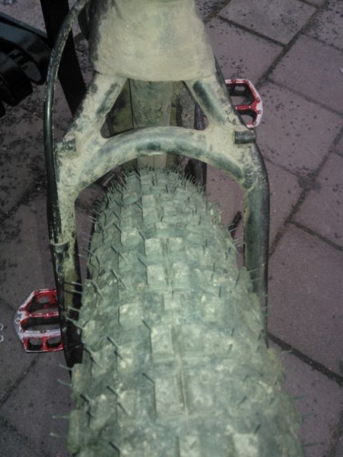

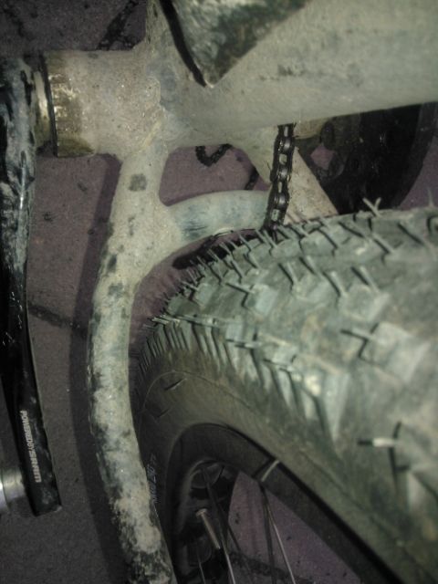

    I was curious and bored, so I tried putting my 29" Knard on Rabbit Hole rim rear wheel on my wife's XS 170mm-rear 907, and there is plenty of clearance to the stays and bridge. The closest point I could measure between the tire and frame is ~14.5mm

    Is that a regular geared 170 or the single speed with sliding dropouts?
    Lord Thunderbottom
    Reputation: TitanofChaos's Avatar
    905
    Quote Originally Posted by Tjaard View Post
    I see a derailer cable on the right side seatstay
