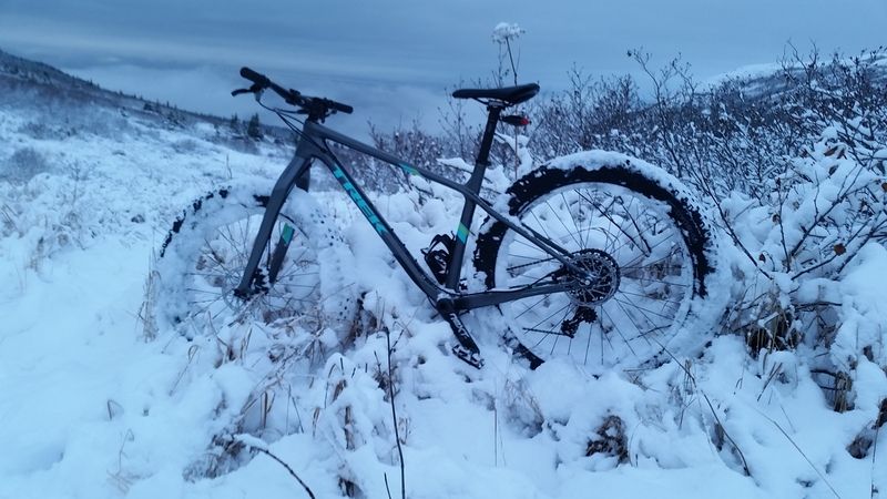

    First impressions of 27.5 Hodags.
    I got a set of the 27.5x3.8 Hodag tires yesterday at my local Trek dealer. I set them up tubeless on a pair of 50mm LB carbon rims. The tires weighed 1262 and 1269 grams. On the 50 mm rims at 20 lbs of pressure, I measured the width at 3 3/8 inches between the knobs and 3 5/8 inches at the widest knobs. The bead to bead measurement was about 21 cm.
    The size of these tires seems like a perfect summer/packed snow tire. The profile on the 50mm rim seems really nice also. I haven't had a chance to ride them yet since it rained all day in Denver.
    They seem extremely heavy though with a very solid sidewall. I am replacing some 3.5" Fat b Nimble tires. The FBN seem like a paper thin sidewall compared to these tires. I used the FBN all summer with no issues, maybe I have just been lucky. Maybe the Hodag is a bit of overkill? The FBN were 741 gms vs the 1260 gms for the Hodags. That is pretty significant. I liked how fast and light the FBN felt, but wanted a bit more volume. I an curious to see how these new tires feel, if the additional weight is a big factor.27.5X4  Who's excited? Who's not?-dads-phone-10-21-15-046.jpg27.5X4  Who's excited? Who's not?-dads-phone-10-21-15-057.jpg27.5X4  Who's excited? Who's not?-dads-phone-10-21-15-050.jpg

    Quote Originally Posted by Johnny_T View Post
    They seem extremely heavy though with a very solid sidewall. I am replacing some 3.5" Fat b Nimble tires. The FBN seem like a paper thin sidewall compared to these tires. I used the FBN all summer with no issues, maybe I have just been lucky. Maybe the Hodag is a bit of overkill? The FBN were 741 gms vs the 1260 gms for the Hodags. That is pretty significant. I liked how fast and light the FBN felt, but wanted a bit more volume. I an curious to see how these new tires feel, if the additional weight is a big factor.Click image for larger version.
Name:	Dads phone 10-21-15 046.jpg
ID:	1023643Click image for larger version.
Name:	Dads phone 10-21-15 057.jpg
ID:	1023642Click image for larger version.
Name:	Dads phone 10-21-15 050.jpg
    Is that an Ican SN01 frame they are on? Did they fit OK? Thinking about going the same route on my sn01 frame.

    I have a Farley 9.6 with the 27.5 wheels and 3.8 Hodag's. During the fall, it seemed great, but as the snow is building, I am getting closer and closer to getting a set of 26 x 5's. I am trying to decide between DT Swiss 2250, which is out of stock at the cheap places, Chinese Carbon or going nuts and getting HEDs. For tires, maybe Dinninger 5 studded, although I know this is not as wide as some. Where I am struggling with the 27.5's on on unpacked single track with some ski tracks or a little foot traffic, and sometimes only my previous tracks. The issues has been mainly with the front end on downhills wanting to wash out when there is a bit of a sidehill. I started at 6 lbs in the front and 7 in the back, and ended dropping the front down to about 4 lbs which improved things, although I am fearful of frozen stumps. Things seems really good an stable while climbing; the problems seems to come on the downhills with more weight forward.
    That is the trail I am riding in front of my front tire. Ignore the snow buildup on the tire, that has been really minimal. I had just gone through a muddy creek before this picture.
