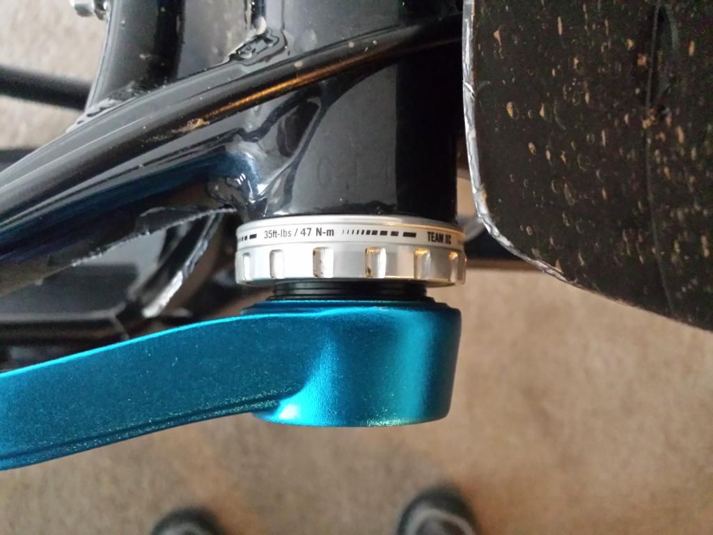

    What bottom bracket does the Farley 6 use? I've been searching and getting the wrong bikes or contradictory results.
    Thanks,
    John
    2014 Trek Fuel Ex 8
    2015 Trek Farley 6
    2016 Trek Stache 7
  24. #1824
    Sep 2014
    962
    Mine says Race Face X-type on the outer cups or whatever they're called. It looks like this one, except it doesn't say 'Team XC'. They don't list a 100 mm size either.
    Race Face
    It could be this one, but mine doesn't have a yellow background behind the lettering.
    Race Face
    This is the only other one on their website that has a 100 mm version
    Race Face
    Maybe Trek had them do a special run of BB's for the 6?
  25. #1825
    Sep 2014
    962
    I stand corrected; they do say 'Team XC'. I just didn't turn the bike upside down to check like it was for this pic.
    I wonder why they don't list a 100 mm version on the website.

    Thanks for that, I didn't realise it was just as simple as looking at it on the actual bike!
    I've found a 100mm one for sale:
    Race Face X-Type Team XC BB Cups | Chain Reaction Cycles
    The 24 hour event I did last month seems to have ruined the bottom bracket, it's been cleaned and serviced and it's functioning fine but there's knocking/squeaking coming from it. It's a bit pricier to replace than I expected but I think worth it so the bike runs smoothly.

    Glad to help. Good thing you found one but I still wonder why Race Face doesn't have a 100 MM version listed on their site. Weird.
    Forty clams doesn't sound too bad...I figured they'd be more!

    I'm not sure why it's not listed on the Raceface site but the bike shop had no problem finding the 100mm version to order either from their normal Raceface supplier.

    Just buy a set of x-type cups. The cups are the same regardless of spacing, the only difference is the sleeve which can be reused from the bb your replacing.
    Sent from my XT1565 using Tapatalk
    Was thinking this is possible. Thanks for the confirmation

    I replaced my BB with an XT on my 6. The turbine one my LBS had would have worked but i needed a $100 new style BB tool. I just reused the raceface pipe! All works well. Only issue is shimano makes the drive side longer and the other side short so i couldnt put 2 spacers on the non drive to center my chainline but its not really an issue for me, shifts fine. I only use my 42 t (1x10) for slow spinning, if i need to climb i 36 it and torque it
