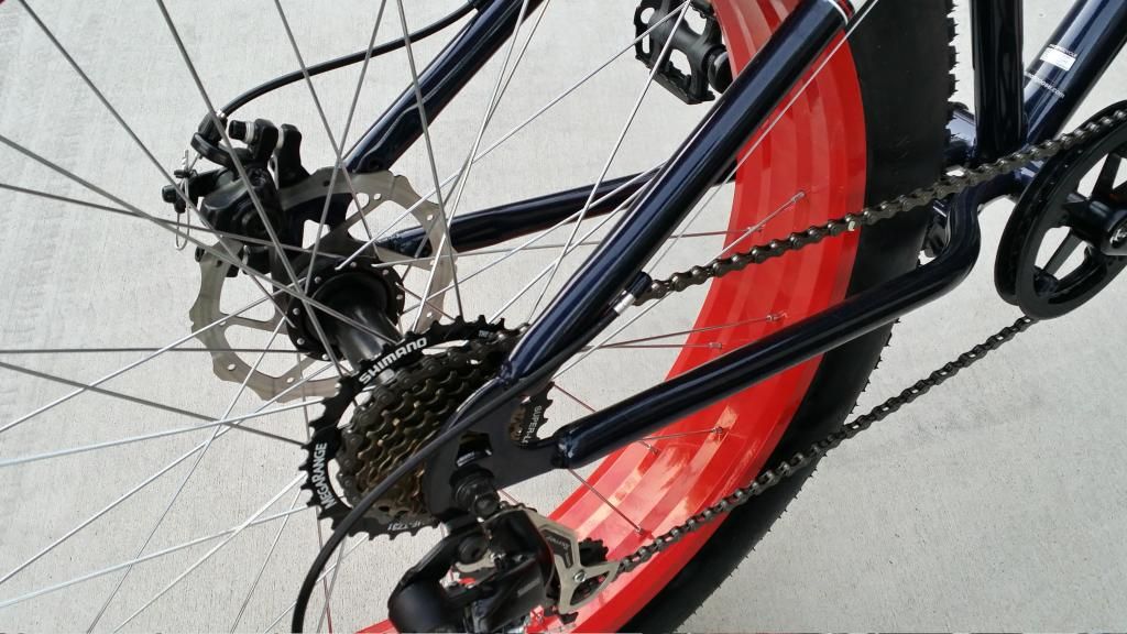

    I just had my LBS install a new megarange gear set on my Dolomite.
    The previous unit was solid when pedaling but “click/clunk” when applying some human torque. Also would wiggle on the bike when moving it around to duplicate the noise with your fingers.
    With the new mega range installed - it’s solid and no clunk and no more wiggles.
    However, when I pedal hard (still sitting down) I feel what is like a soft spot when I first apply torque. I still pedal foward and it “locks in” solid but it’s just that first initial lunge there is a soft spot. In terms of pedal rotation it’s around 1/4 of full revolution.
    Now I’m not sure if it’s really rock solid tight and I’m just putting down enough power to cause the rear wheel to spin out a bit before momentum overcomes power? But it seemed to do it on the even higher (or is it lower/harder) gears. Which is what leads me to think it’s more mechanical than me just being awesomely strong (which is NOT the case!)
    Otherwise, the bike rides great. My LBS service tech said he took it for a spin (to make sure it shifted smooth) and he didn’t mention anything about it.

    Interesting. Where would this most likely occur? The tire? I think I have 15 or 20psi out of a max 30psi
    I’ll see if I can try to replicate the issue by adjusting the brake to apply pressure and getting it on a stand to hand pedal it to see if I can get it to do the same thing.

    Quote Originally Posted by ImaBum View Post
    Thin frame members and structural parts. The dropouts on those bikes are usually pretty thin and the chain/seatstays/bottom bracket isn't really engineered to be stiff.
    Definitely not, that's pretty crazy-high pressure for a fat bike. It may make the problem more noticeable even. Most people don't go much above 15psi or so. I would take mine up to around 20 for roads, but that would be the extent of it.
    Unlikely, you won't be applying anywhere near the torque, still, you never know and it could give you an idea. Sometimes it's just something stupid like a loose cassette or dropout.

    sounds to me like a gap before the freewheel's engagement points

    Quote Originally Posted by NateHawk View Post
    Yup agree with this, as cog type freewheels tend to have this issue.
    Quote Originally Posted by mbax View Post
    Doesn't sound like something I can fix without replacement..

    The free hub on my FB4 started to slip...the freehub was a lot like this one....crappy vid from someone else but it will give you an idea....
    look at it...you never know....
    and also this...
    Freehub Body Disassembly/Assembly - YouTube

    he has a freewheel cog, not a free hub.
