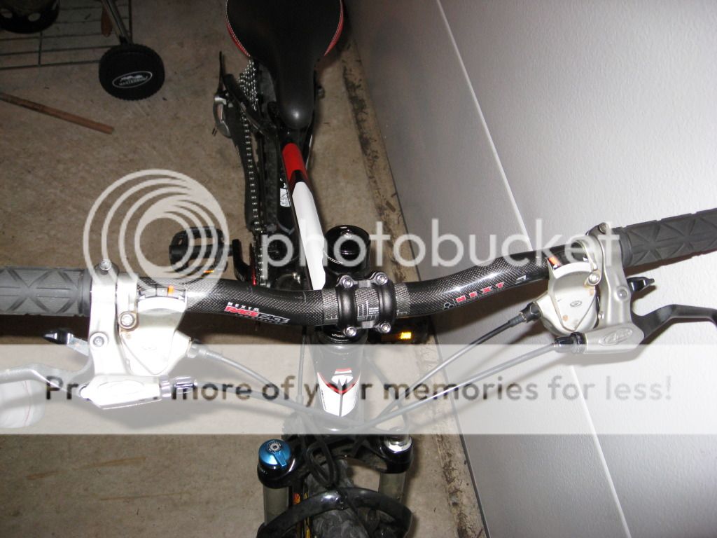

    Here is an update on my son's Marin Bayview Trail Disc
    So the upgrades so far are
    Spinner 24 inch Air fork with lock out
    RaceFace Next Sl carbon bars
    Complete 9 Speed XT drive train(except cranks)
    Shorten Iso Flow Cranks with Truvativ Rings
    Wheels, Novatec hubs laced to Velocity Aeroheat rims DT spokes and nipples
    BB7 brakes
    Tire are on the way, Schwalbe Rear Mow Joe 24x1.85 Front Rocket Ron 24x2.10
    Shopping for a seat post now, undecided about the seat
    Here are the weights:
    Stock Upgrade Change
    Fork 2040g 1729g -311g
    Bars 324g 165g -159g
    Front Wheel 1020g 940g -80g
    Rear Wheel with cassette 1600g 1500g -100g
    Seatpost 317g 150-200g -167-117g
    Tires 620g x2 F445g/R420g -375g
    Brake lever 76.7g
    Shifter 124g
    Shifter/Brake pod 168g x2 Total: 201g x2 +66
    FD 179g 154g -25g
    RD 310g 184g -126g
    Caliper 198g x2 163g x2 -70g
    Fork
    Seat 309g ? ?
    Sorry about the formatting, in the edit window it all looks lined up, when I post it I lost the tabs.
    If I take the seat post as 145g, then I've shaved off 1325g. Not as much as I hoped, but a lot of it was for the performance of the new parts over the stock one

    Wow, very nice build! So, basically only the frame and saddle are stock?
    7,356
    Quote Originally Posted by BeginnerCycling View Post
    Seat, seat post clamp, stem, skewers and head set.
    My son didn't like the Specialized colors or I would have saved some money and gotten the regular 21 speed HockRock and thrown these parts on it.
    Keep in mind, I started all this thinking I would build a XS26 inch frame with 24 inch wheels. So all these parts are from that build. It just ended up too big for him.
    Had I not started down that route, I doubt I would have gone as far as I did with this, especially the wheels.
    I will say the cranks are worth it. Most kids bikes come with cranks that are too long and the rings are horrible, making shifting hard for little hands.

    Right on dude! Your little dude is riding in style… without carrying granite slabs and cinderblocks everywhere he rides.
    Mar 2012
    87
    Can I ask what length cage dérailleur worked out best for you?
    And what led you to choose the spinner over the rst f!rst 24? Availability?
    7,356
    Quote Originally Posted by tubored View Post
    It's a long cage. For the Spinner it was availability. I'm not worried about have too many adjustments on a fork for a 10 year old. Just being able to vary the air pressure and have a much smoother fork is enough.

    Nice job on the build!
    Edit: I would cut the steerer. By the time your son gets big enough to top out, he'll be onto a 26". I used a flat bar and a 6 degree stem (inverted for -6) to get a better hands to saddle height for my son.
    7,356
    Quote Originally Posted by IAmHolland View Post
    Yea I just haven't gotten around to that yet. It's next on the list.
