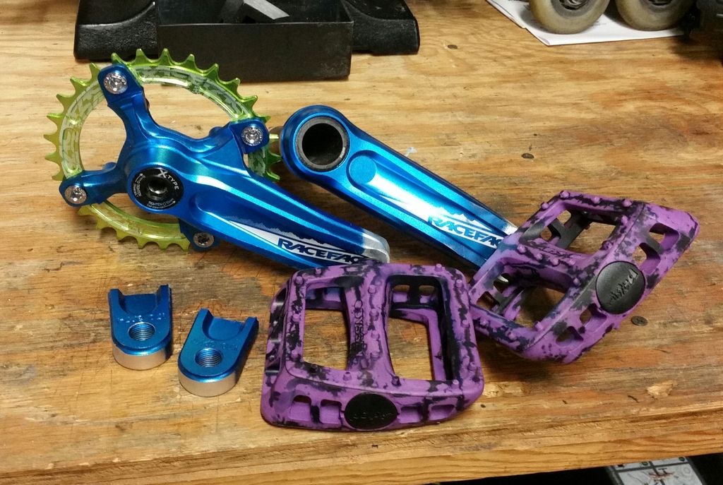

    Resurrecting an old thread here...
    I'm upgrading my son's Superlfy 20 that's getting handed down to my daughter. Frames currently with a friend for fresh paint. While he has it I was working on ordering to new parts. The bottom bracket is measuring 128.. to the ends of the taper, which seems ridiculous.
    What bottom bracket size did you all install? I'll probably go with some 120mm crank arms as well.
