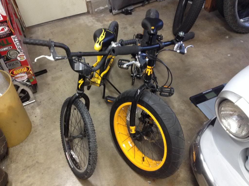

    My son is 6. He is about 46" tall and weighs about the same.
    He has 2 bikes right now. A Hotrock 20" coaster, and a Mongoose Massif Fatbike. He LOVES the fat bike, but its a bit too big for him, and it weighs 39.2 pounds! But with disc brakes and gears, it will take him pretty much anywhere I would want him riding at this point.
    The Hotrock is alot lighter at only 26.4 pounds, but its a single speed coaster with no front brake.
    He rides the Hotrock a lot better, it fits him better and is 15 pounds lighter.
    My thoughts are to setup the Hotrock to be trail worthy. I have a full set of XT V-brakes, an XT rear dealer, I can get some brake levers and a shifter, and will probably stick with the 1 piece crank. My question is the fork. If I am going to spend the $$$ to get a fork with brake studs, or a disc mount, would it make more sense to buy a suspension fork?

    I'm very familiar with lightening up he wheels. Here is a pic of the wheels on my fat bike.
    I plan on making the massif lighter, hopefully by about 10 pounds. But it's still a bit big, so I want to get the HotRock done. Or buy him a different bike if that makes more sense money wise.

    948
    Thats a good point on the rear spacing. I will need to measure that. I don't mind spreading the dropout an inch, as long as the cranks don't hit the frame. I spread my Fatbike from 170mm to 190mm. Steel bends pretty easily...
    If the frame can't be widened, I'm better off buying him another bike.

    Reputation: blown240's Avatar
    948
    Quote Originally Posted by Shayne View Post
    That Specialized is aluminum and won't bend easily. Especially with stays that short.
    Its a steel frame according to the magnet, but its for sure narrow. And there is only about a 1/2 inch between the chain stays and the crank arms. Maybe its time to look for an actual 20" mtb.
