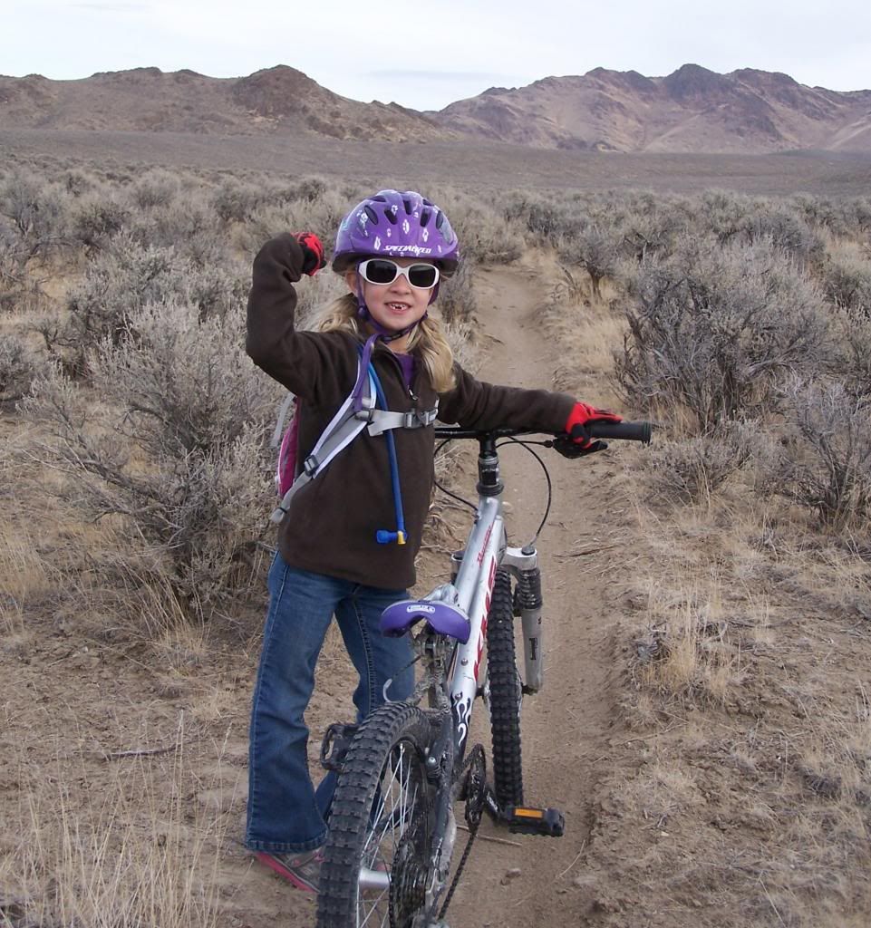

    Late this summer, I got my 6 year old daughter this mountain bike. I pretty much bought it sight unseen but had my Dad look at it for me. It needed a tune up badly but other than that, a solid bike. I could tell when she sat on it the first time that it needed major modifications, the cockpit was way too big and she was far too stretched out. I was a little worried that the TT was just too long but also knew that she wouldn't really be riding it until next year. This is what it looked like before I really started changing things...

    Your daughter reminds me of mine who also shares the same favorite color, purple, right? Bill
    50
    Hahaha! How could you tell? She loves pink too though. Anything girly, really. The bike won't stay looking like you see it in these pics, BTW. At some point this winter it will be painted. Her first choice was pink but since her younger brother will eventually inherit the bike, we can't do that. So I sat her down with gender neutral Crayons and we colored for a while. She picked a very nice bluish-green. She also picked yellow as the accent color, which is why the brake cables are now yellow. It's going to be very cool looking, imo.
